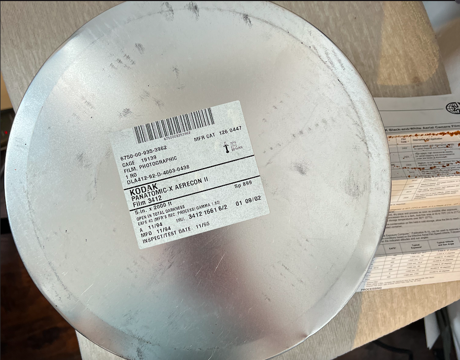

I have a giant ol' roll of 5 inch Panatomic X aerial film. Looks like it's got little sprockets in the side.
My plan was to:
  • Try 4x5 cuts for testing
  • slit down to 120/220 roll film -- obviously the sprockets could be annoying, may have to leave them.
Any other fun uses? Are there any old roll film formats that would fit a 5 inch wide roll?
I should add that it's a _very_ thin base. Thinner than 120.

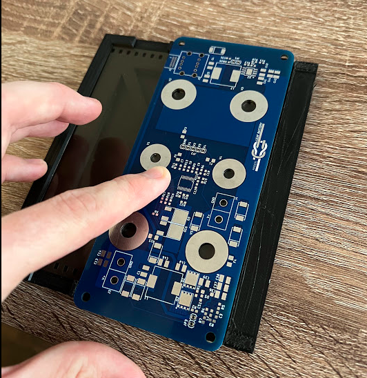

Also anyone experienced with slitting film? I have the requisite bolts, razor blades, and plexiglass. Not sure how well the plexiglass cutting will go. If not I may try wood. I have a ready-made 4x5 slicer courtesy of my friend so I'll be trying that first.

I'd be curious to see what that ready-made 4x5 slicer looks like. I have a huge roll of 5" microfilm I wouldn't mind cutting down one of these days.
I've built a couple of slitters for Minox/16mm before. I wouldn't recommend the way I did it though. You could have someone 3d print a slitter for you or do it yourself if you have a 3d printer. I line my slitters with Ilford 120 backing paper which is super smooth. Keeps the scratches away.

It's a 3D printed job which he sized for a random PCB he had laying around (lol electrical engineers). Basically the film fits neatly in the slot and you run a razor blade adjacent to the PCB. With X-ray film he says he has to do two passes but with the absurdly thin aerial film base it looks like I'll be able to do a one pass method. The hard part is this reel is absolutely massive.
Yeah now that you mention it the "stacking plexiglass" method seems like a generally inane way to go given 3D printers... long as they have holes you can make different ones to bolt together for different sized film.

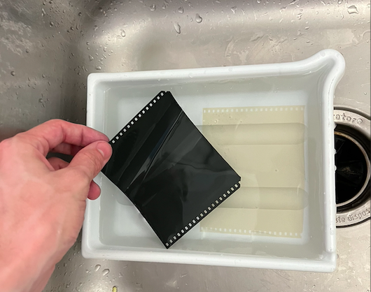

Wow this film is amazing. How does it have no base fog after 26 years???

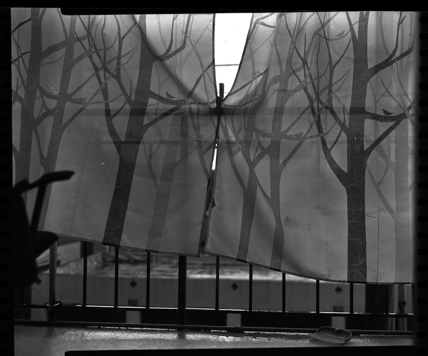

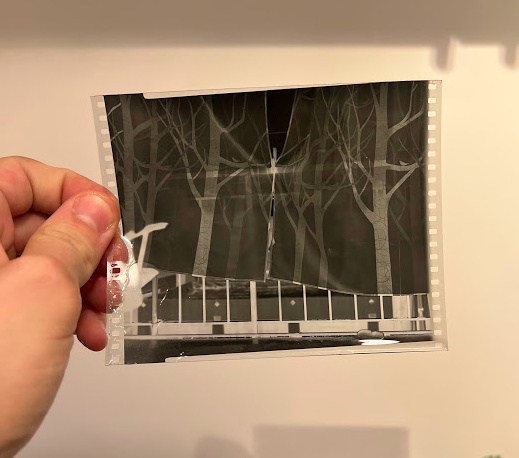

Wow I see what people mean about Panatomic X lol. Looks like this roll should last me until the end of time.

Isn't the Aerecon variant on Panatomic X a totally different film that the "classic" version sold as 35mm and 120?
Although Kodak's aerial films may share names with their standard camera films, they are not the same emulsions. The aerial films were designed for higher contrast (and greater resolving power) than the standard films.
That doesn't mean that the aerial films are not usable by ground-level photographers, they are; BUT careful testing will be required to get the best from them.
Maybe I should grab some expired 120 to compare. It definitely has some punch to it by cursory glance but perhaps some developer twiddling might be in order.
The spectral sensitivity might also differ.

Panatomic-X Aerecon II Film was made for aerial photography. "Panatomic" is a brand name, the emulsion has no relationship to Panatomic-X FX/ 5040/6040/ in 135, 120 or sheet film.
This roll was made for a military aerial application. Probably fixed wing. Satellite films were never perforated.
Support is 2.5 mil Estar compared to 120-size that is 3.2 mil acetate
Design speed is around 32
Spectral sensitivity is pan with extended red to may be 680nm. Little sensitivity at 700nm.
The design gamma is 1.3 to 2.2 while pictorial films are designed for lower contrast .41-.56
If you want to attempt pictorial photography try HC-110 1:63 . Scanning might yield results that with Photoshop adjustment will make usable. Printing the negatives on AgX paper will probably be too contrasty for full range quality. If you print for the highlights you will lose shadow detail.
Fog should be low. It is not very sensitive to cosmic radiation.
