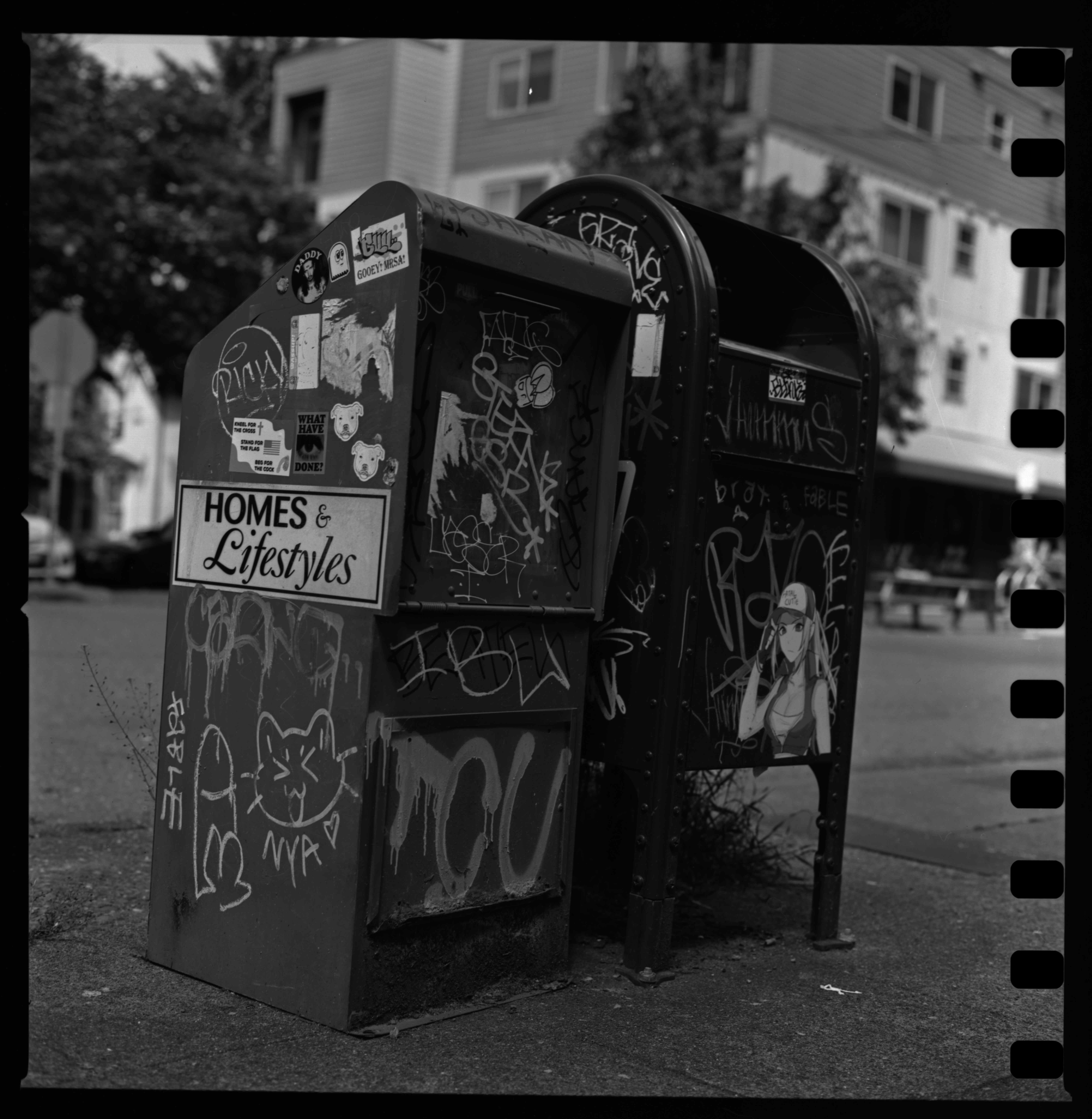

Thanks Bob! That sounds consistent with what I saw on the negatives (has plenty of punch with a relatively short tray development in Rodinal). I’ll try some developer shenanigans to tame the contrast. Or buy a U2 spy plane 😂

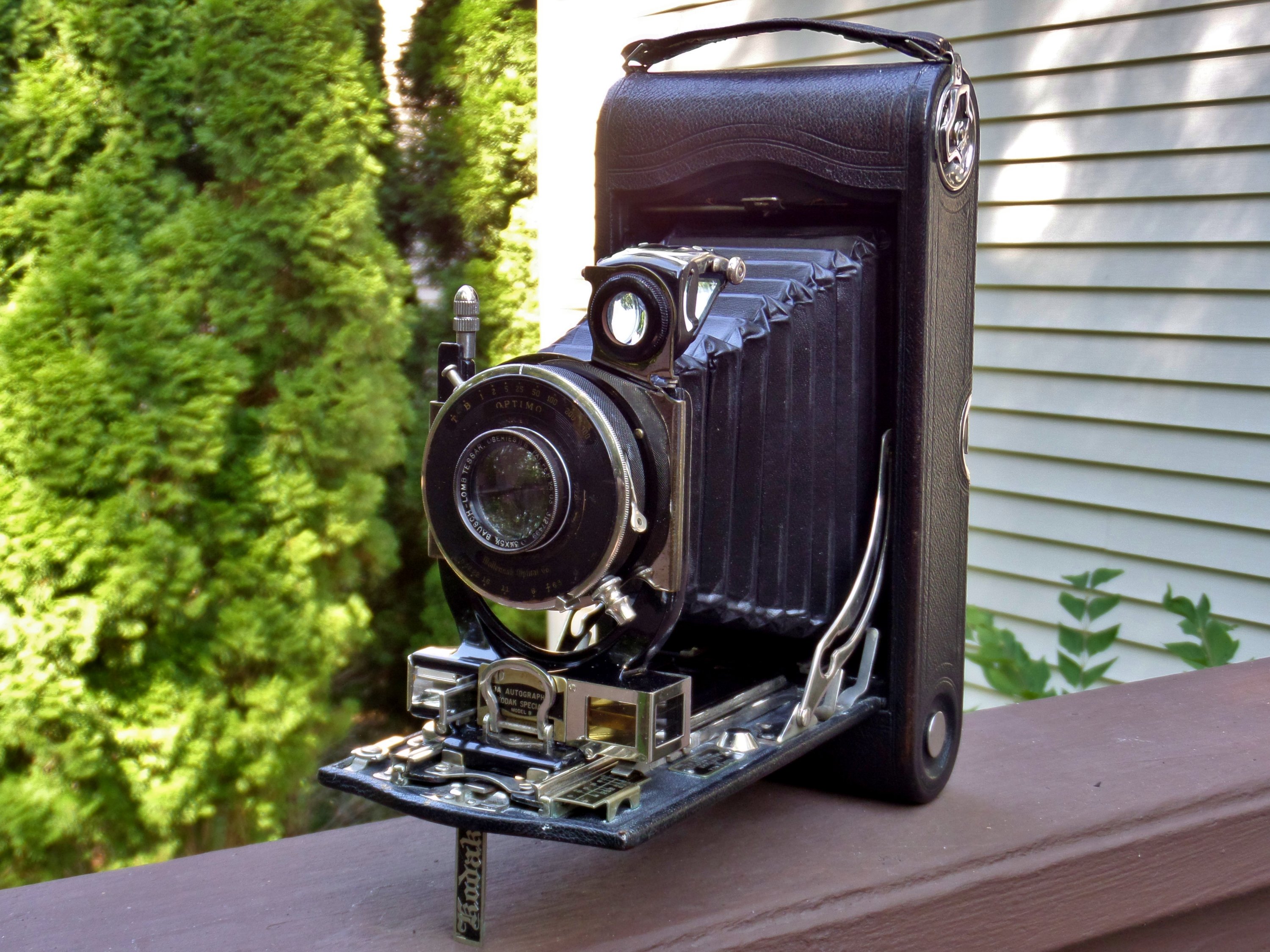

If you do end up deciding to sell some lengths of this, I'd love to have some. I have a 3A Autographic Kodak Special with rangefinder which uses 122 (3.5 inch wide) film which it would be nice to have some new(-ish) film for.
I also have a No.2 Bulls Eye Kodak which uses 101 rollfilm which is 3.75 inches wide and a No.4 Cartridge Kodak which uses 104 rollfilm which is 5 inches wide, although finding suitable backing paper for those two could be challenging.

DM me if you want some. Need to find some suitable packaging.
I did grab some 122 spools and backing paper. I was wondering about the 104 rolls — could probably load it in the dark without backing paper.
