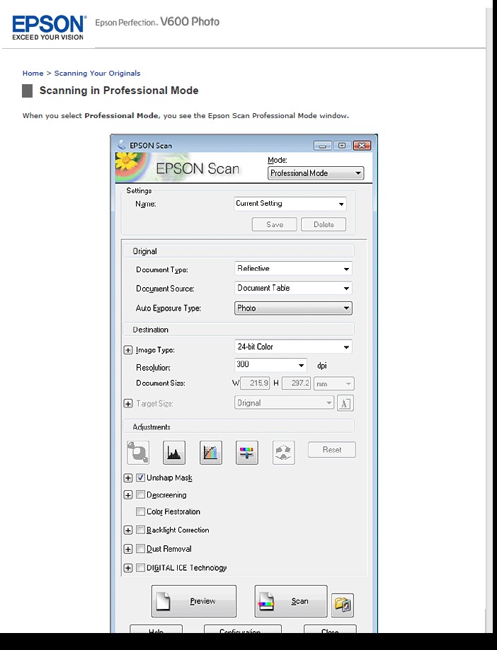

Are you running the latest version of Epsonscan? There should be a check mark. See photo of page from the Epson manual. You can get software and manuals and drivers from Epson site.
That ICE box will disappear if the software thinks that you are scanning Kodachrome.
