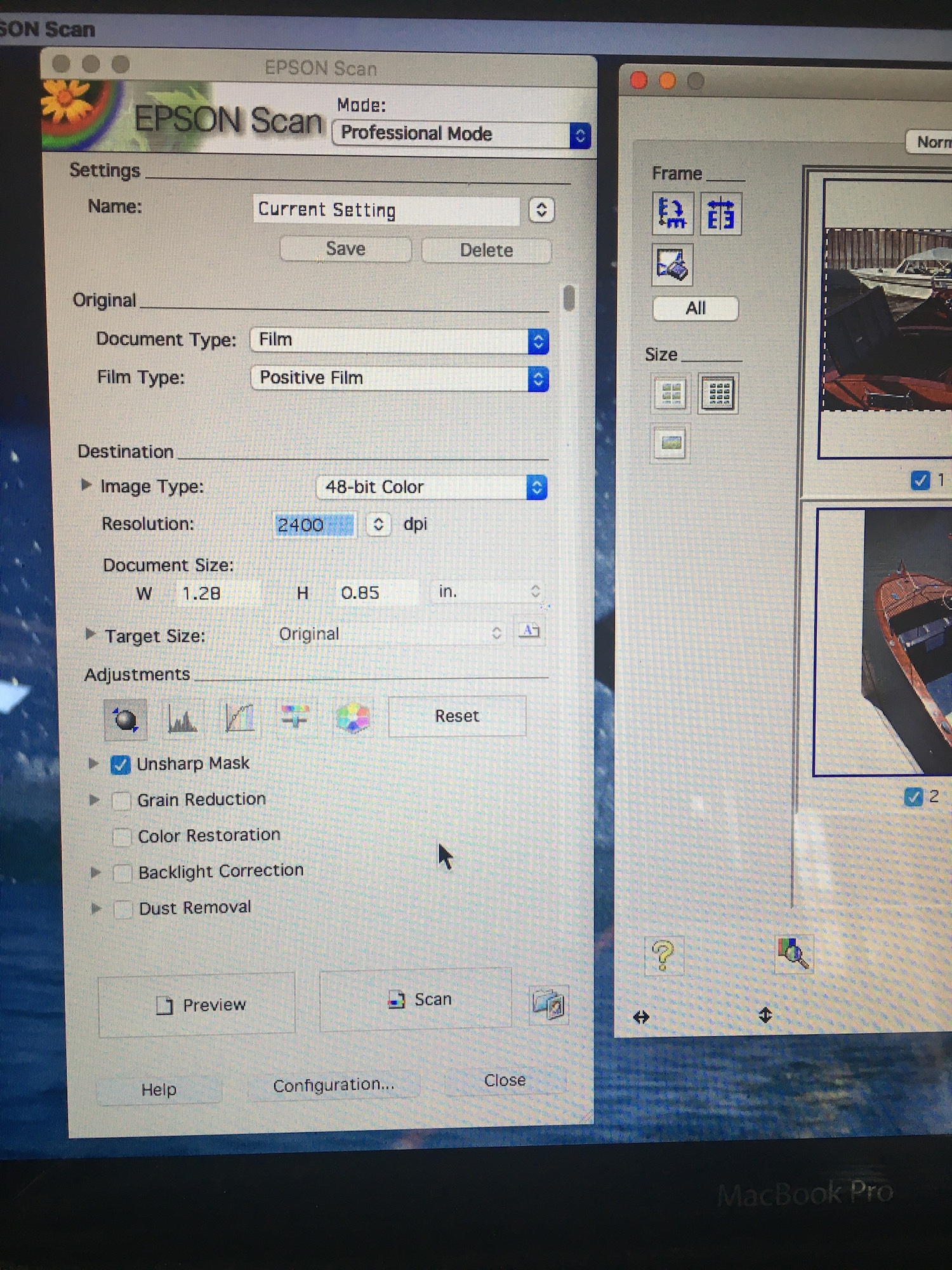

Les, In my previous post there is a link to an album of Kodachrome slides all done with default settings. After your question today I tried to scan some more with the ICE feature, but I could not figure out how to activate that feature. I read the help instructions that suggest there should be a click box near the bottom of the screen....but no box there. See photo of my screen attached. Sorry I could not be of help with ICE. fullsizeoutput_4120.jpeg
Click the box next to Dust Removal.
I'm guessing that Epson Scan includes its own version of a dust removal tool, rather than ICE, which is proprietry.
Matt, the instructions imply both: dust removal (simple enhancement) and ICE, and more elaborate function for dust, scratches etc. However, when you get down to trying to use ICE, it is not there on the screen, very puzzling. I am very unimpressed with Epson's software. This is not the only issue I have had.

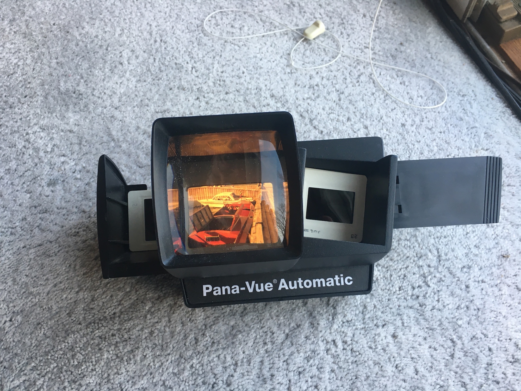

There are two accessories that can speed up slide viewing.
1) A Kodak stack loader which allows loading up to 36 slides in bulk (in a stack) into any Kodak projector avoiding the time consuming loading and unloading of carousels. Great accessory.
2) A Pan-Vue slide viewer which allows viewing up to 36 slides in bulk on a portable viewer. These are available on eBay for very little cost. See photo.fullsizeoutput_4124.jpeg

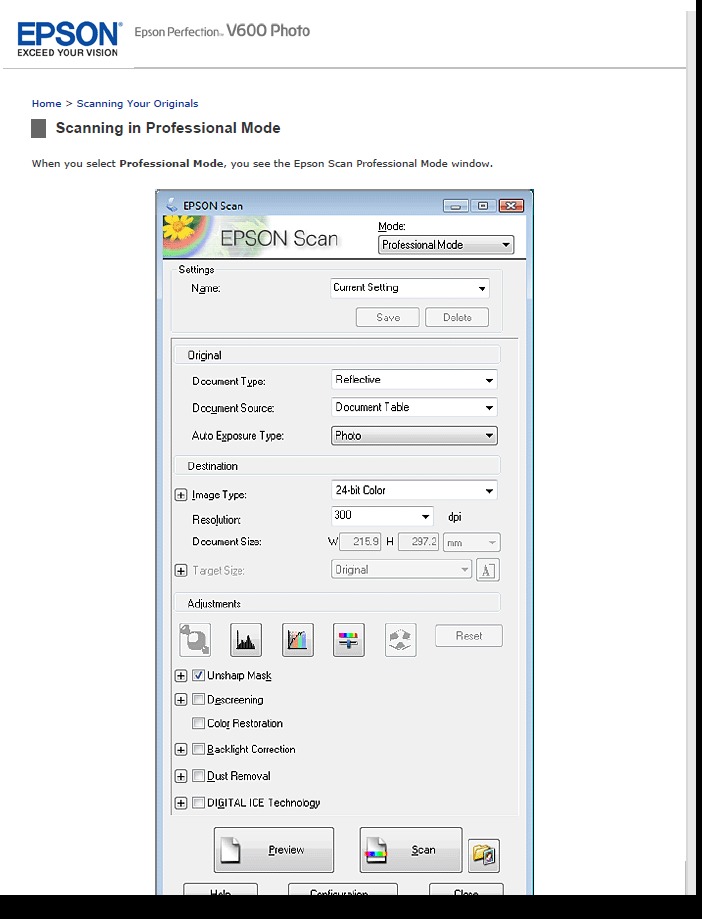

Are you running the latest version of Epsonscan? There should be a check mark. See photo of page from the Epson manual. You can get software and manuals and drivers from Epson site.
