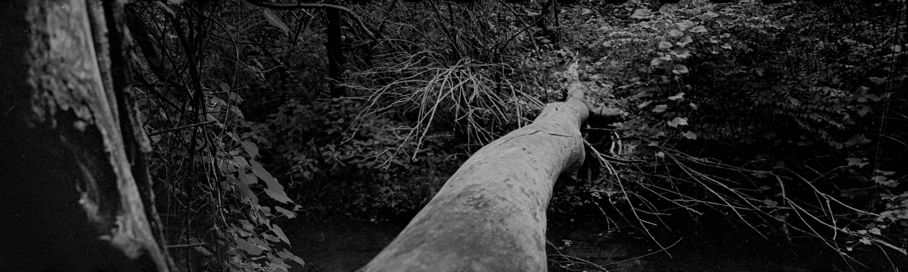

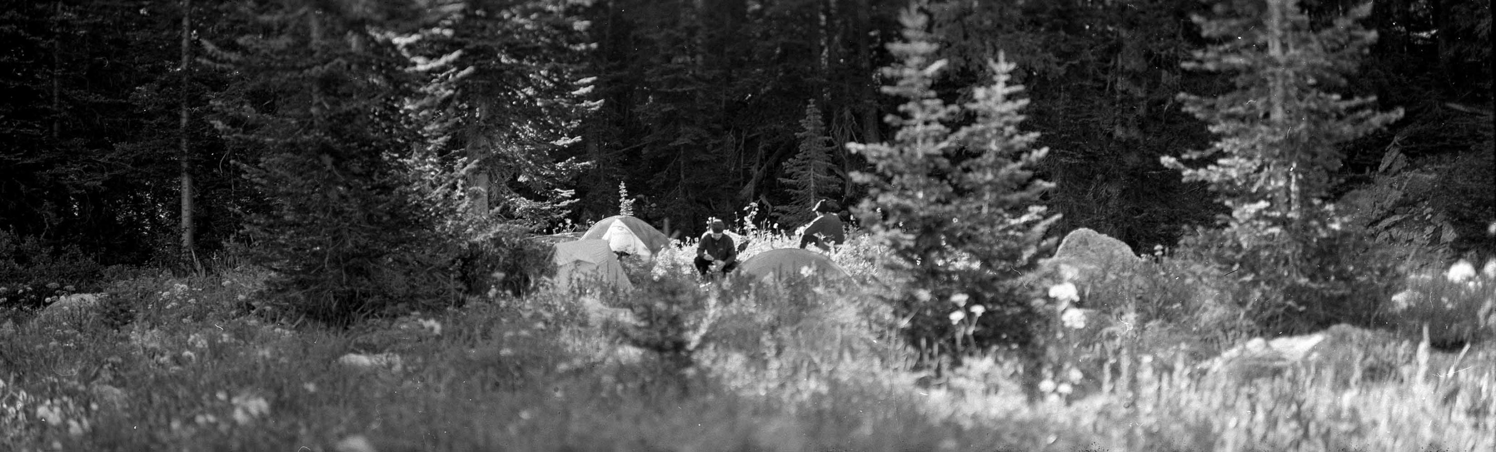

Has anybody else tried putting 35mm in their Fuji 6x9's to use as a pano camera? I was really happy with the ease of the process and the results. The only trick is (which is also the fun/challenge) is finding compositions that don't just look like oddly cropped pictures. I think the 90mm lens also contributed to this, I found myself seeing a composition, then looking through the rangefinder and stepping back another 20 feet then shooting. I pulled the trigger on a GSW690 65mm to convert that to my full time pano camera. A lot cheaper than a 6x17 back for my 4x5, though I'd love to have one, I like the super long compositions this method gives you.
Well, just thought I'd share and see if anyone else has gotten good results...the link attached is where I found some helpful troubleshooting for doing this hack if anybody is interested.
