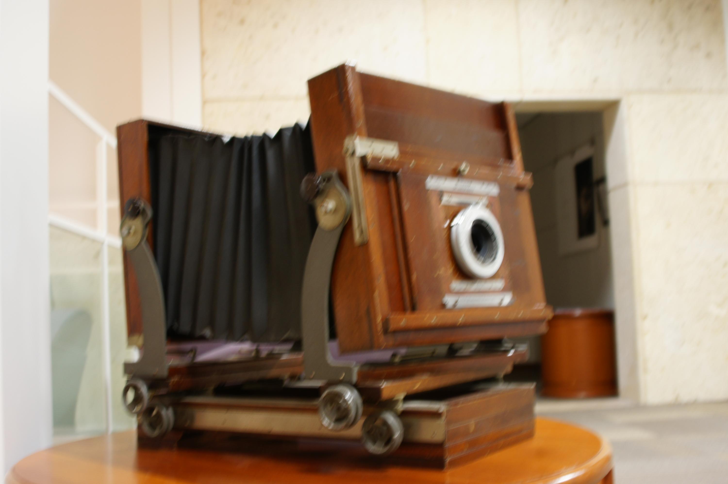

Mopar_guy is correct. Do it right and bring a Deardorff V8 with a Ries tripod! :smile:
So, I made a deal with my Sweetie. I told her she could take that extra suitcase full of shoes if she would carry my camera.:devil:
