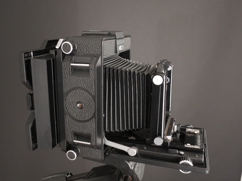

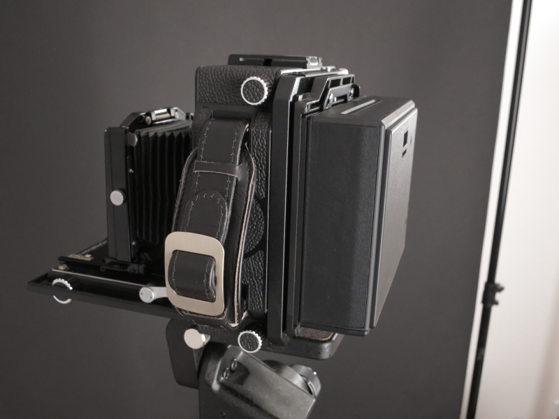

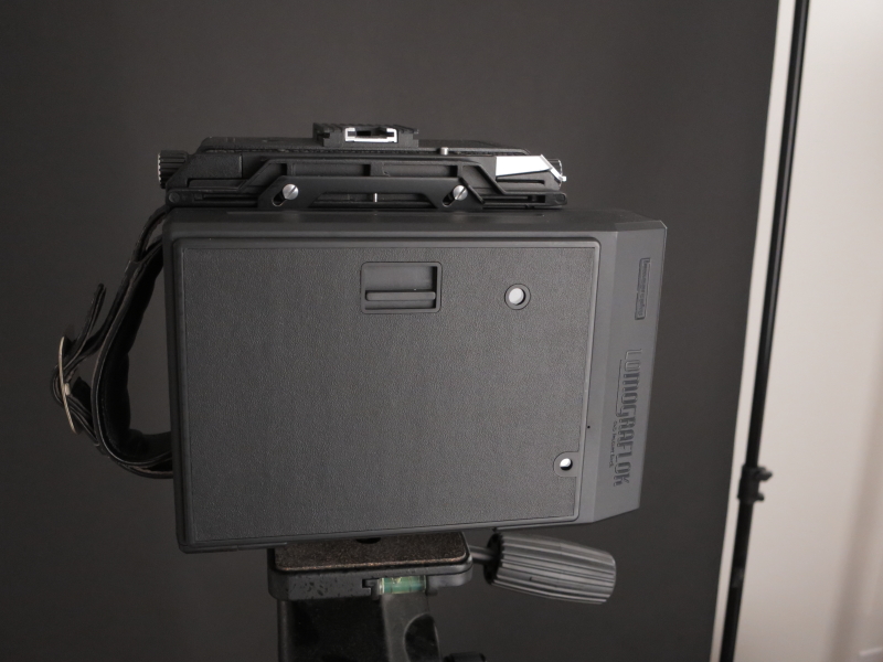

A few quick-and-dirty snapshots of the thing mounted on a Horseman 45FA.
The bottom switch that shows as red in the second picture is a darkslide lock.
Classic Lomography, which is to say made of cheap plastic but decently finished. The image area is shifted downward a fair bit and slightly to one side relative to the center of a 4x5 sheet; the focus insert takes account of this.
There's a tripod socket in the bottom of the back, though in most situations I expect it will make more sense to use the camera's socket.
Takes AA batteries, not included. Without batteries, reads about 19 oz on my old mechanical postage scale.
Minor annoyance: the box doesn't include an instruction manual, only a QR code to scan to take you to the manual online - there's an excuse about being environmentally friendly - but it does include a little promotional folder. In fairness, it's a pretty simple device, and if you've used any Instax camera before it's easy to figure out. Probably even if you haven't.
And here's one with the focus insert.
The insert is made of a lightweight plastic. I wonder whether it might start to wear down, compromising the focal plane spacing, if one were to use it heavily, particularly in a metal camera back with a tight grip - but then it's hard to say how robust the ejection mechanism will be and how many cycles that's engineered for. And the spacing of film sheets within the film pack isn't high-precision either.
We'll see how the back holds up in use, but on first impressions I'd say the construction is reasonable given the low price.
Since the front standard won't go down any farther, one could center the lens to the film this way.
Or could one flip the back around the other way and use front rise?
