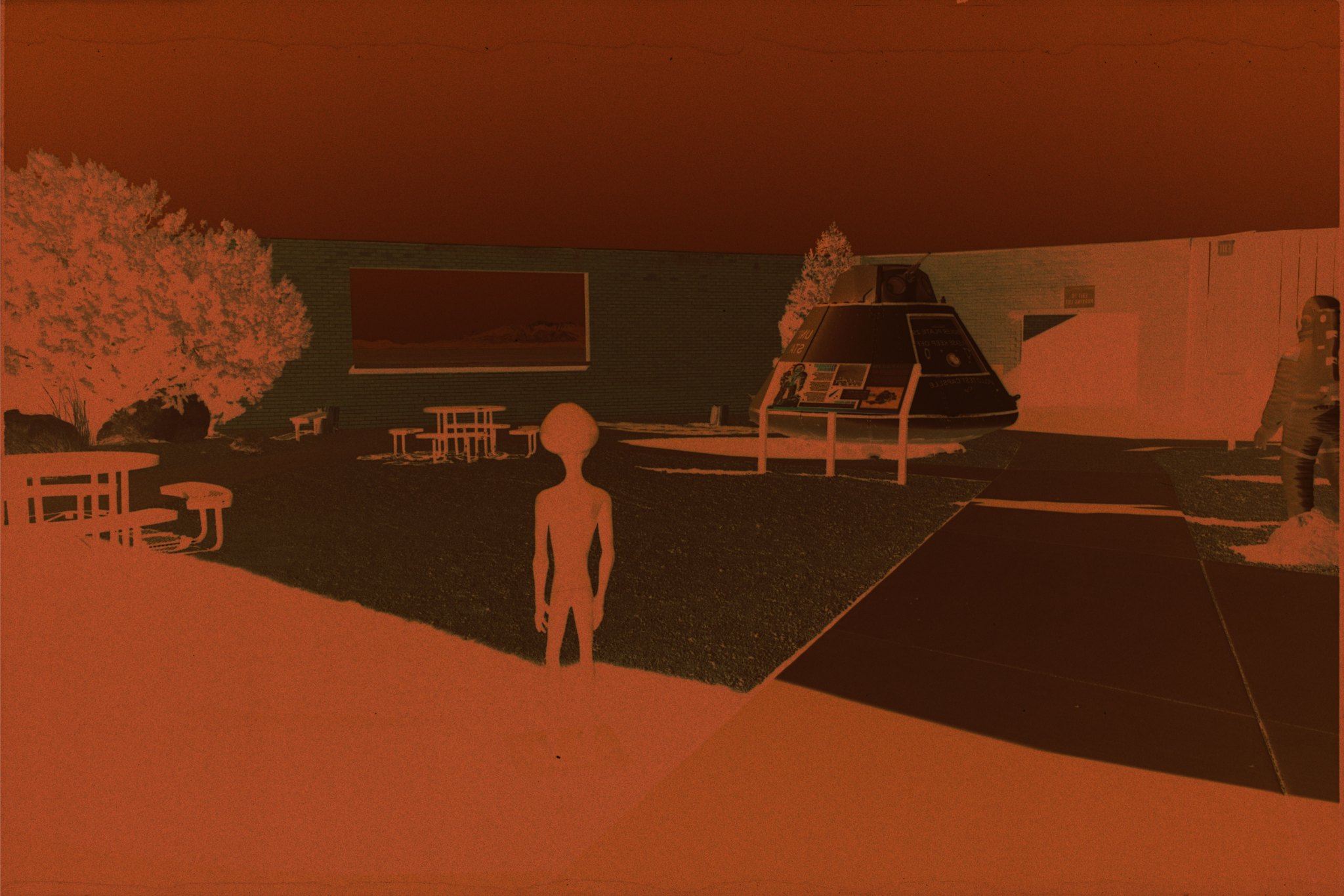

I followed the instructions. Used a paterson tank. left the bleach and the fixer a little longer.
Washed 5,10,20,30 inversions after bleach , and after fix.
I get redish cast on all pictures. It is not my scanning because my lab devs scan great.
I am prewashing in 100F and development is 3:15 in 100f.
I poor the bleach almost right away.
Also on both films I get streaks on top and bottom.
What am i doing wrong?

What colours should the wall, tree and what looks like a reddish/orange carpet look like? Were the pinkish slabs a neutral white- grey colour Unfortunately this scene in its correct colours looks to be an unnatural scene of few colours
It might help if you were to show us scans of other negatives as well that have a bigger range of colours.
Your process appears to be done correctly so it leaves me wondering if somehow the problem is with your scanner
However I do not know enough about scanning to even begin to say what the scanning problem might be
Have you tried asking someone else to scan this negative or asking your lab to do so. What it might say might be useful

Can you explain how you scanned and how you produced the positive image, please?
It would also be handy if you let us know the brand and type of film used, (eg: Fuji C200) and if it was fresh or not.
Also if you could show the negative with the edge markings please.

Portra 400 Scanned with PI Primefilm XAS as Raw image and also with negafix portra 400. My lab scans in the same setting look fine.
The film was shot in October 2021

At first glance I'd say you have a problem with silver retention, which would mean your bleach didn't do its job properly.
Please share a bit more about the chemicals and your processing. Specifically what do you mean by:
I don't know what that means...
Btw, note that bleach keeps very well; essentially indefinitely. Fixer does deteriorate; if the fixer concentrate has thrown down a white/yellowish precipitate in its container, it's bad. It should be crystal clear.
Good job on posting a picture of the negative, but please also post a photograph of the negative strip on e.g. a light table or against any other diffuse light source, preferably side by side with a known-good lab-developed strip of C41 film.

1 year old Fuji hunt just opened and mixed 1L containers
I bleached for 8 minutes and fixed for 8 minutes after my first bad roll. I was told red cast means bleach is not working good so I tried to bleach and fix a little extra.
Will post pictures of negs later

A quick and simple way to see if a negative has retained silver, not bleached enough, is to hold the neg, emulsion side up. Then tile it back and forth and from side to side and see if the viewed image appears to change from negative to a dull positive.

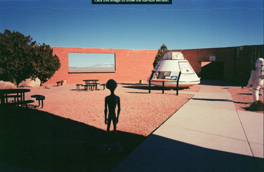

I can print color negatives fine. I think the scan needs to be adjusted, scanning color negatives can be a pain.

If that was an actual print, I would hazard a guess and say it is too red. Again if I was printing I would dial filtration so that reduced the red but would not affect the sky. So try doing the same with the scanned image.

I have had an attempt to correct the colour but it is not perfect and the shadows are quite under exposed. To do this in PS I removed 56 units of Cyan and added 29 units
of green

I have had an attempt to correct the colour but it is not perfect and the shadows are quite under exposed. To do this in PS I removed 56 units of Cyan and added 29 units View attachment 299527 of green
Yep this is what needs to be done. This is a terrible shot to try and balance. Ideally studio flash, a model holding a gray card and a color checker. Work the method described in a Kodak color darkroom dataguide.
Slides are easier to scan, from a color standpoint, unless the lighting is weird, like this shot.
Looks pretty good now.

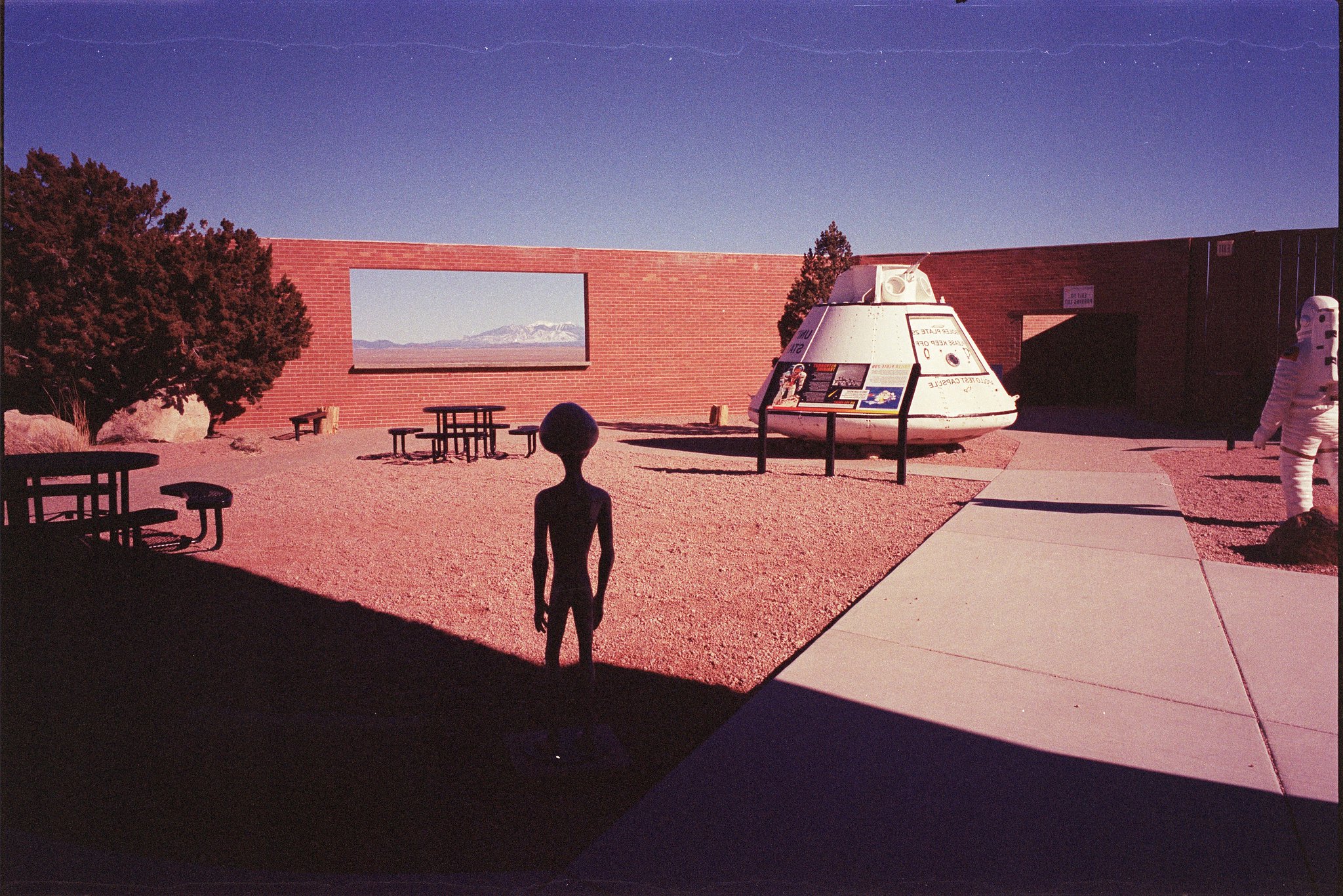

After a nights sleep I have had another go with fresh eyes and made a few more changes.
1. I selected the deep shadow on the bottom right and desaturated the green cast (under exposed.
2. Removed now visible shadows of artifacts that appeared.
3. Added 11 units of red from the colour balance palette
4. Selected the tree then removed as much red as I could and tried to replace it with green (not very successful)
5 took out the drying mark in the sky
