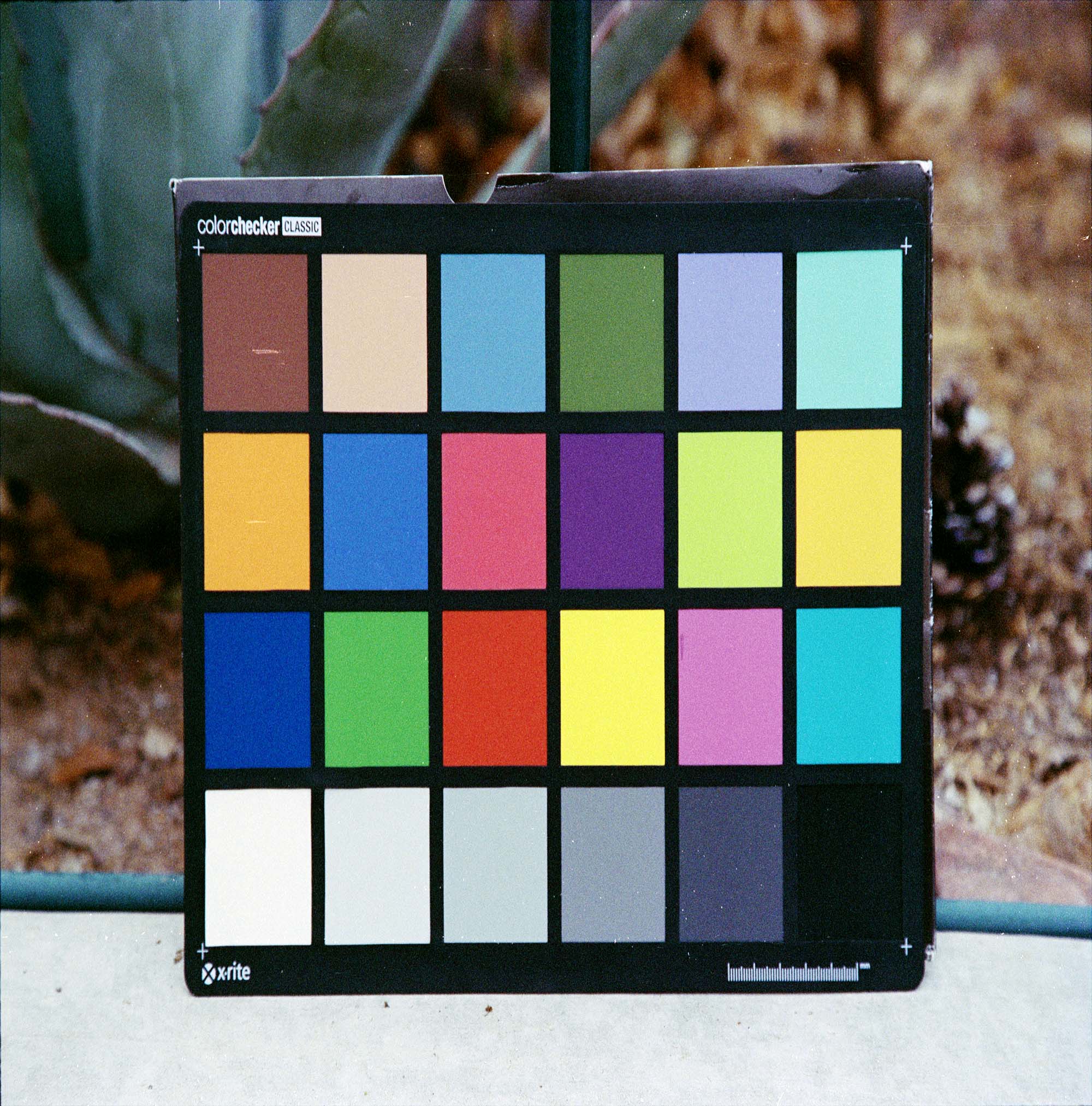

This chart is from my second development 101.5F pre wash and development

Hmm, before troubleshooting any color development issues (real or imagined) I'd recommend getting a crash course in digital color correction and doing lots of practice. It seems to me you're a bit disoriented in these matters.

The color checker scan you posted does not exhibit purply shadows or a red cast.
I've tried to help you in a few ways, but apparently I can't. So that others might have a go at this, if they have the time and patience: what would you ideally get from this thread?
the color checker scan is from my second development that I mixed new Chems and increased temp to 101f. It looks better than the first one.
