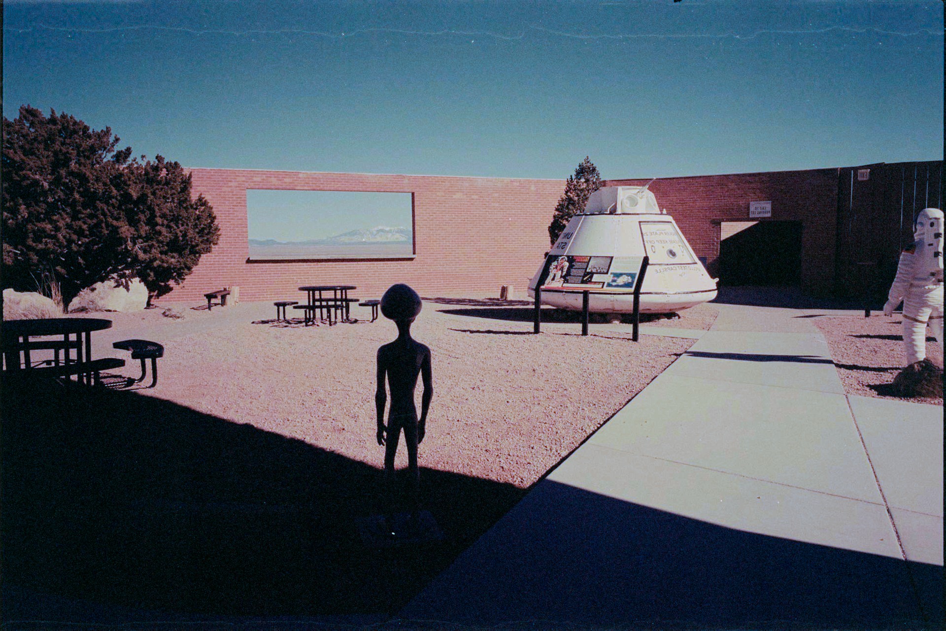

After a nights sleep I have had another go with fresh eyes and made a few more changes.
1. I selected the deep shadow on the bottom right and desaturated the green cast (under exposed.
2. Removed now visible shadows of artifacts that appeared.
3. Added 11 units of red from the colour balance palette
4. Selected the tree then removed as much red as I could and tried to replace it with green (not very successful)
5 took out the drying mark in the sky
Another thing just like actual old school optical prints from negatives. Make inkjet prints and view with a Kodak color print viewing filter set. Or even make ring around prints. Scanning film is an art/science. Your point about fresh eyes is an excellent one. Some negatives, like this one can be a pain.

They're pretty much completely empty, so exposure is one part of your problem. The question is if there is also a problem with the processing. A side by side comparison with a good negative is usually a good indication of big issues.
I get the feeling that the exposure range is way out of the films capabilities so the photographer was on a hiding for nothing. Over expose by even one stop can only make matters worse. But with the massive colour shift in the parts that were exposed more accurately the original problem has to be the film developer.

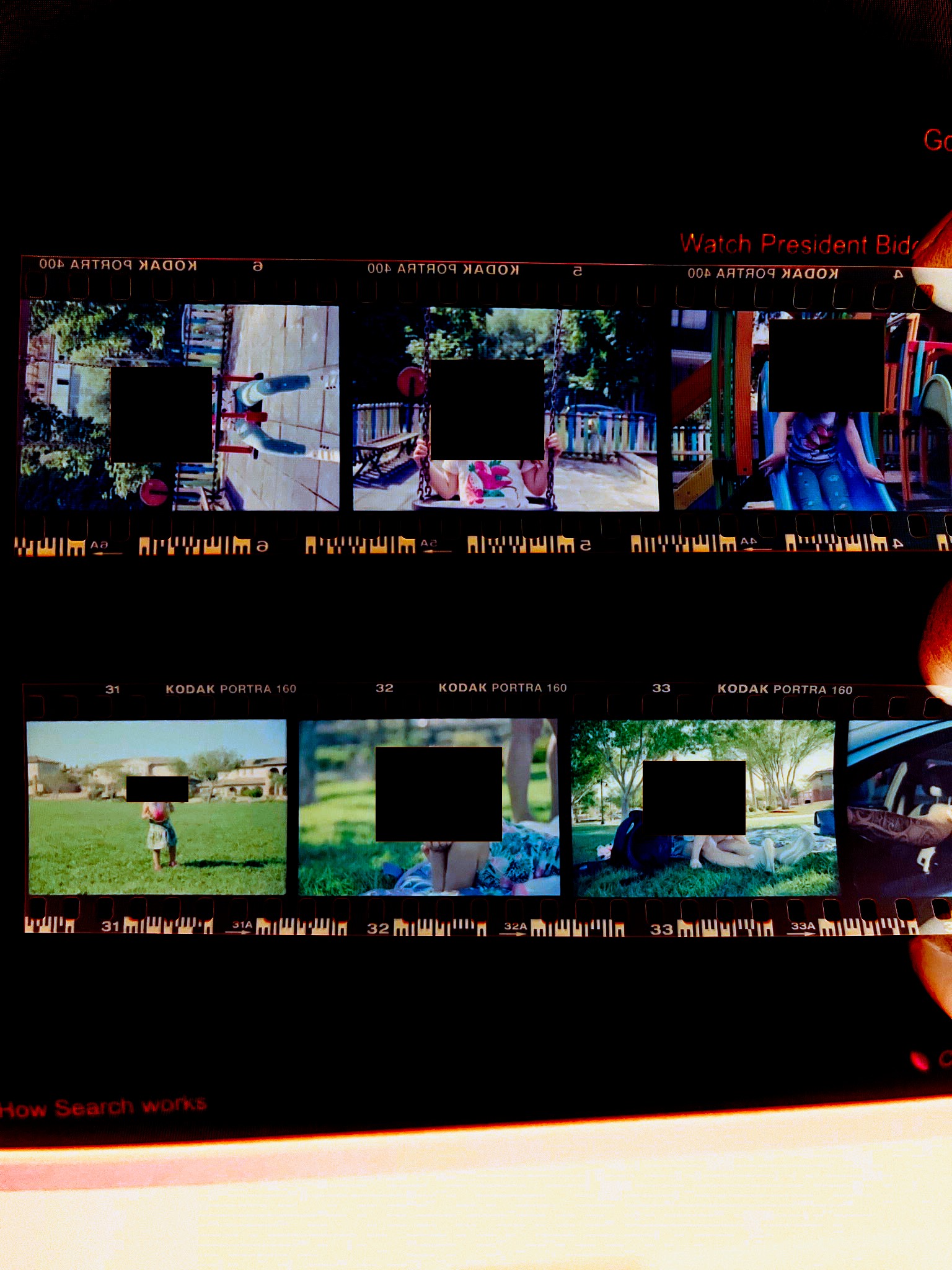

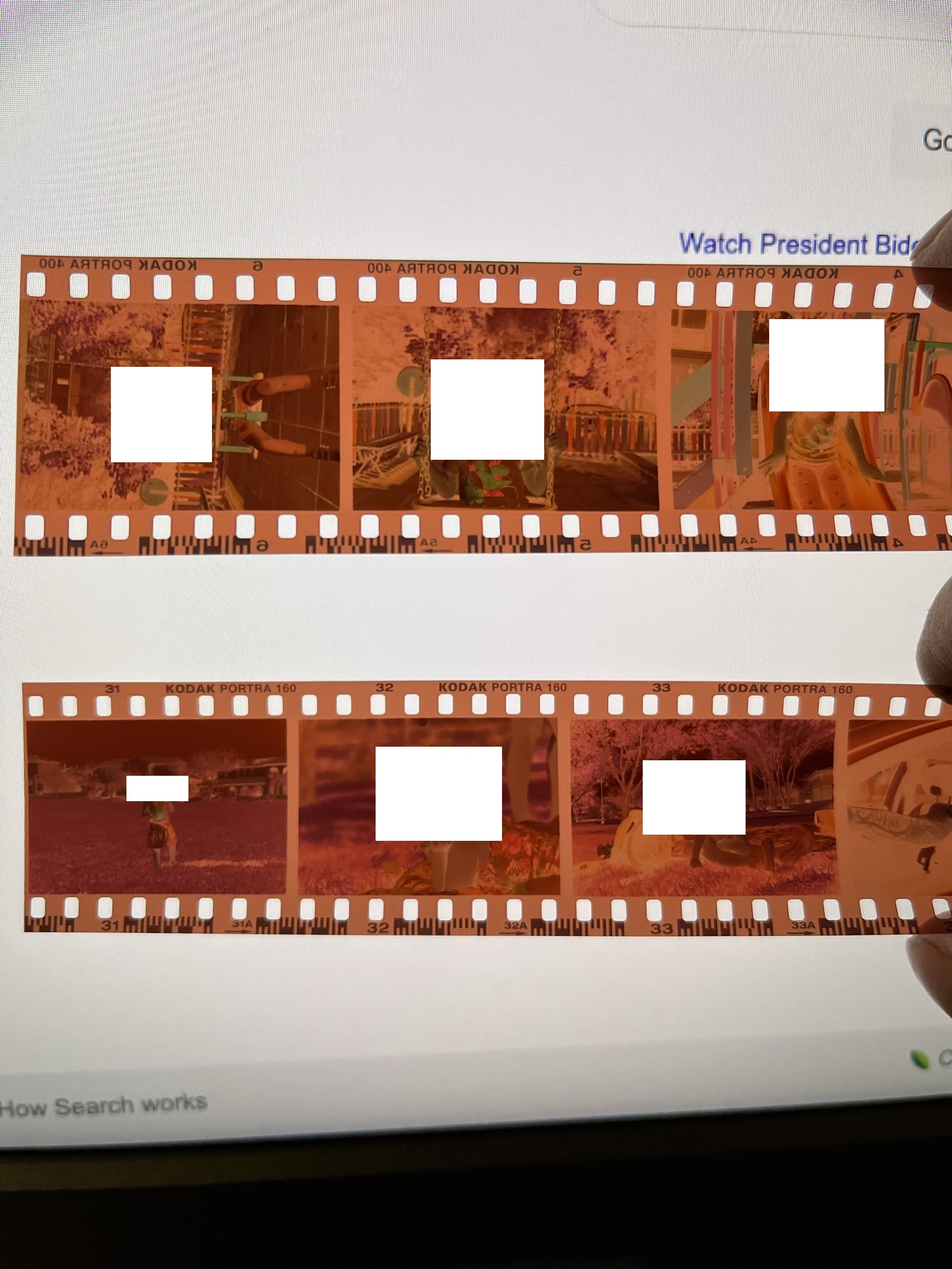

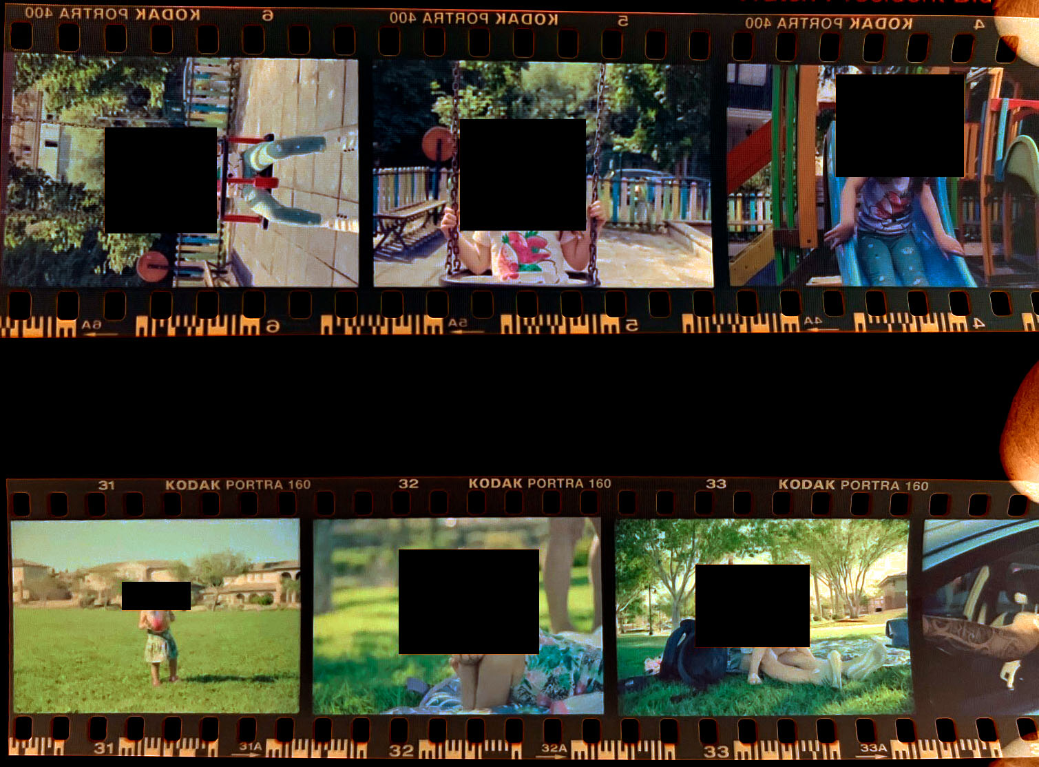

lab vs mine
MattKing
Apr 24, 2005
53,358
Delta, BC Canada
Looks like a typical difference between Portra 160 and Portra 400 :smile:.

Honestly, they're small, and obfuscated for obvious reasons, but all of the negatives in #29 converted over fairly well under Darktable / Negadoctor. The Portra 400 images are a bit darker, but still easily corrected.
Using the same base color for negadoctor, and selecting appropriate highlight / shadow regions, the original post comes out as:
Note-- I did zero other corrections on both images-- just inversion.

The portra 400 images - my development have a redish cast.
koraks
Nov 29, 2018
23,681
Europe
I don't see very apparent excess cyan dye in your portra400 negatives.
This is the problem with hybrid workflows; you're often not quite sure where the problem is. In this case it seems to be primarily a scanning/post processing problem.

brbo
Dec 28, 2011
2,163
EU
I also inverted the shot of both strips and found out the same as user grat, there is not a big difference between lab developed Portra 160 and home developed Portra 400. Well within what you can expect from two different emulsions.

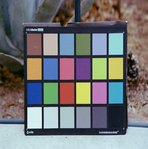

The image shows a single shot of a color checker, so it doesn't allow for the kind of comparison I suggested.
Having played with it very briefly in Gimp I get what appears to be a fairly decent color checker with no very big problems. A bit of magenta/green crossover if you look at the greyscale, but nothing that looks like a gross red cast or anything. Here's what 2 minutes of Gimp gives me:
