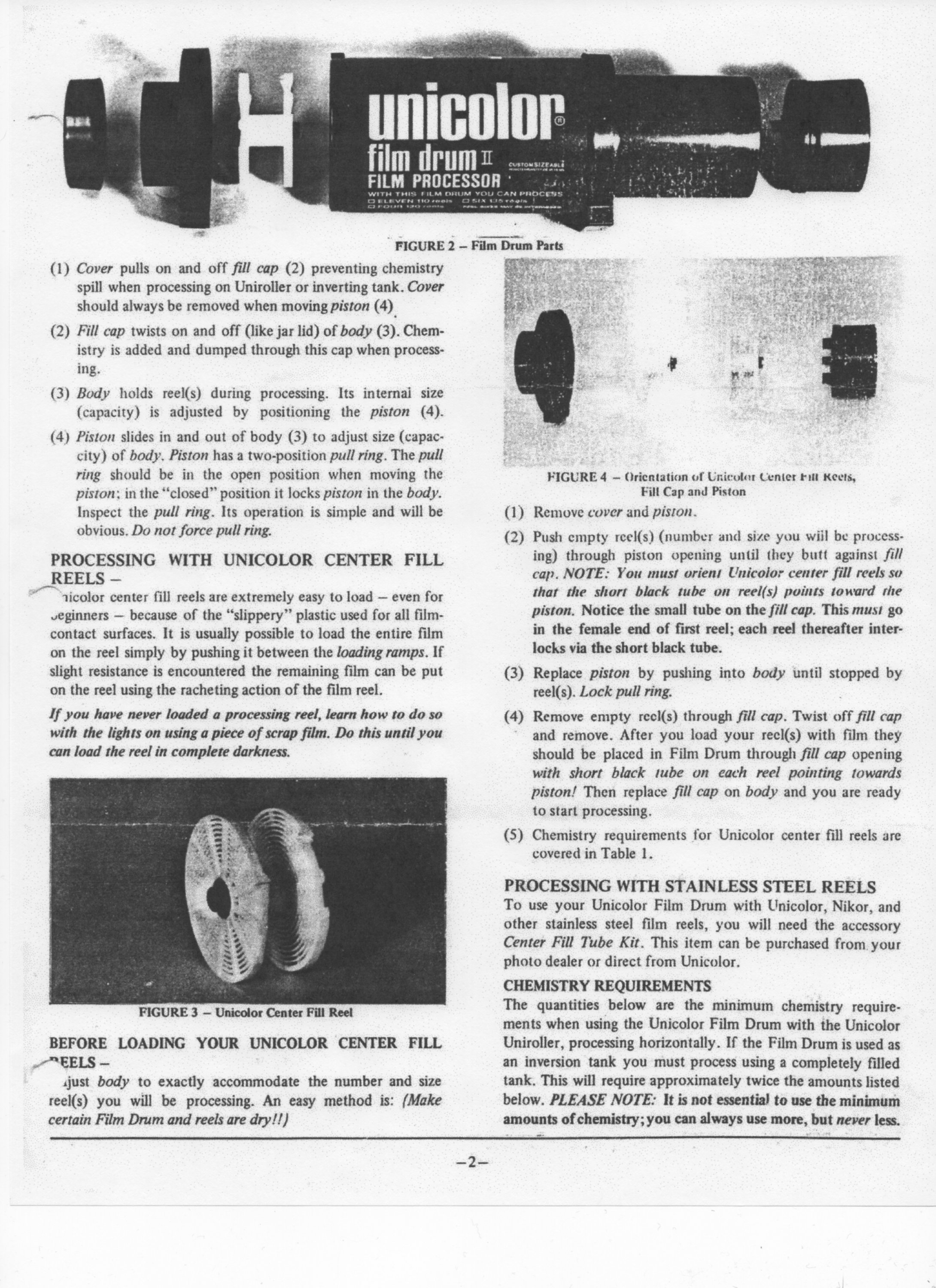

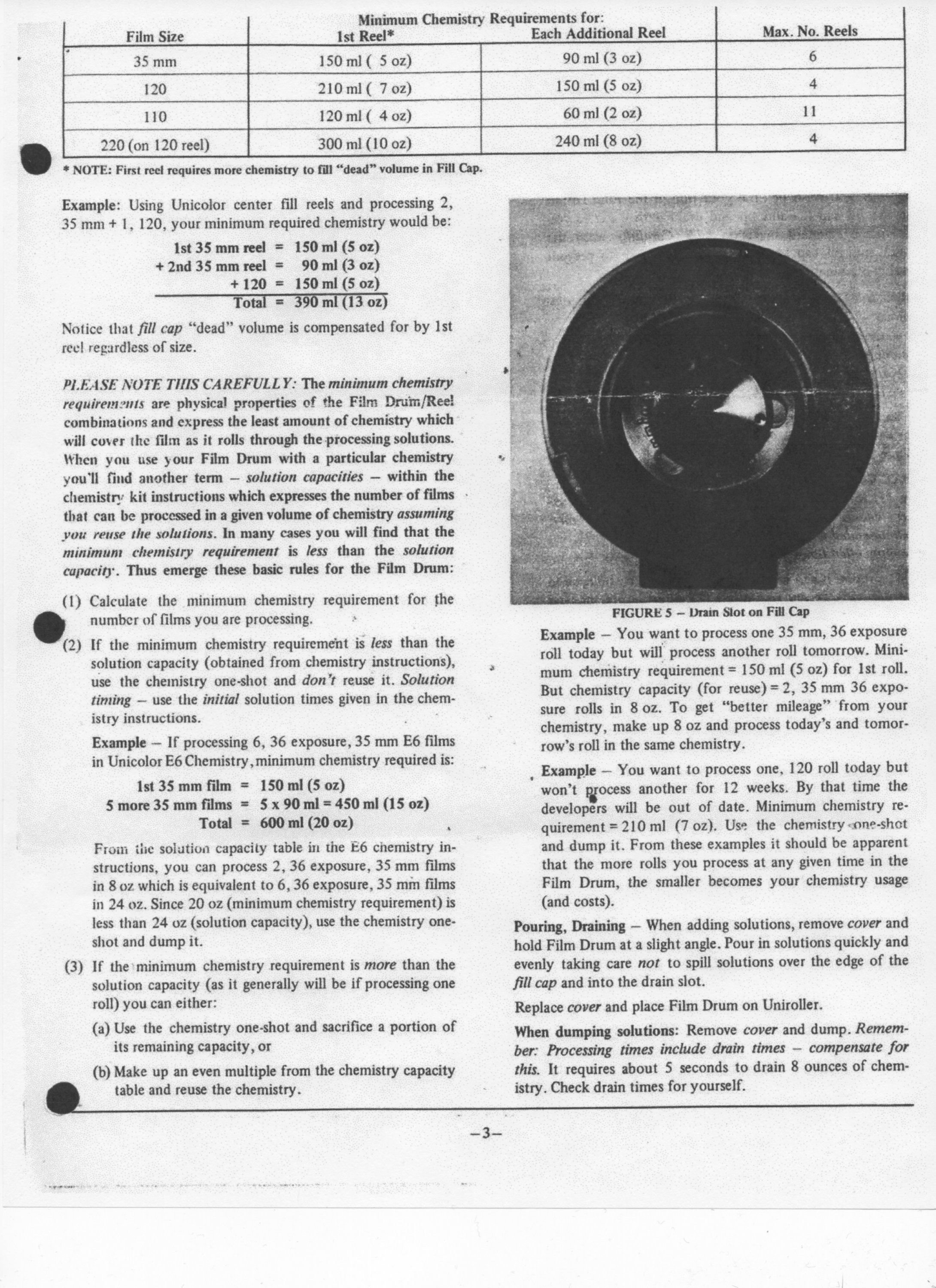

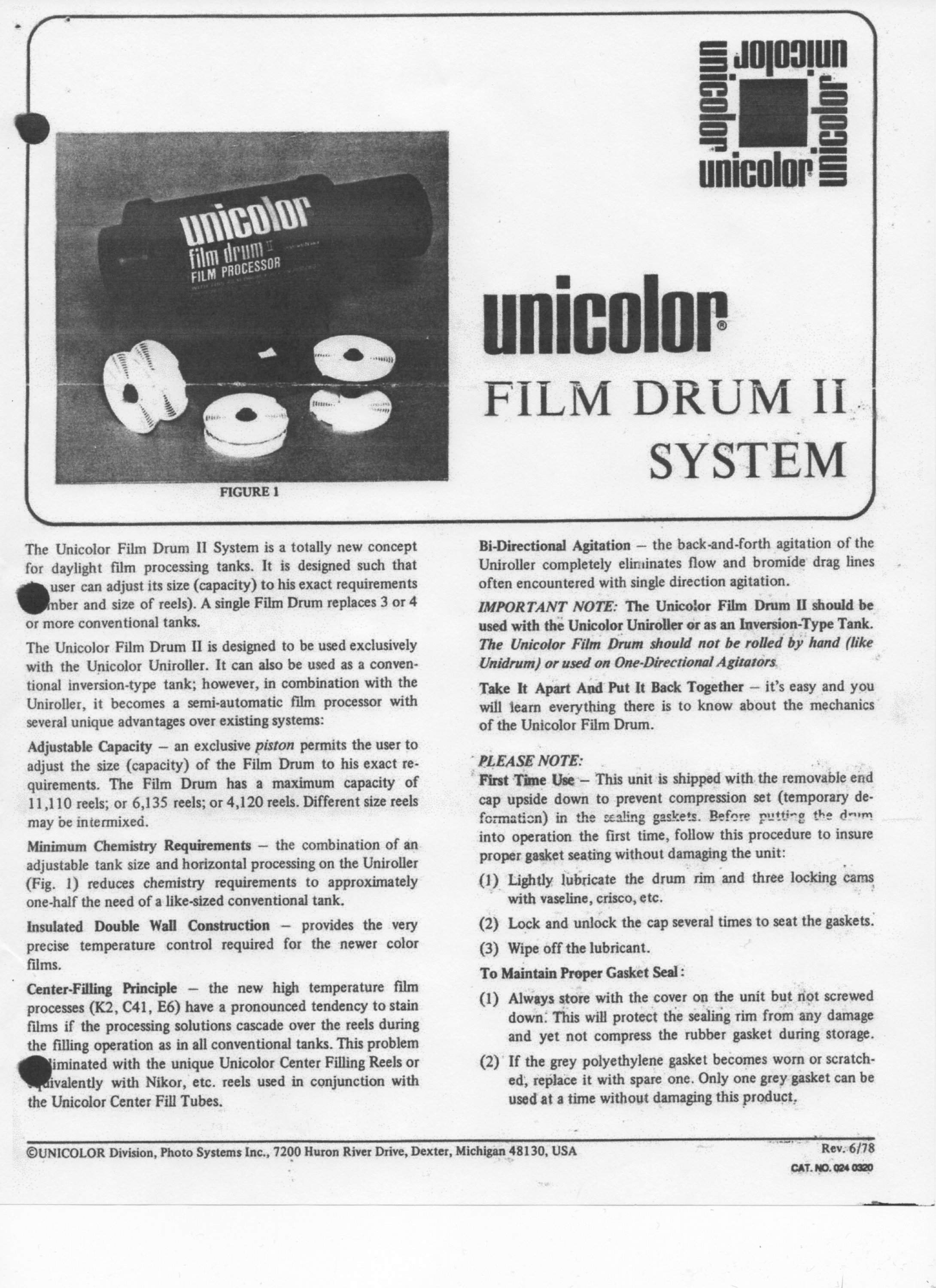

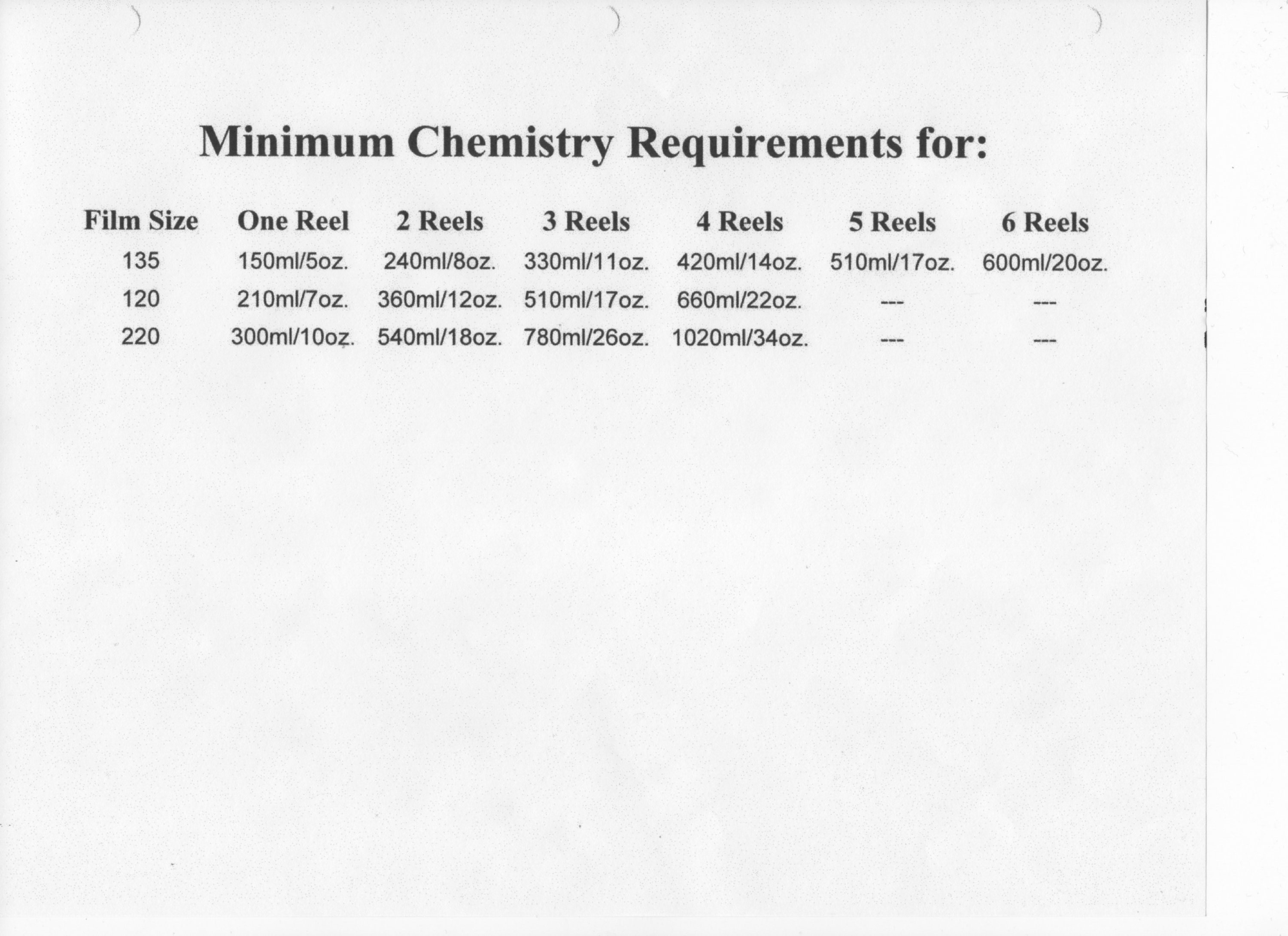

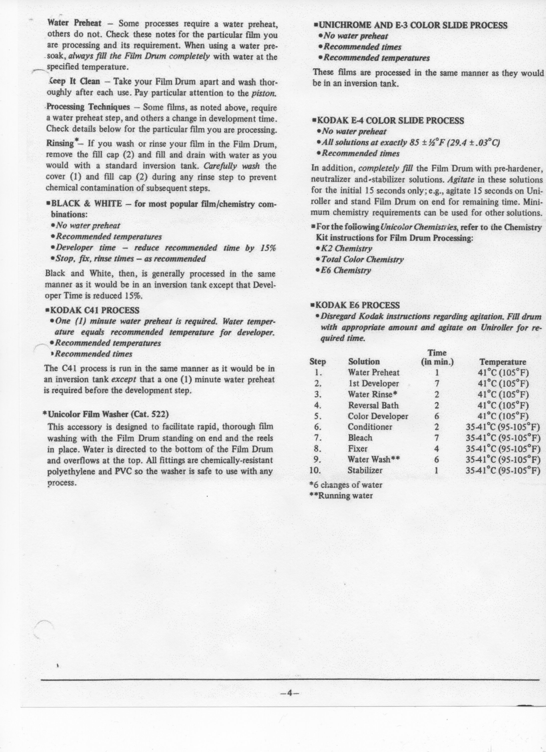

Well, since I can't get the pdf on here, take this:
img090.jpg img091.jpg img092.jpg img093.jpg View attachment 209264
https://www.flickr.com/photos/68434348@N02/albums/72157674373574808

Copy and paste the link I provided to your browser, it has volume's needed. If it doesn't work send me a pm with your email address and I'll send it to you that way.
FANTASTIC! Thank you Rick. I've been searching for that sheet for ages.
