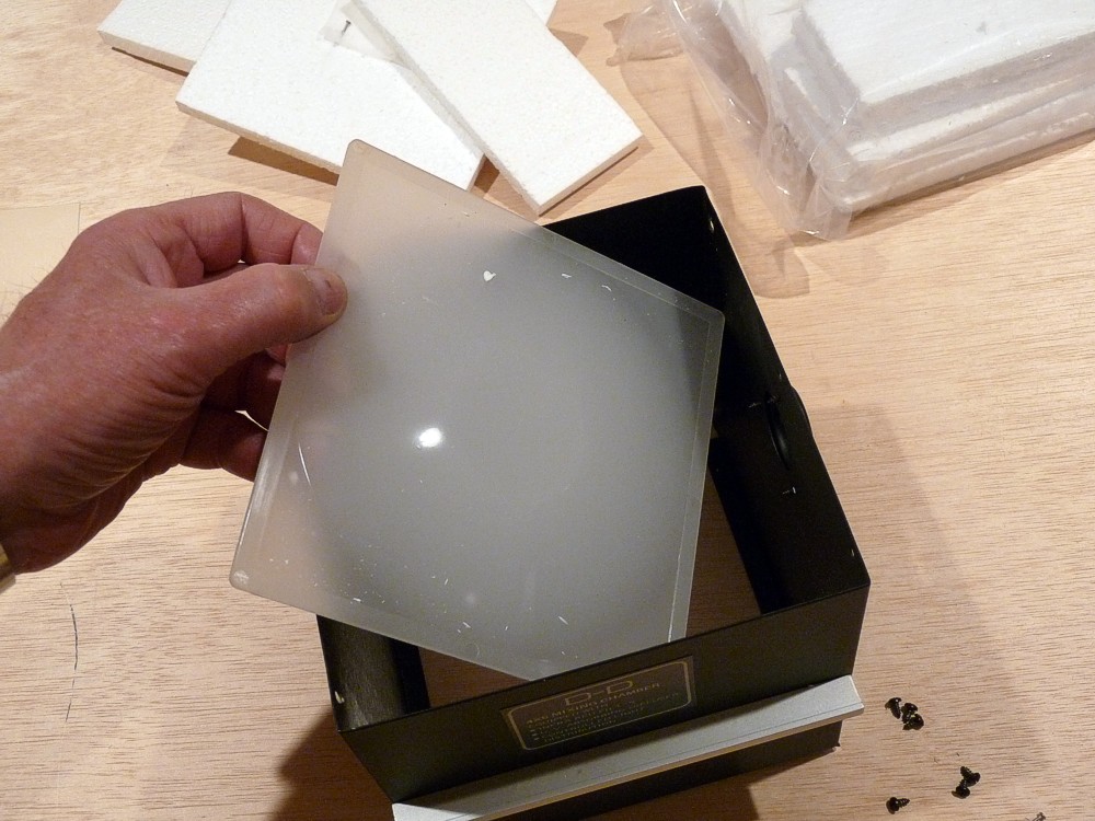

I've been having issues with uneven light from my enlarger. I'm running an Omega Chromega D Dichroic II. It was mostly on the D-B mixing box. One edge was definitely getting a lot less light.

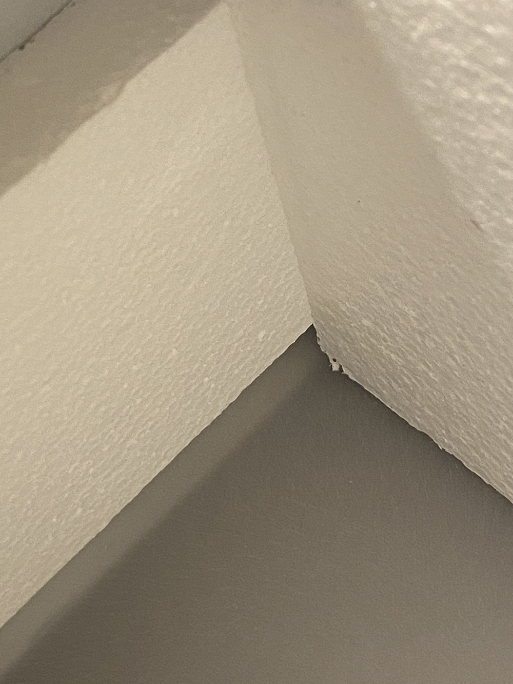

I opened up the mixing box and it all looks fresh and white - probably doesn't need a relining. However, I saw that the styrofoam is touching the diffusion plastic on the edges and it crops the light a bit. Could this be it? Is this normal?

Are you sure you have the correct diffusion plate? It does not look smooth. I use the D5500 which is a little different, but I thought the 4x5" mixing box also had a diffusion plate thicker in the middle like shown here. Maybe someone correct me if I'm wrong.
Are you able to post a print with no negative in the carrier to see the issue at hand?

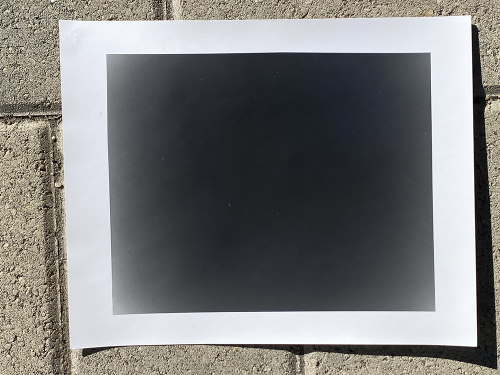

Here's a print I made with no negative. Definitely seeing the dodged edges, but the overlapping styrofoam is on the top and bottom relative to the print. So I guess something else is happening.

Probably the diffuser has been replaced with the wrong item. Again I have never seen anything like what you posted.

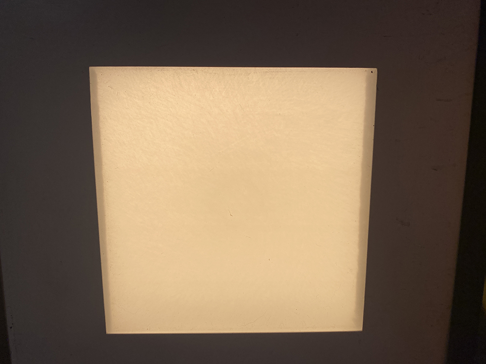

What should the diffusion panel look like? Mine seems to be a brushed texture on the matte side that does look like it has more density in the middle.
What side should be down? Glossy or matte?
Styrofoam is fine. I realized that the foam overlap was due to the tapered top and bottom pieces being installed opposite, so the tapered portion was against the wall. That would be my easy answer to the problem, except that those were top and bottom and I am seeing the light fall off on the sides.

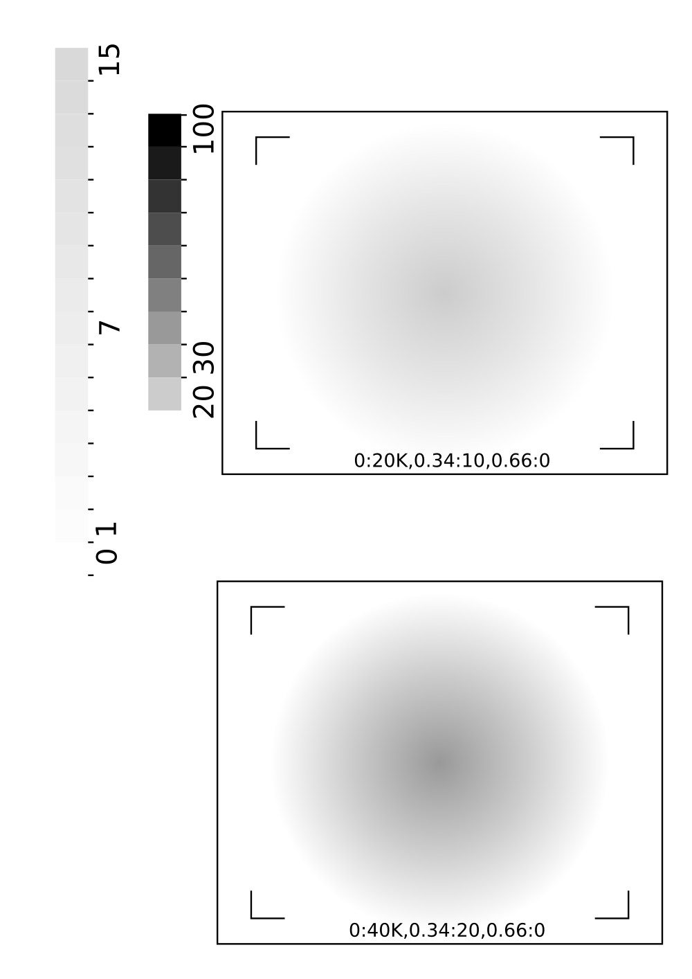

I have had a similar issue in an enlarger I converted to RGB LEDs. After my diffuser material, the light is not even enough. There is a falloff of about one stop between the center and the corners of a 6x6 negative. My solution was to print a center filter with a laser printer on transparencies.
I have designed the filter using circular gradients in Inkscape, the free vector graphics tool. Unfortunately I cannot upload .svg files here, so I am posting a PNG rendering of the SVG. If you are interested in the file, please PM me. The PNG can be seen below. Because I wasn't sure what I need exactly I just printed two different filters on one A4 transparency. The top filter is the one I am using, IIRC. There are also some gray scales on the side that I used to find a relationship between brightness values in the SVG and density of the transparency.
The laser print on the transparency shows a very apparent dithering pattern, which is to be expected. I sandwich the center filter directly above my diffusor material. After diffusion, I cannot make out this pattern on the baseboard, so I think it's not an issue. With the filter I get a falloff at the corner of a 6x6 negative of only about 1/6 of a stop. This is acceptable to me.
