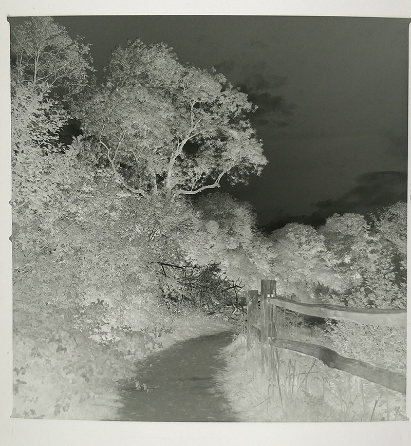

When I look at the scan, noting that you metered the grasses on the right, they don't look like they're on zone III; that area looks more like zone V.
In the top quote above, if you meter the shadows and want them on zone III you close down two stops. If you meter highlights, you open 2-2 1/2 stops to place the highlights.
Did you misspeak in post #13 as to the process of exposure? Did you really mean you opened two stops?
You are absolutely right, I meant the opposite of what I actually wrote.
I normally use the meter in EV mode and match it with the corresponding EV settings on the hasselblad lens. In this case, according to my notes, the shadows read about 11EV, so I set the lens on 13EV (and then applied thefilter factor, somewhat arbitrarily based on the 8x stamped on the ring and some other sources, of +3 stops).
I have posted a photo of the negative above, which should give a better representation of the shadow areas on the bottom right. My densitometer reads about 0.30 around there, which should be about right for zone III.

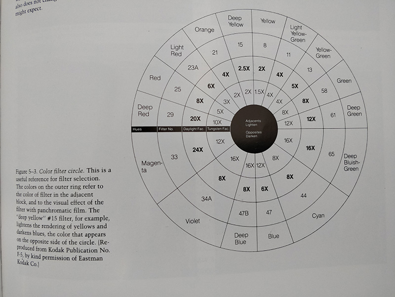

Isn;t the 8x the filter factor. You divide it into the ISO to determine the actual ISO settings for your meter. So if you're shooting let's say Tmax 400 (ISO 400), you divide by 8 and get 50. S0 you set your meter at 50. It's also 3 stops (1/2x1/2x1/2) 2-4-8. 400 - 200-100- 50.
Yes, I understand the relationship with the stops. I have found where I had read the correlation between 8x and Red25 filter. It was in "The Negative".

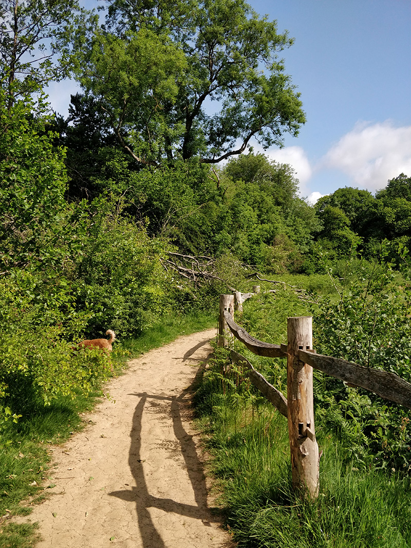

I passed by the same area today walking the dog (it's literally 5 minutes away from home) and took this snapshot with my phone. Light is different as it was coming from the right this morning, and from the left (afternoon light) when I was there with my Hasselblad. But it should give you an idea (if you ignore my dog looking for hares in the bushes :D).

I normally print in the darkroom of my camera club, but I cannot access that yet due to the lockdown. Here's a scan of the negative on light table, shot with my phone.
I also shoot a red filter on my hasselblad and my negs exhibit much lower density (compared to your sample) in the sky which is almost black when wet printed. However, I shoot at Sunny 16 plus the 3 stops allowed for the filter. My skies on the negs are almost transparent with box speed and normal development in D76 1+1 with both HP5 and 400TX. I have a feeling that exposing your film at 160 with adjusted development is compressing the contrast/tones much too much and negating the effects of the red filter. Try a roll at Sunny 16/box speed/normal development and I expect you will experience a vast improvement.
I only downrate EI that much (160) when I have to deal with extremely contrasty situations; sometimes I end up with really muddy negs. In my view, your uploaded color photo certainly doesn't warrant downrating to 160 EI.

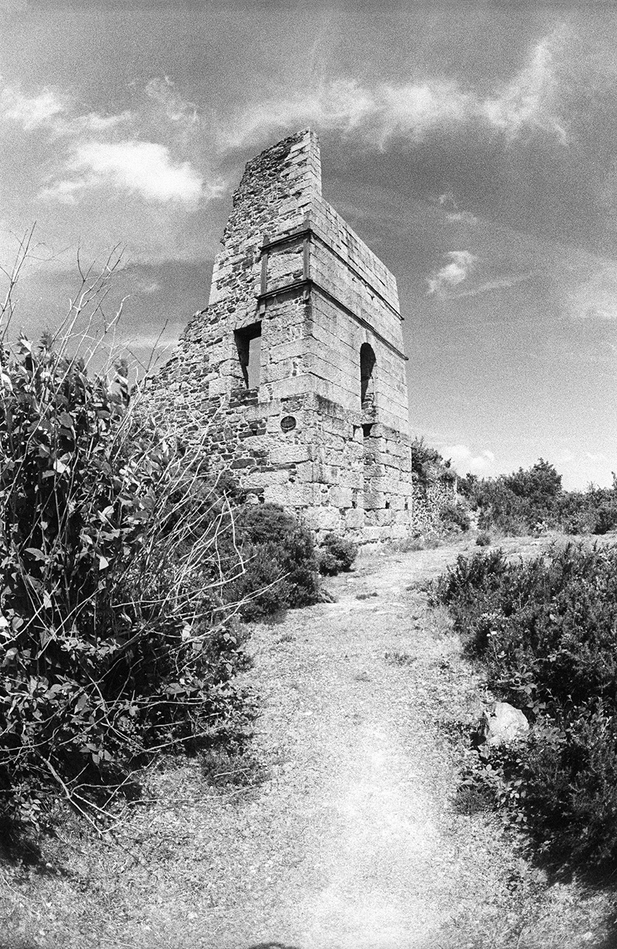

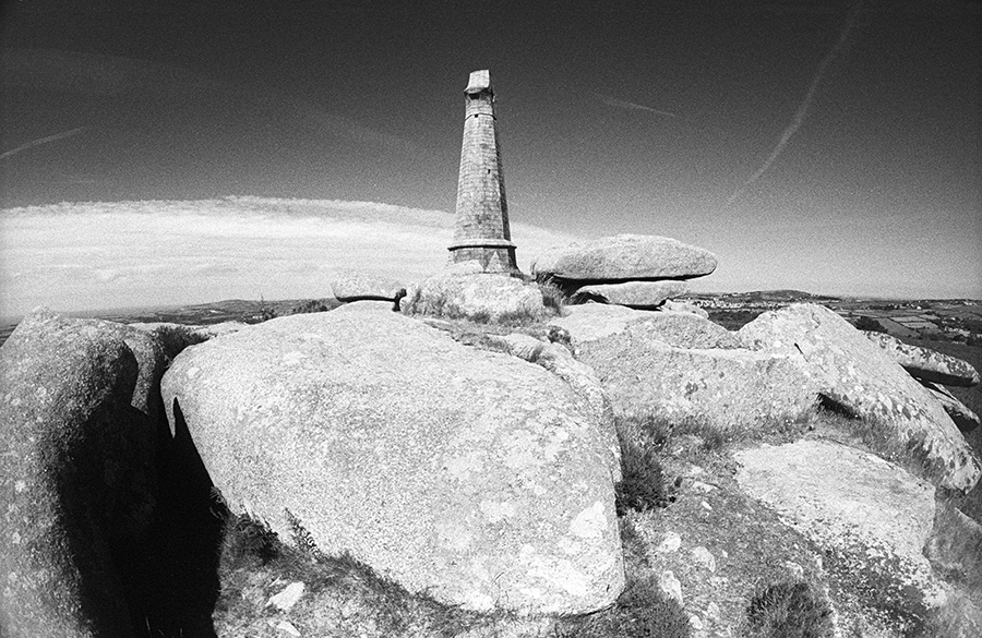

I felt the same underwhelment (real word?) when I used an old 35mm camera last year, fitted with the only lens I have for it - a 16mm fisheye - and red filter. Some of the shots came out with a half decent dramatic sky, but most didn't. 2 examples here of one that worked and one that didn't.
All these zone numbers being mentioned go way over my head, and the camera I used was very basic with no metering modes, so they were just straight shots. I'm in the UK btw.View attachment 246849 View attachment 246851
I like the grain and tone in these pictures Paul. :smile:
You say you used a 35mm camera, but what film and film developer did you use, if you can remember?

If you you look at the negative, though, you can see that the density of the sky area is about a mid tone, nowhere near the density (or lack thereof) I was hoping for.

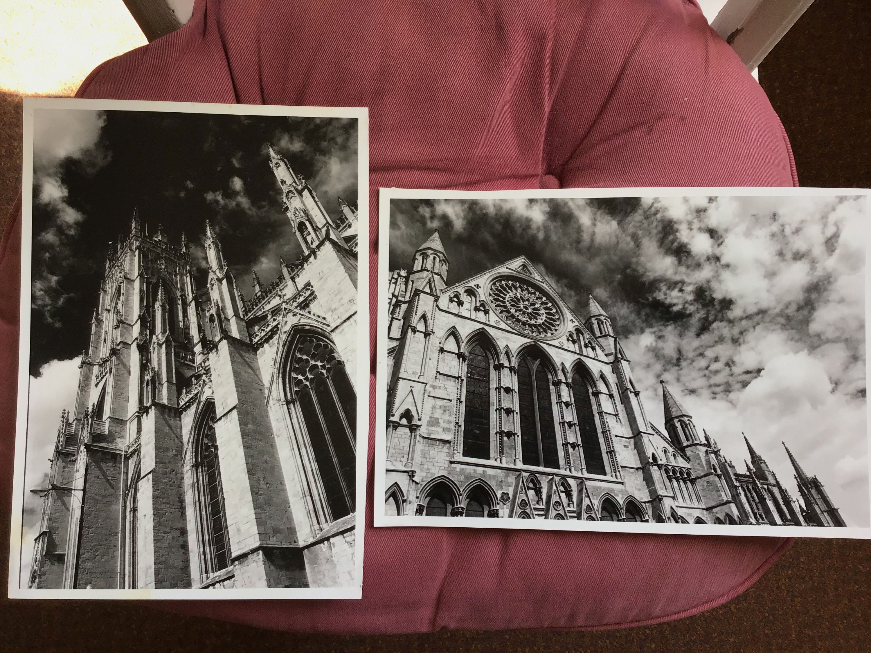

I've had some success getting good effects with the R25 filter in the UK. I think the best approach is to have the sun behind you at the sort of height you get in mid afternoon. That tends to make the blue stronger. Fluffy white clouds help too. I think the best impact is with rocks or buildings in the foreground as the red filter tends to darken leaves too much. I've always shot a box speed and metered ttl with filter in place. I don't know anything about scanning but in the darkroom, printing on a hard grade has worked for me:

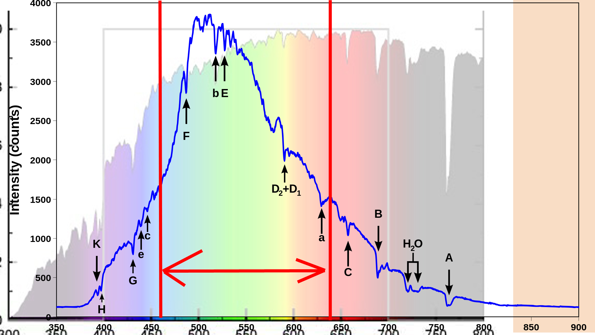

Haze will decrease the effect of the red filter.
See the sky spectrum compared to sunlight reflected by clouds, showing the spectral range that it should be blocked for max cloud-sky contrast...
> For a good effect the red filter, beyond having to be intense (saturated), it has to be deep, blocking from around 640 is good, see spectral graph of your filter.
> If the filter is some magenta, also allowing to pass from 460nm to UV, then it also contributes to clouds-sky contrast.
> Your film requires good deep red sensitivity, an orthopancromatic will record worse the deep red you are allowing to pass, extended red sensitivity film increases the effect, see how dark are skies in IR photography !!!

I'm really sorry, I honestly can't remember which film, and it wasn't developed by me, so again unsure which developer was used.
