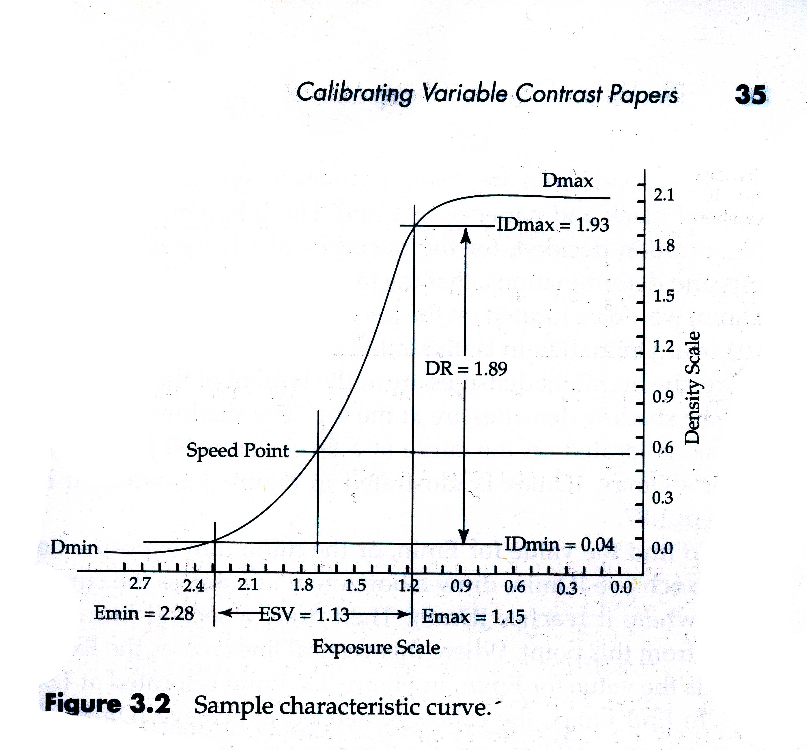

I am reading Steve Anchell's book on variable contrast printing and there is one point, which seems absolutely fundamental to his whole approach, that I just can't get. On page 35 (depending on edition), he presents the characteristic curve for paper. On the vertical axis is density, running from 0.0 to 2.1. No problem. The horizontal axis, however, is exposure and it runs from 2.7 to 0.0. Thus, the more exposure, the less density on the paper, which makes no sense. What am I not getting?
I realize that this may be a really dumb question but it wouldn't be the first time I asked one in this forum.

Does the book present a formula besides the graph? Maybe the book defines exposure as something like:
Exp(Constant - E)
where E is plotted in the graph. Just a guess. :smile:

that x axis is negative density so the higher its value the less exposure the print gets and the lighter it is.
And remember of course that the toe of a print is the highlights and the shoulder the shadows for anyone confused by it.

Thanks guys. I think I have it figured out now. As many of you have said, these are negative numbers or film density, thus the less exposure, the less density in the print.
Due to my limited grasp of math and graphs, I sometimes get stopped dead in the water when I can't quite sort out a small detail. But I am now forging ahead.

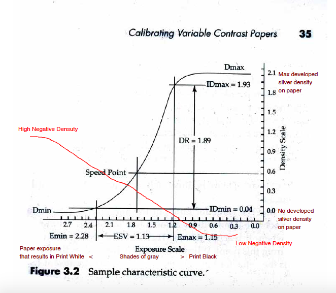

Added some tables to the curve and the red line is one possibility of how the negative curve might fall across the paper curve.
  • print curve-001.pdf

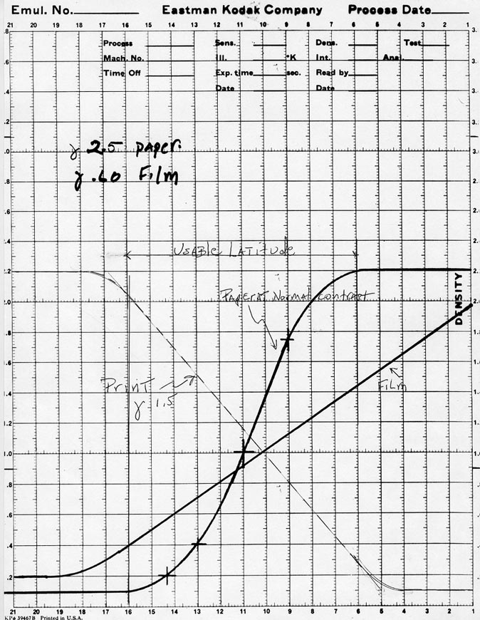

Here are two graphs.
The first is a set of print, paper and film curves used to examine Kodak films for conformance to release specifications. Positives are plotted with Dmax on the left, and negatives with Dmax on the right.
The second example is a blank sheet of the paper used for this type of work.
PE
