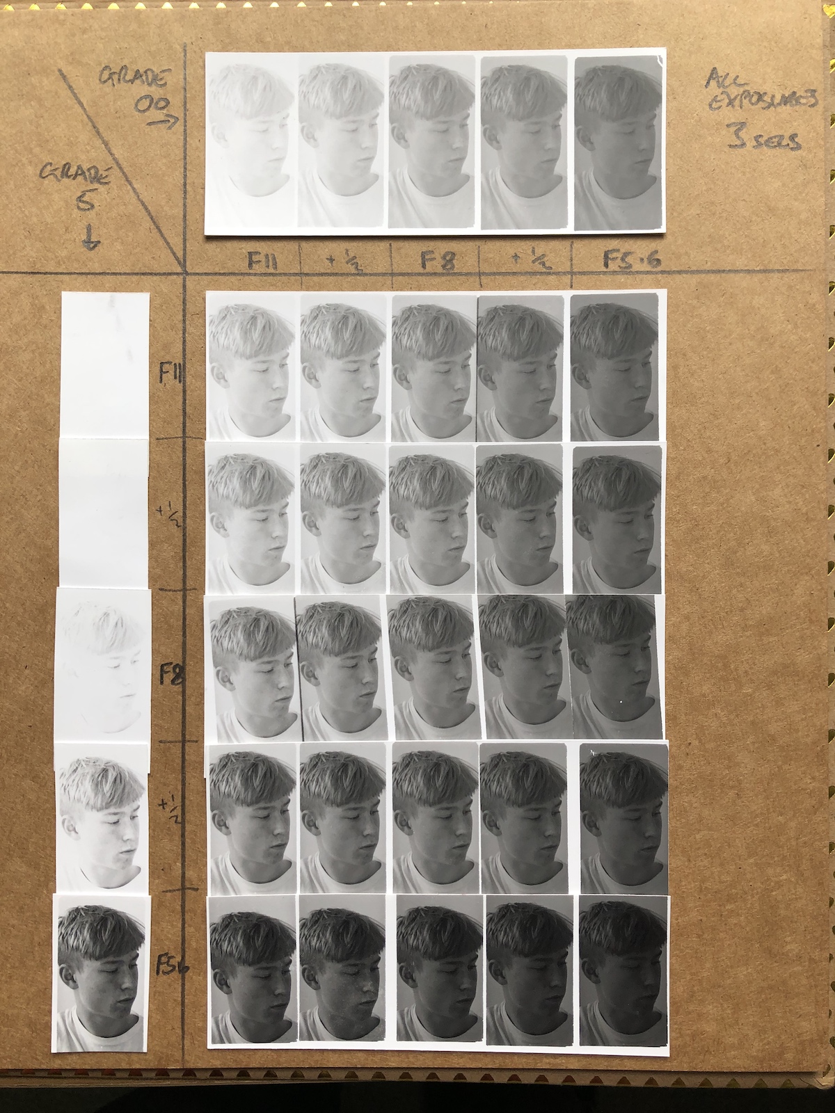

Hi - I've been trying to get my head around split grade printing. In the process of trying to visualise what was going on I decided to do a bunch of tests which I'm putting here in case it helps anyone else who is going through the same learning curve.
The picture shows the output of my testing. It's just an iphone pic of the page in the scrapbook I'm using to document stuff, but looks fairly true to the tones on the actual page
The top horizontal row is a set of exposures just using the Grade 00 filter in half stop increments. The left vertical column is a set of exposures using the Grade 5 filter in the same half stop increments. The elements of the 'table' are the combined print G00 + G5 at each of those exposures. (I usually use F-Stop timing, but in this case realised it was quicker; less error prone; and in-theory - the same result; to expose each test for the same time and adjust the exposure using the lens using 1/2 stop clicks).
If you're going through the same learning process then I'd really recommend having a go at something similar. It's made me see a whole bunch of things including how the G5 exposure (even where it doesn't show any density on its own at lower exposures), definitely adds contrasts to the G00 exposure (which I guess is the same process of activation threshold that flashing uses?). I'm hoping that this will remain a useful reference to go back to when I'm printing actual prints :smile:
Really interested to hear any other approaches people have used for getting up-to-speed / learning about split grade.

A great set of shots Jim. I watched several videos on this by our own Greg Davis who posts here on Photrio and Dave Butcher an Ilford master printer. Both speak of what is happening with the process and things like not confusing contrast with exposure etc but these pics of yours really brings it out in front of your eyes With grade 0 you see the effect of overexposure which can look as if it is better for contrast but isn't and then with grade 5 on top of the grade 0 it is almost as if the face is coming out of a kind of a mist to demonstrate that at some point the face has both the highlight detail in the tee shirt and the necessary contrast and shadow detail.
Excellent observation, and a good reason to expose low contrast first and add the high contrast on top. Thanks for sharing your experiment! Split contrast printing is an enjoyable and flexible way to print.

re dodging and burning .... I guess that's why I made the tests - I wanted to get a sense of the impact. i.e. if the centre image was part of a print at base exposure (however that was made) then a 1 stop dodge with the 00 is two to the left, a burn two to the right. Equally a one stop burn with the 5 is two down, a dodge two up (if that makes sense).
Really appreciate all the comments and advice - this forum is such a helpful resource

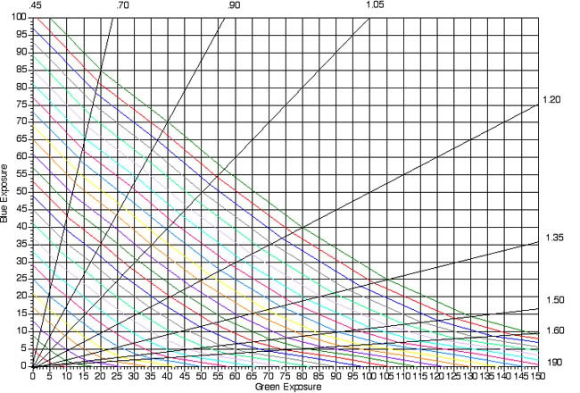

ic-racer
Feb 25, 2007
16,482
USA
You can do the same thing with a step wedge too. The colored lines are isodensity on the print. The radial lines are log d of the tonal range or ISO(R) contrast.

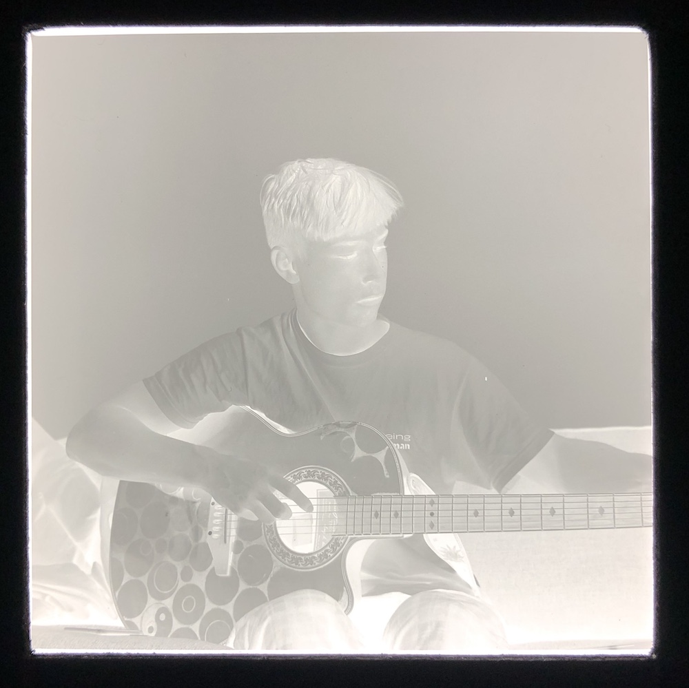

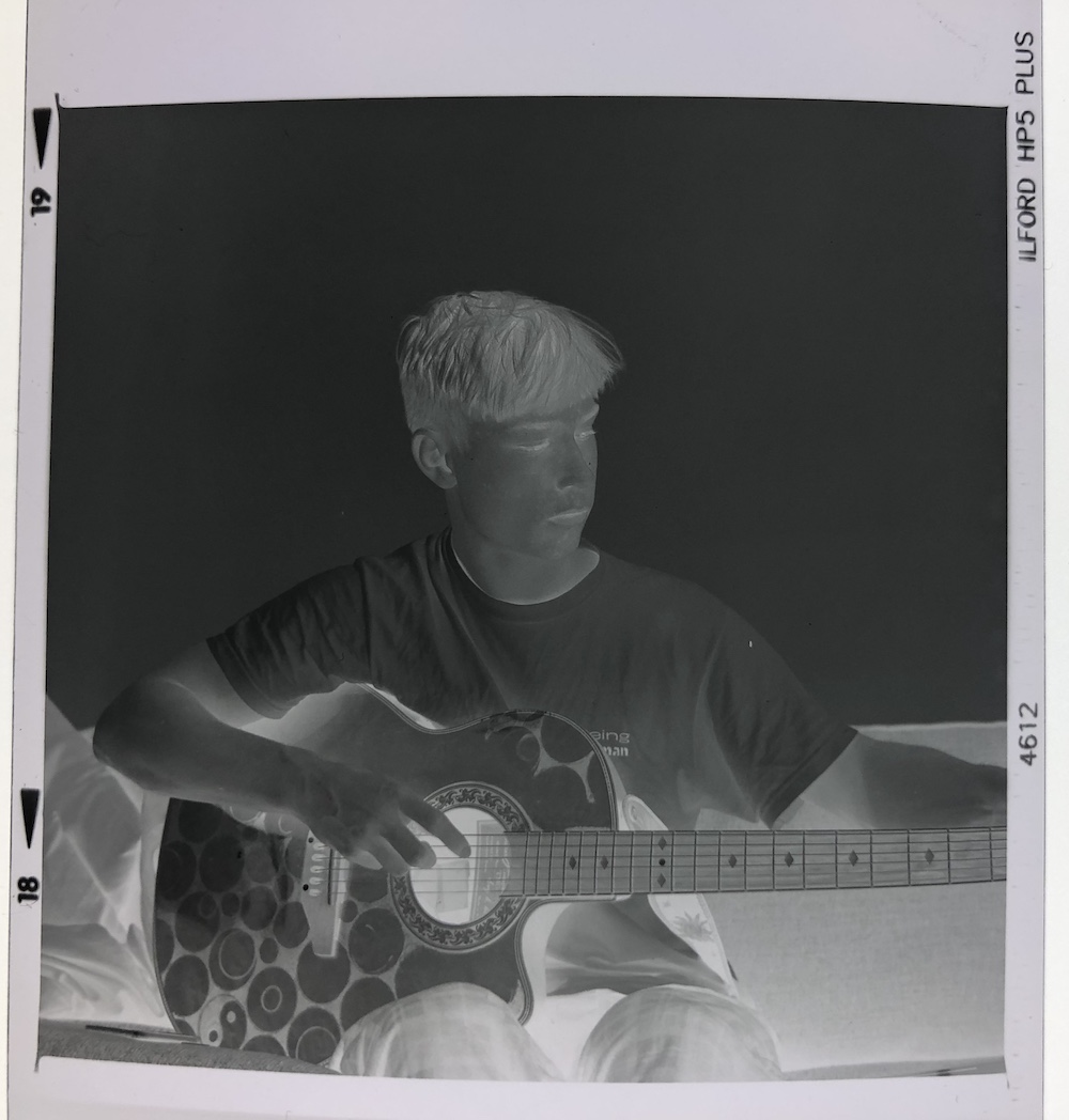

JimEA
Aug 25, 2020
14
UK
@pentaxuser here are iphone pics of the negative on a light table - I've put two here - one is with the negative masked with some black cardboard, the other just on the light table (the phone camera does all kinds of trickery so can;'t really say either of these looks quite like the negative does to my Mk1 eyeball - I did, however, switch HDR off so at least its not manipulating it that way). Having never actually seen another persons negatives in-the-flesh as it were, I have no idea how contrasty, or not these are. It was an indoor shot so could well be a bit underexposed I guess)
pentaxuser
May 9, 2005
19,621
Daventry, No
Thanks Jim. I confess I still have problems reading negatives and hopefully the person who thought your prints suggested a low contrast negative will say what he thinks and if he is still of the same mind will say what in the negative indicates low contrast.
The highlights, which are mainly the white tee-shirt, looked OK to me in that the tee-shirt was white but still retained some texture and what looks like a clear area on the negative should turn out to be virtually a featureless black area on the print. Of course on the head shots used for the examples of various exposures and grades does not have a full range of tones in terms shadows.
If the neg was developed using the maker's suggested times for the speed of the film in that developer then the contrast should be fine for split grade
I suppose that there is a possibility that with that very light coloured( in the positive) background the camer's meter may have been fooled into underexposing slightly but it will be interesting to hear what others' verdicts are on the question around which my request for the negative revolves, namely: What are the signs, if any that this negative is low contrast and how does this manifest itself in the split grade process?

Donald Qualls
Jan 19, 2005
12,087
North Carolina
The left negative looks quite underexposed -- which might be the phone camera trying to make an average with the black area of the mask. The right one looks very normal -- which might also be the phone camera averaging the white area. Take an average of the two and it seems likely you're a stop or so under exposed, but approximately normal contrast.
