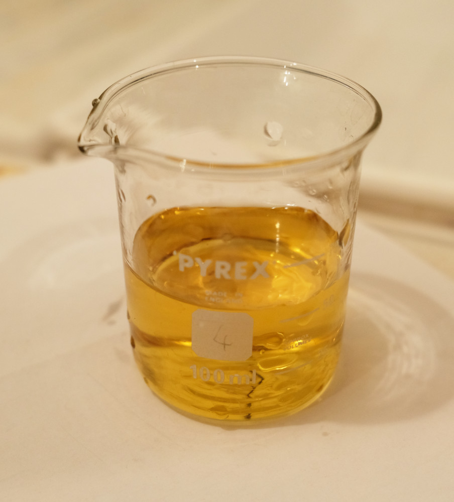

I still slowly using the bottle opened about 9 months ago. When the solution starts to discolour I'll no longer use it.
Ultrafin must be stored in a cool place, it will go bad relatively quickly, if it is yellow, everything is too late. Normally it is transparent with a violet shimmer, discoloration begins with a slightly yellowish tone.
I have just been sorting through some developers, and note that my container of Ultrafin has become discoloured with the 'yellowish' tone you mention. I will approach with caution.
