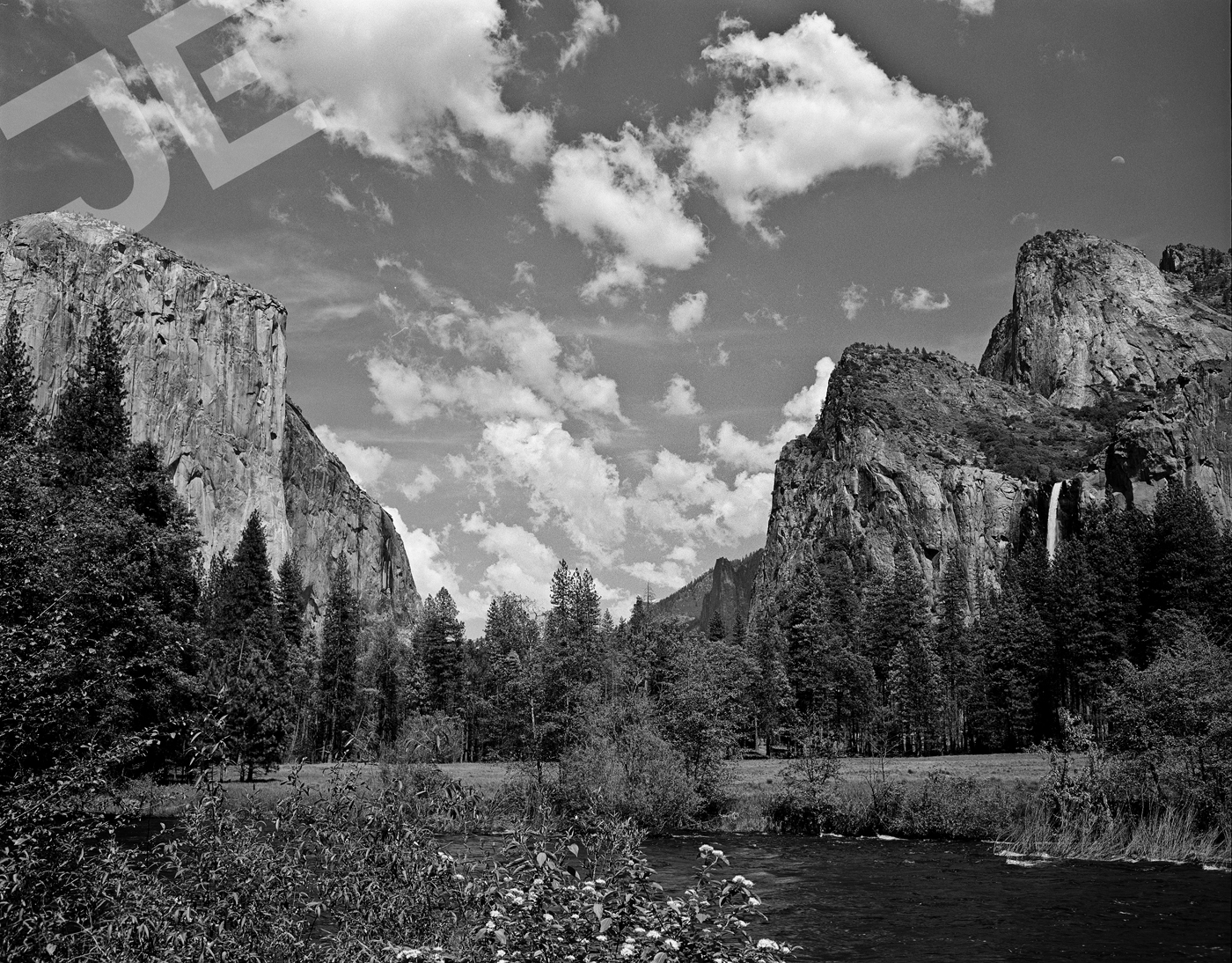

I had this issue a few weeks ago with brand new Rollie retro 80S film. this is the new batch in the cardboard boxes, not the older plastic cigar style holders (which I really like). I sent this scan off to someone who knows the rollei films very well and asked his opinion. He replied "this does not look good, it looks like a backing paper issues" I trust his opinion and sent off an email to maco. I got the typical response fomr them, that it is my process that is at fault and im wrong. I even developed three different rolls of film at the same time with the RR80s, two of acros and now one tmax 100 and none of them had issues. also then did 3 more rolls, three different developers all with brand new one shot fixer and the entire process with distilled water. same issues. I had bought a bulk roll of RR80s in 35mm at the same time i bought the 120 rolls. So I rolled up a few rolls of the 35mm and had no issues at all with them. I wanted to keep this quiet until I knew it was something that i did or didn't do as I didn't want to point a findger at someone who did nothing. After getting blown off by maco I posted the shot in the flickr RR80s group and within a week got 4 others who had the exact same issue. anyway here is what I posted on flickr......
not sure whats going on here. the grey sky has black dots all over. it is on every frame of the three rolls I shot. used the same camera for many other rolls and none had the issues. I then developed the last roll along with a roll of acros to see if its the developer but the acros was great and RR80 had the dots all over clear grey sections, like skies. and YES it is on the negatives as I used a high power loop to view and they are there, along with using a macro lens to to take a digital shot and zoomed in a lot. this is on the brand new batch i bough about a month ago, exp date 9/18. i have more rolls along with bulk rolls and im afraid the use them. sent an email to maco, but based on their past behavior, I really dont expect them to answer.

So if Im not the only one with this issue, and there is only one company left, if I remember reading correctly that makes the backing paper, and Kodak has an issue are we in trouble? I was particularly interested in the quote that we changed the backing paper, in a similar way to kodak changing theirs. dont want to cause concern but Im feeling like there is a reason to worry. I re scanned the neg, same issue. Used 3 different loops, same issue. printed the photo with 3 different enlargers, same issue.
Anyway thoughts?

why would that be backing paper causing the stipples? does the backing paper have these stipples? when holding the backing paper up to a bright light, can you see these stipples? does the backing paper have a texture?
beautiful photo!
I can only see the JE which looks so clear and bold it is almost as if it is meant to be there. I can't see any black dots.
So to be clear, can the OP say why he makes no reference to the JE? Can he also confirm that what he has are random/patterned black dots but are not the frame numbers or the patterned dots from the backing paper that lead to the frame numbers, assuming that there is writing/dots on the backing paper that leads to the frame numbers

If you click on the .jpg link in the attachment you will open the image that can be magnified; then the dots can be seen.
Yes, click on the text link instead of the thumbnail. The "JE" is a watermark put there by the OP.
sorry, the JE is a watermark my son put on it so my photo teacher could see that it was my photo. if could be hard to see the black dots as im limited to the size of the uploaded photo. the full size scan where you can scan in shoes them easily. if im allowed i could post a link the flickr upload which is a larger size
It's a beautiful image and a tragedy about the black dots. Maybe a developer issue?

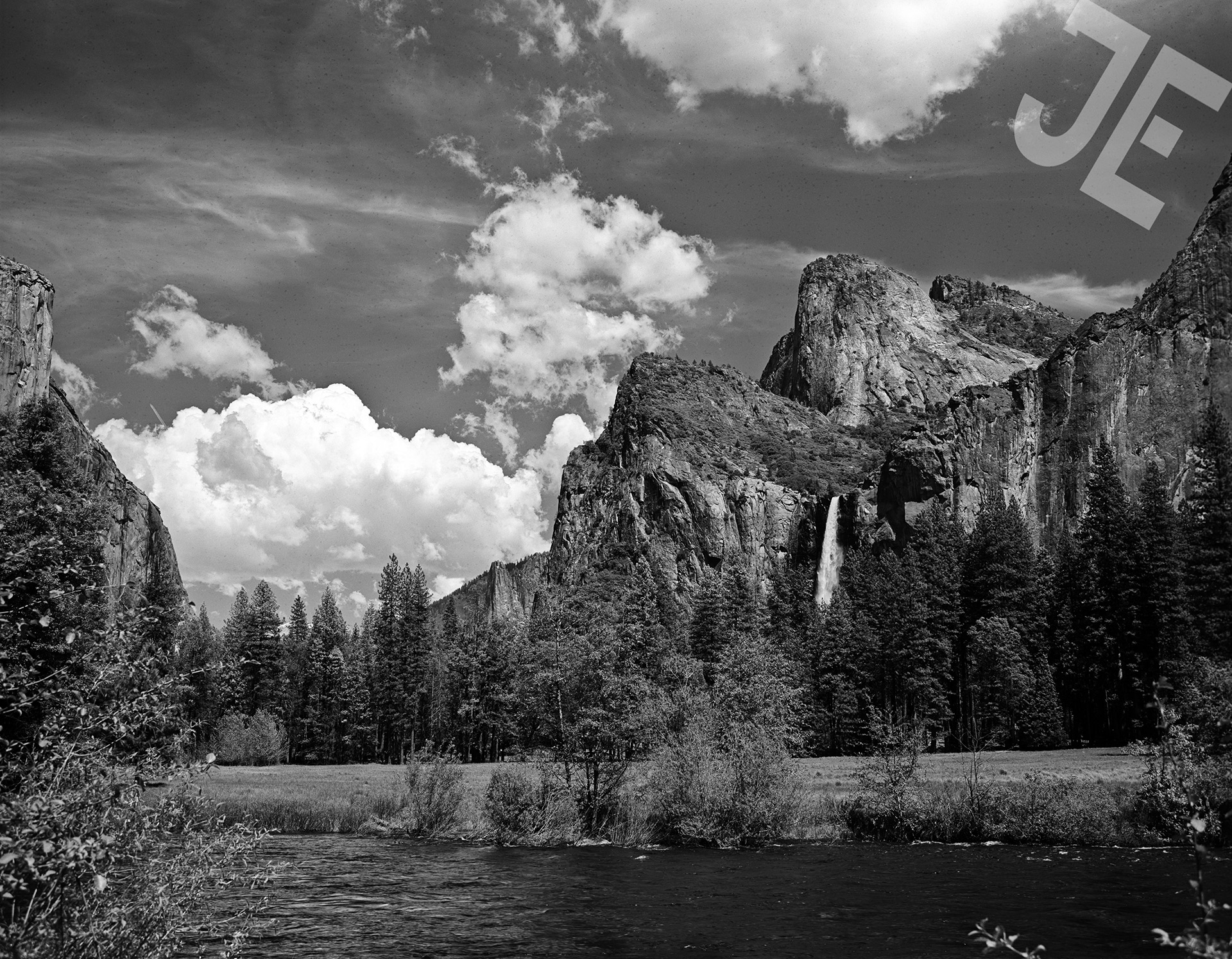

i took the same shot in the same location with a roll of across as that was the last shot on the RR80s roll and developed it at the same time in the same tank as the RR80s. the acros came out fine.
here is the acros shot. sorry for the watermark.
It does not look like air bubbles to me (too many for normal bubbles and too small) and it also does not look like backing paper.
PE
Those black dots may not be that noticeable if you don't go too big and print it with a diffuser enlarger. My guess is dust in the emulsion, maybe by contamination of the water. Do you use a coffee filter for your chemicals? Was it just on this frame? No matter what someone else says, you have the negative, so look closely w/ a loupe and see if others on the roll have this issue, and see if you can determine what is on the negative. If it's dust in the emulsion, it could have come from inside the camera or from when the negs were hung up and drying (this happened to me once), etc.
The good news is that you are very, very lucky, as the Acros shot came out fine. W/ a filter in the enlarger for a little more contrast it will give a wonderful print.
Dust in the emulsion would cause white spots, not black. :smile:
Dust on the emulsion during the taking of the photograph will appear as light spots in the negative and dark spots in the print. Dust in the film will appear as dark spots in the negative and light spots in the print.
Separating the light spots from dust and air bubbles is hard unless you know the format size and image magnification, however, air bubbles often have small rings around them.

It would appear from what has been said and deduced so far by other posters that it is not the frame number transfers from the backing paper that afflicted some Kodak batch numbers and may be not related to the backing paper per se at all.
Very unfortunate and disappointing nevertheless
pentaxuser
It looks like lots of dust that was there during the exposure (yes, BTDT with 4x5). Is the new backing paper more flaky? But it doesn't look like airbells (BTDT,T) or the same issue as the Kodak backing paper.
Maybe dust is being deposited on the film prior to exposure when you remove the dark slide.
Are the light seals in the film back degrading?
I'm not buying into the dust thing! Unless of course your dust is different than mine. My dust is much more irregular in shape compared to what I see in these shots. Might just be something contaminated the emulsion base itself???? Fungi, bacteria or gremlins? Better yet, maybe the OP captured a micro-meteor shower coming directly at him and didn't know it. All kidding aside, this would piss me off if it were on scenes as gorgeous as those.
That is a super shot sad that it is dsmaged.

But you need to be able to look at negatives as well.
Jewellers loupe or prime lens and light source both at glancing angle to validate that the emulsion surface is perfect...
This only eliminates one mechanism.
I don't see how this is the backing paper nor how it resembles in any way the recent backing paper issues seen recently. Your subject line is unfortunate, premature and alarmist.

Thanks but where there any surface flaws associated with the dots?
If a bit of emulsion is missing or there is a pit eg that could give a black dot on a print.
If there where bits of emulsion missing it is back to supplier...
