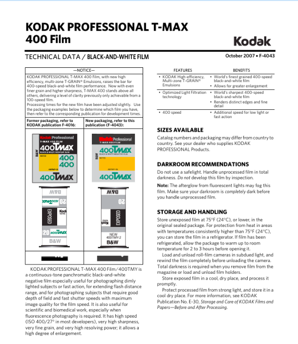

I would point out that that packaging is at least 15 years old, and would have been current at a time about 3 years after the TMY to TMY-2 update.
Here is an excerpt of the data sheet that references the change:
As we are now nearly two decades into the current product, the need to show that it is the "new" version has basically disappeared.
The most recent datasheet is from 2016, and the reference therein is to: "KODAK PROFESSIONAL T-MAX 400 Film ⁄400TMY". The only "2" you might find is in a product or catalog code that shows as 400-2TMY.

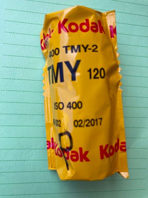

This is from the problematic batch of film - thus the "P" in felt pen - I still have around from the period of time where the wrapper offset issues beset Kodak - so 6 years more recent than the example shown by @GregY .
If you have some more recent packaging easily at hand, feel free to share.
Here is the 2017 packaging that wouldn't upload to the previous post:
