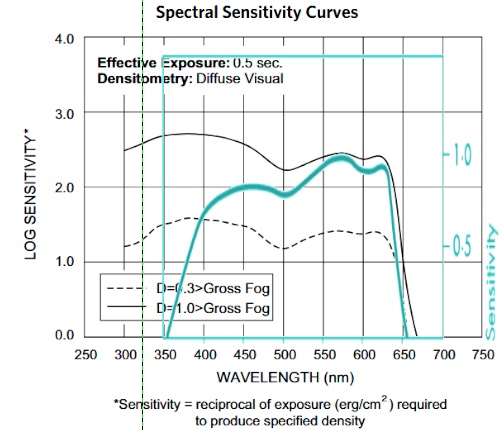

Still not sure about this. HP5+ and TriX appear to have minor, but visible, differences in their spectral response based on the recent test by the Naked Photographer.
Left panel, HP5+, right panel TriX. Colour checker left, column 2, final row: the yellow appears to render brighter with HP5+ than TriX, even attempting a correction for absolute brightness differences.
Spectral sensitivity is always a tricky one. Here's that of HP5+ as stated in its datasheet on top of Tri-X's spectral sensitivity from Kodak's datasheet:
I doubt the drop-off of the Ilford product on the blue side is very meaningful since Ilford AFAIK has a different measurement approach than Kodak does. In a previous thread here on Photrio, any attempt to translate one into the other failed on fundamental theoretical and methodological grounds. However, there's an unmistakable and remarkable similarity to the curve shape if you look at the peaks and valleys of both. They coincide almost perfectly.
the yellow renders much brighter with HP5+ than TriX.
The entire HP5+ frame seems to render lighter than the TriX frame...
I wouldn't draw any strong conclusions out of two superimposed curves personally. There is something really odd going on around the blue frequencies.
Is there a standard lighting setup when generating these? Could it be that one curve was produced with natural daylight temperature and the other with some sort of artificial studio lighting (tungsten)?
I do see relative differences in that colour checker above on my monitor.
Like I said, different measurement methodologies. Ilford bases their step wedge on Tungsten 2850K illumination. There's not a lot of blue and no UV at all in there. Kodak's approach is different.
