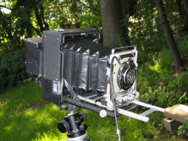

Frequently the leather can just be peeled off, Sometimes it needs to be encouraged. A mild solvent such as alcohol or the more aggressive acetone will take most of the glue holding the leather off.
A light sanding, some stain & a varnish or polyurethane to seal & finish and voila a newish camera
Removing leather
Mine came of in strips using pliers, then the glue washed off with water, just don't allow the wood to stay wet longer than necessary. A little fine steel wool will speed the process. Mine was finger jointed mahogany, and I finished it with a light coat of stain wiped on and spray can clear polyurethane. I also sprayed the inside with flat black paint after masking the exterior. The brass I soaked in paint remover because some of it had been painted, then a weak (diluted with water) muriatic acid (swimming pool ph adjusting chemical) solution and steel wool to remove the oxidation. Then I sprayed those parts with a clear laquer made for metal before re-assembling.
Here is my (modified for field use) CG
