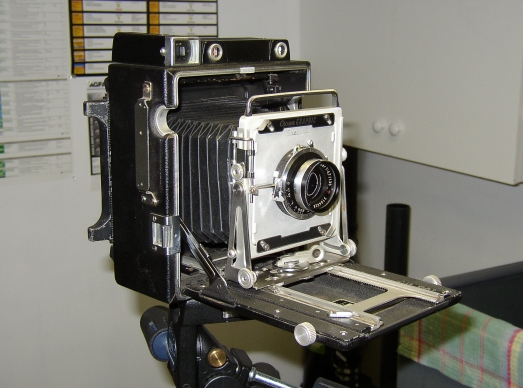

I have a later model Crown Graphic Special with the 135 Xenar lens, which is what the camera was cammed for when I bought it. It has the top rangefinder which is less bulky than the Kalart models, so I have left it on. I picked up a 6x9 rollfilm back for it and just put a few marks on the ground glass to give me a reference for the 6x9 format, and it works fine. I looked at the Graflex website to see how to make cams for other lenses but I find that using the ground glass for focusing is just fine for my purposes. The nice thing about the whole package is that it fits into an old LowePro bag with a few film holders, extra lenses, and a meter, which I find is a great travel package.
