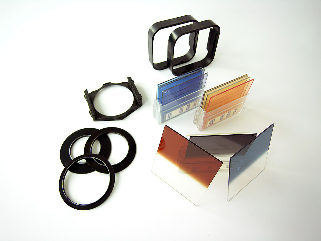

It would be nice if there were filters that had quick releases like a lens cap
You should look into filters with magnetic mounts or, if working from a tripod, rectangular ones which are easy to insert into and remove from their holder. There are solutions for this problem but a simple handheld meter should be about the same cost.

Well there is, Cokin and Lee filter system use an adapter with slide in and slide out filters. The adapters come in different thread sizes, I use mine with MF and LF, not often with 35mm, but I have a set of adapters for 49 to 73mm.

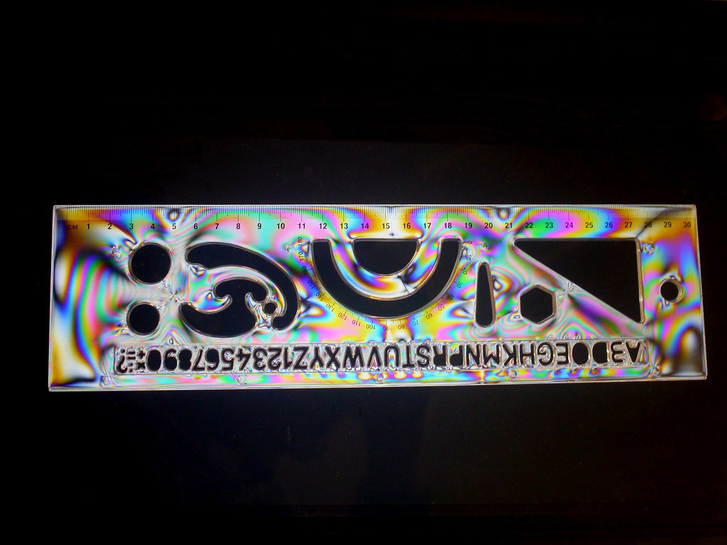

Polarizers are another case where specific circumstances make filter factors useless. The shot below was lit from behind by a laptop LCD screen (a polarized light source) and a CPL on the lens rotated to block the screen in the background.
stressed stencil by Mike Kanssen, on Flickr
Not much of the white screen is visible!
