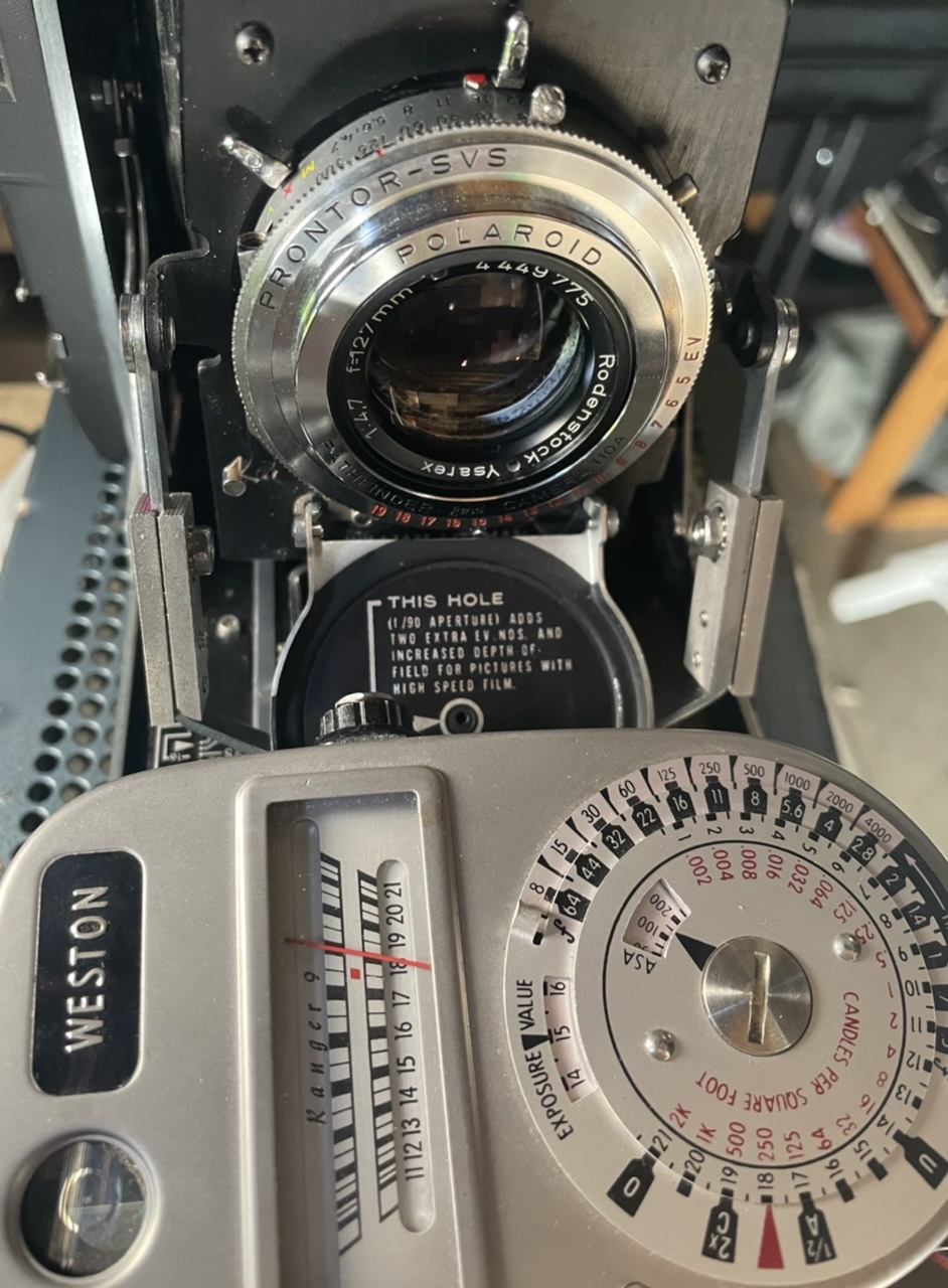

I think it would help to have a light meter and camera that support Exposure Value.
It's been some years now but I recall my Rolleiflex days and EV models being handy to use with my L-398 meter of the time. I was reading this thread to remind me of those functions. I don't recall any complications and it felt intuitive at the time..... Need to dig some old gear out and refresh the process in my head.
