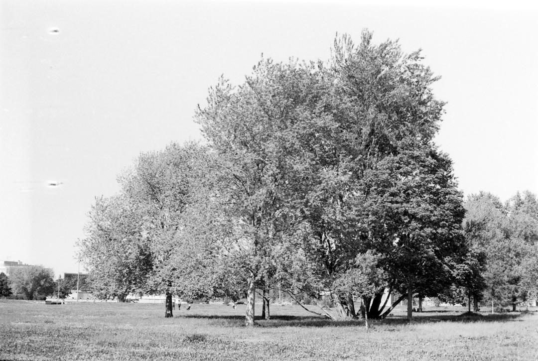

I forgot:
Contrast is good (too) for overcast scenes included in the same roll.
My most common exposure under direct sunlight in this case is 1/125 f/8, without filter.
I use the common AP plastic tank with one of its plastic reels.

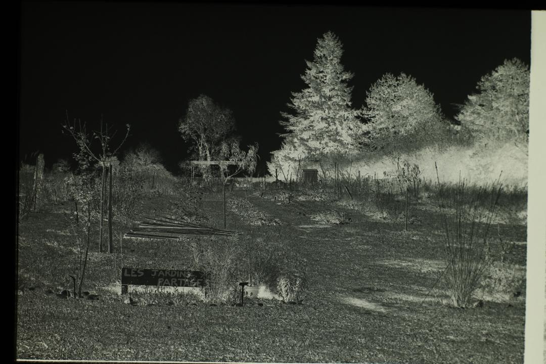

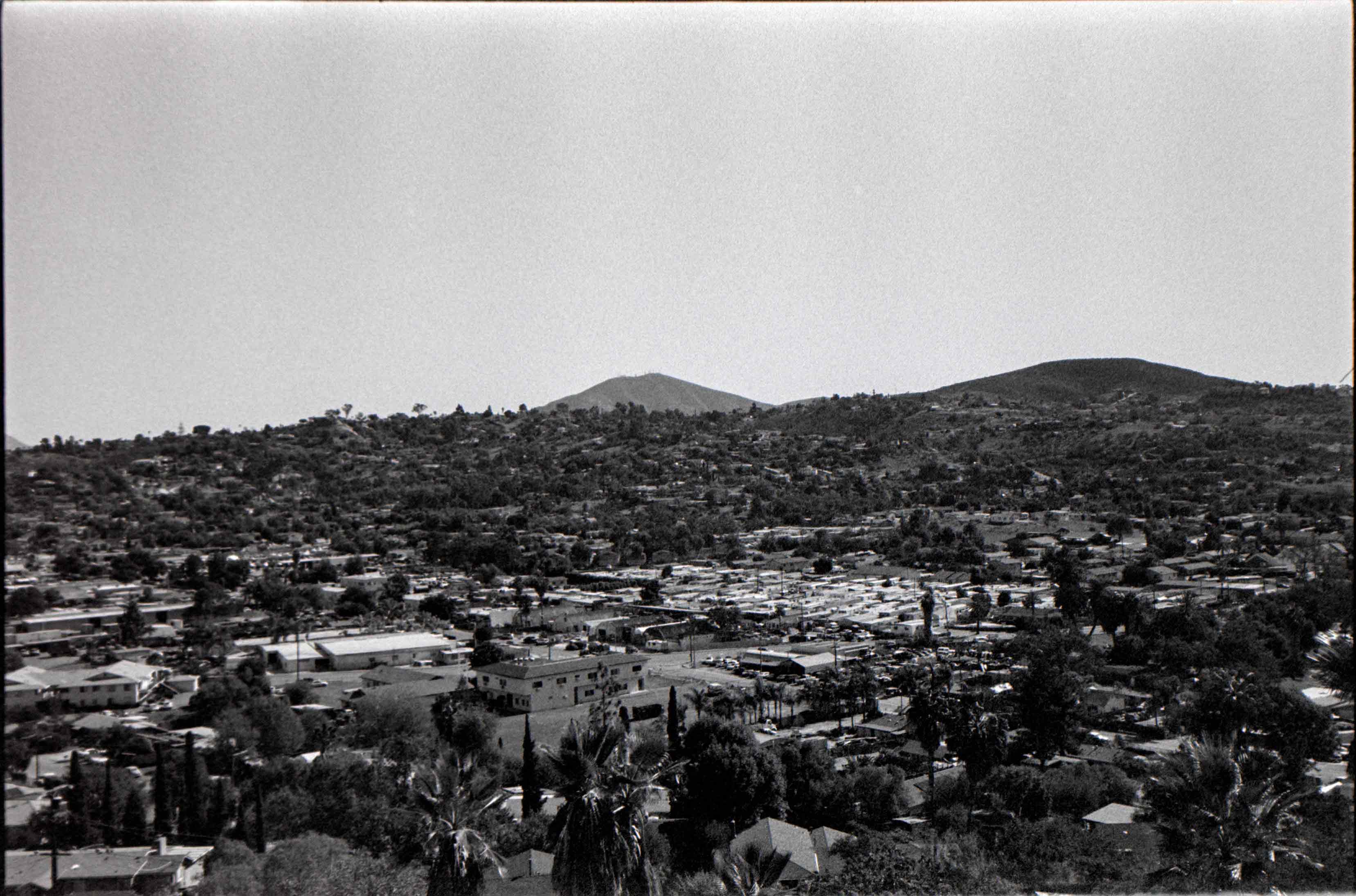

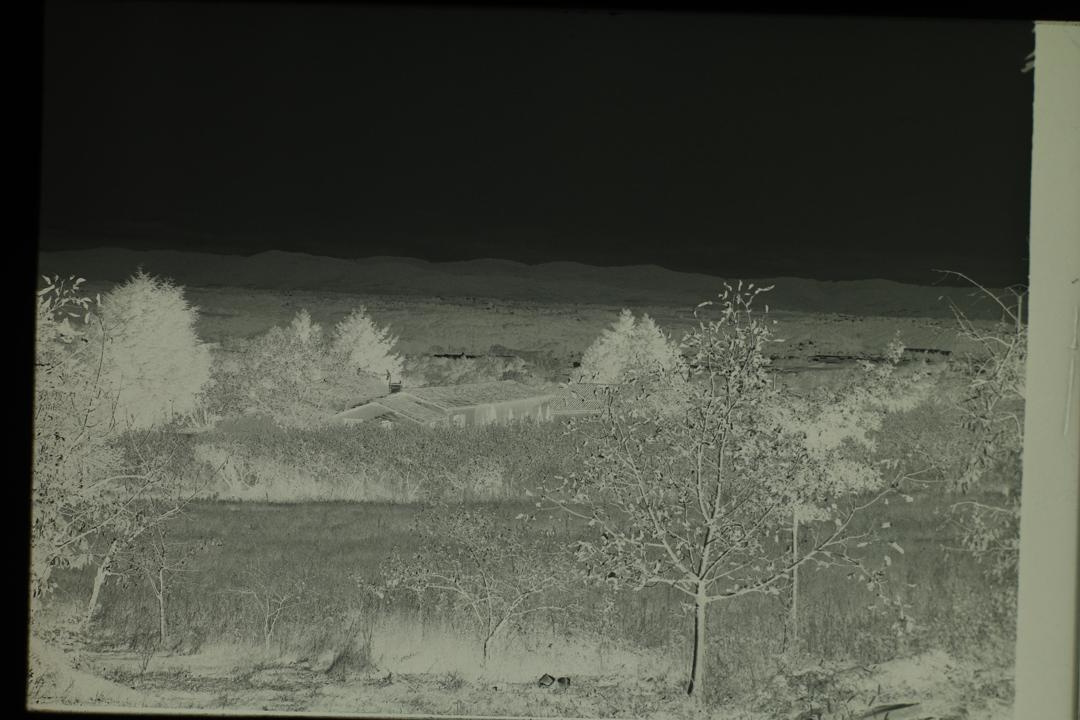

Yesterday, I spent the day running some tests and comparisons. I decided to eliminate some variables and start testing back from the beginning. I'm not a big fan of Patterson tanks (or any plastic tanks) and was just using those because it was the first things I grabbed. For this round of testing, I used my preferred steel Nikkor tanks and reels. Instead of using a multi-reel tank, I decided to also go with single reel tanks so that I could work with minimal solution volumes and see what was happening on a per roll basis.
I planned to test multiple things but wanted to start with what Sirius said in mind re: orientation of the sky portion of the film toward the bottom of the tank. From my previous tests, I was thinking that regardless of whether or not we're naming the issue as surging or bromide drag, it seemed fairly clear that there was a direction element to the artifacts so I wanted to know for sure if gravity was at play in dragging some kind of byproduct of development down from the sprocket holes into the image area. I tested by shooting two rolls of the same scene. Both were loaded onto the steel Nikkor reels and one was placed into a single-reel tank with the sky oriented toward the top of the tank as I'd done previously. This was a sort of control as I wanted to make sure I could reproduce the issue using these tanks. The other reel was placed into the other single-reel thank with the sky portion of the negatives oriented toward the bottom of the tank. Both tanks were processed at the same time, in the same chemistry (split between the two), under the same conditions, and agitated the same way (inversions with slight rotation). The same 1+119 dilution was used. The single reel tanks hold 300ml total solution each which comes to the same approximately 2.5ml of HC110 concentrate per roll in each single-reel tank.

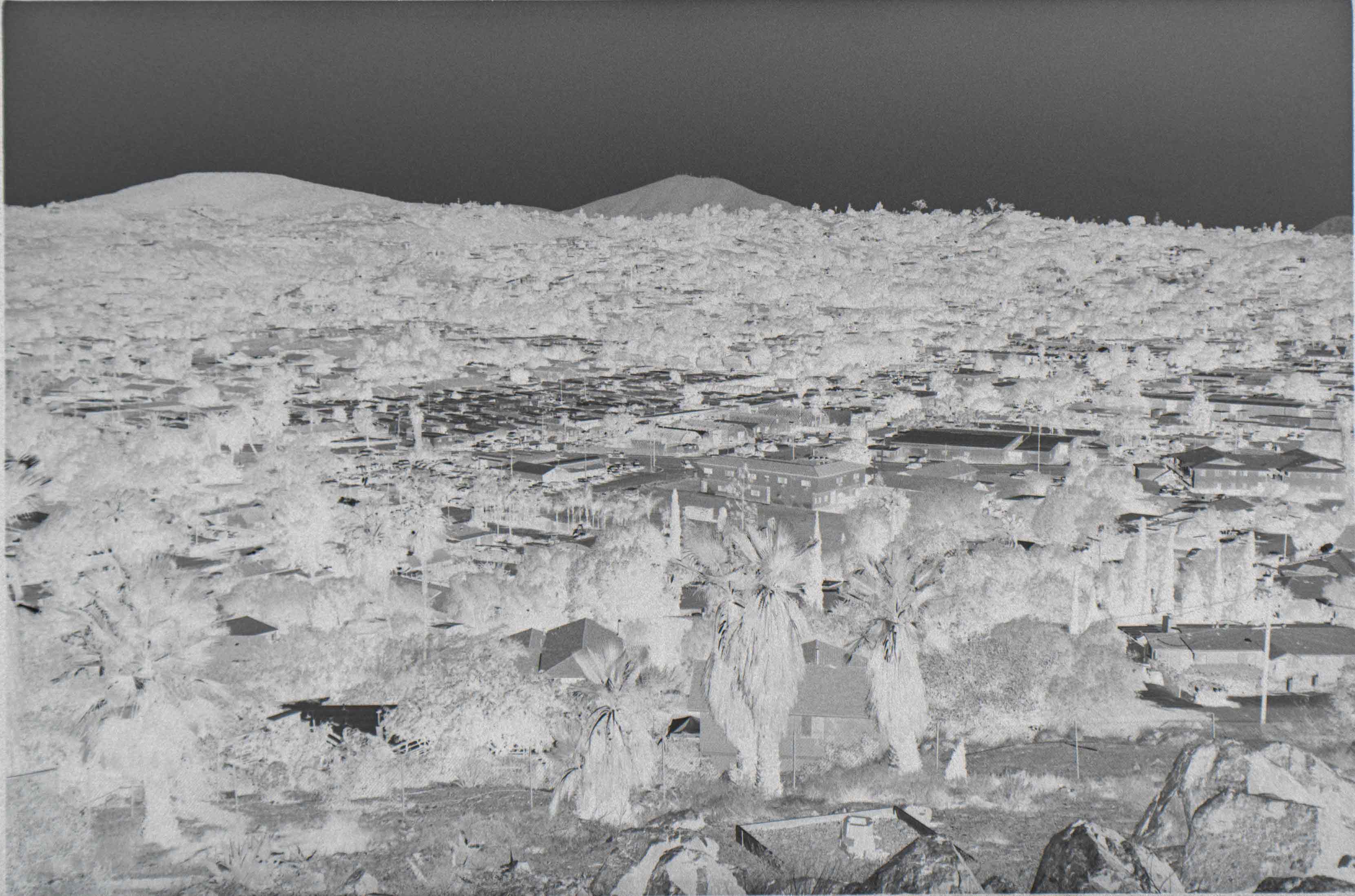

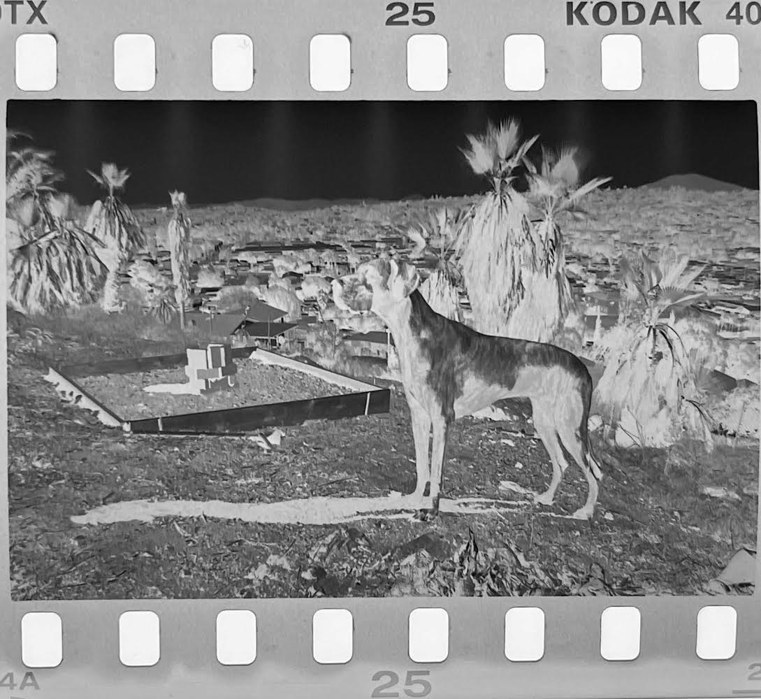

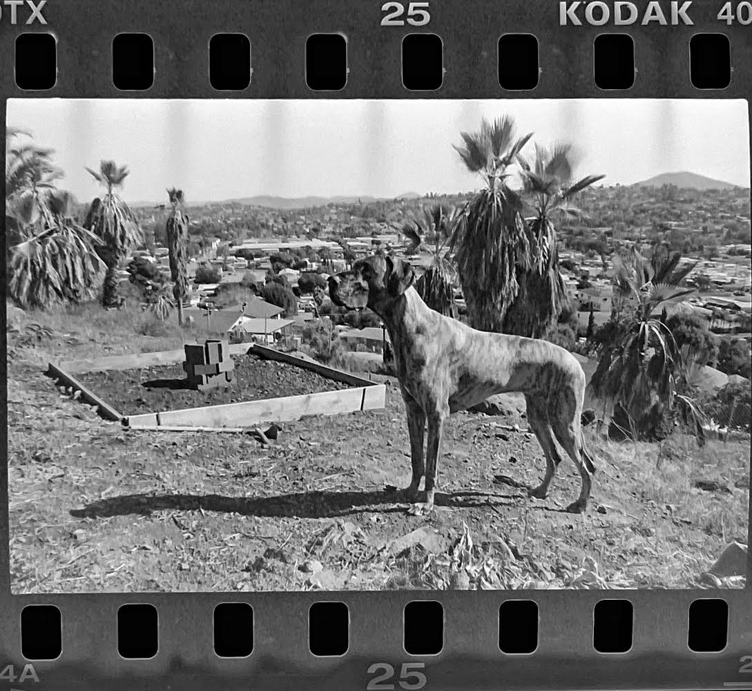

The first roll, with the sky toward the top (the control), albeit fait reproduced the uneven development emanating from the sprocket holes:
[Side note: I did higher quality scans of these tests instead of quick shots using my phone. My scanning setup doesn't scan sprocket holes which is why these are cropped. Images are straight scans with no editing beside basic tone and color balance.]

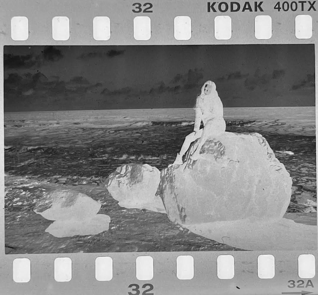

The second roll, with the sky oriented to the bottom of the tank, did not exhibit any uneven development in the sky or anywhere else on the negatives. The sky gradient is correct with no streaking and no signs of drag:
While inverting the orientation of the negatives in the tank surly doesn't eliminate whatever mechanism was causing the problem, it does provide a viable solution for preventing it from showing up under the conditions of my test. One remaining question is whether or not developing in a multi-reel tank with the film oriented with sky toward the bottom, if that might still cause a drag issue from the material dragging down from the top reels to the lower ones. I'm unsure if that would happen and will test it with less important rolls later.
Thanks to everyone who chimed in with helpful ideas. I'll most likely make a video to discuss the problem and the steps I took to resolve it. I'll follow up to share the link to that when it's done. Thanks again for the help.

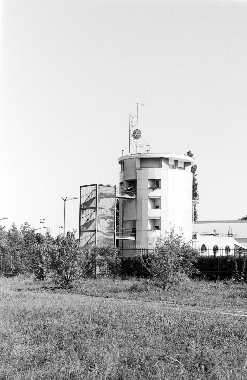

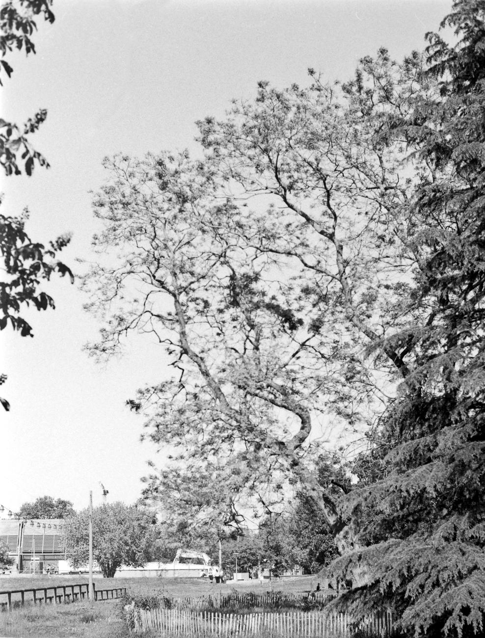

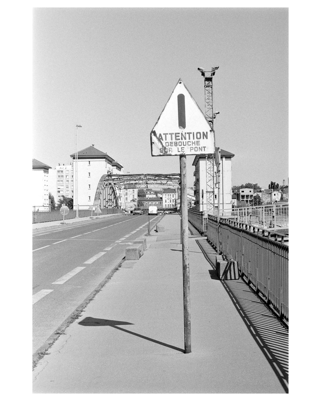

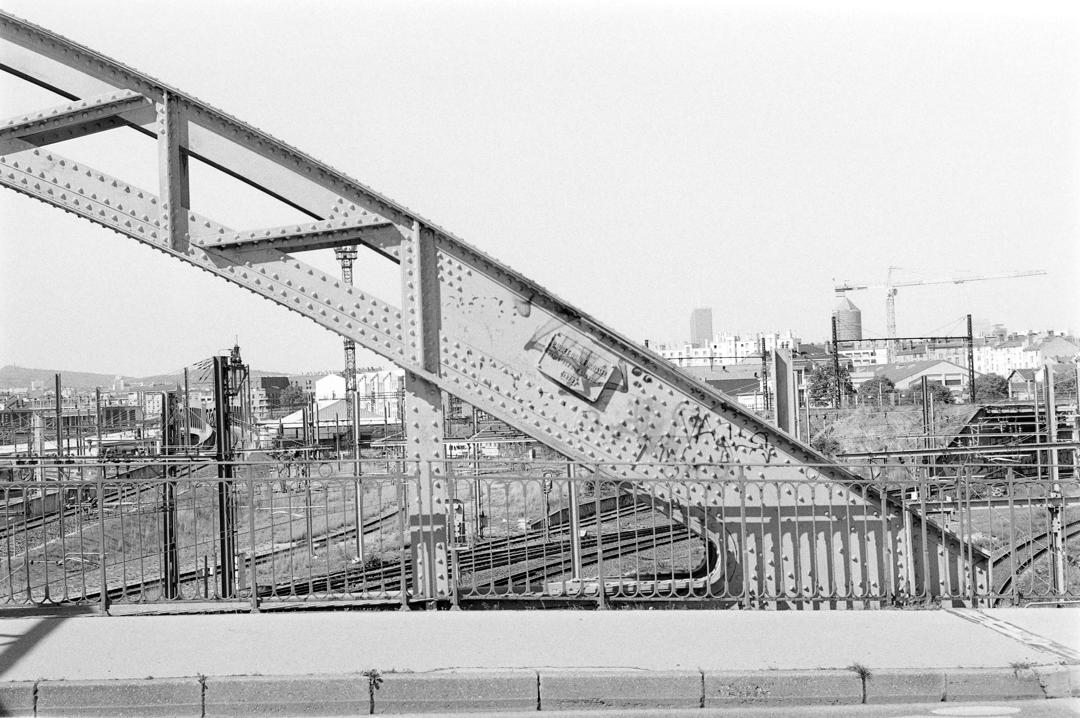

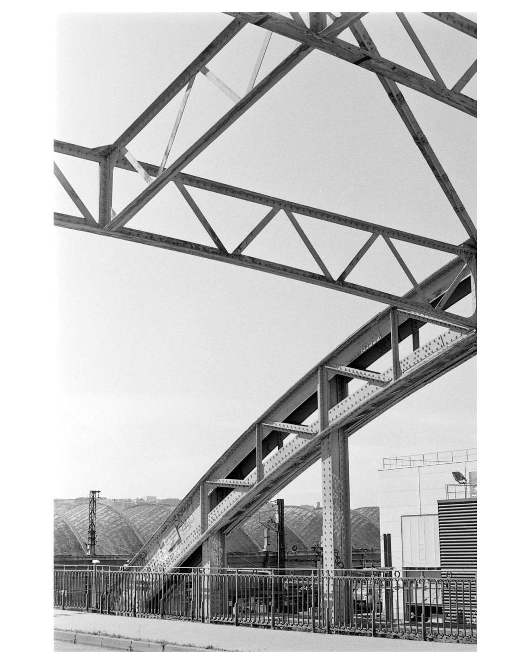

Agfaphoto APX 100, HC-119 (g) 1:119, 60min semi-stand 20°c
Same roll of APX 100, rodinal 1:100 60min semi-stand 20°c
Fomapan 100 (@100 or @80, don't recall), rodinal 1:100 60min semi-stand 20°c
HP5+ @400, rodinal 1:100 60min semi-stand 20°c : we can see some uneven development here on the last one
I don't do a lot of (semi) stand development, but 30s initial agitation AND 2 or 3 inversions at the 30min mark like you did in your first test usually worked to avoid the streaks in the sky. I use a 2-reel paterson plastick tank, but always with one single plastic reel in the tank.
I'd try using a single reel at the bottom of the tank, and adding 2 inversions at the 45min mark as a starting point. But it might take away the effects you like with stand, i don't know.
View attachment 322103 View attachment 322104 View attachment 322105
View attachment 322106 View attachment 322107 View attachment 322108
View attachment 322109 View attachment 322111 View attachment 322112
View attachment 322113 View attachment 322114

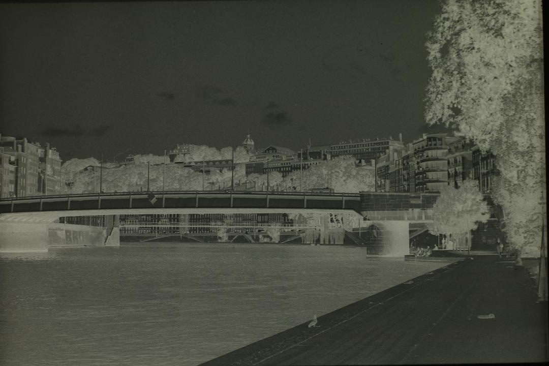

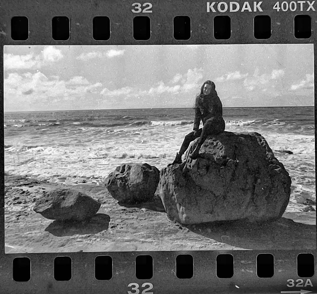

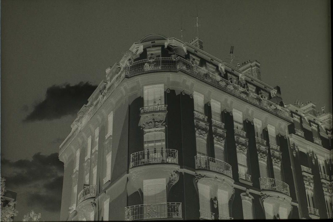

Posts about surge and bromide drag when using stand and semi-stand development come up fairly often, and I’ve read just about every thread on every forum that touches on both topics but I’m still at a bit of a loss.
Caveat: This isn’t an opening to have yet another discussion debating the merits of stand or semi-stand development. It’s a tool that works well when called for. I’ve used it for years and it works well for me. Regular time and temperature also works well. Just trying to solve this particular issue so let’s please stick to that.

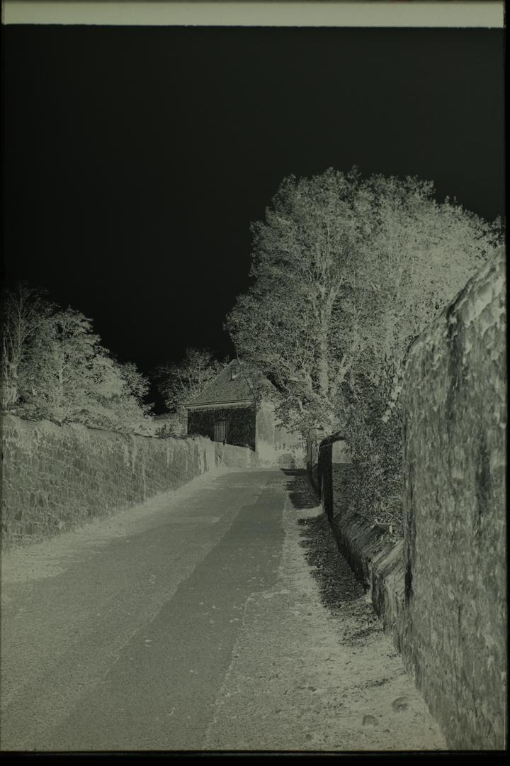

On to the problem. The following are all of the factors at play in how I’m developing. I’m including example test images to show the problem and how it changes based on changes in the development technique. Those are just quick iPhone photos from the negatives on a light table so ignore all the dust and stuff.
In the case of these negatives, I’m using semi-stand development (Tri-X in HC-110 1+119) in a Patterson tank with Patterson reels, I’m getting stripes in line with the sprocket holes in areas of continuous tone (mainly open skies). The strips are wider areas with greater density directly below the sprocket holes, and in between more narrow less developed stripes in line with the spaces between the sprocket holes. On the positive, they appear as lighter wide stripes between darker narrow stripes.
First, my understanding is that surging produces areas of greater density in line with sprocket holes on the negative so I’ve been thinking that’s what I have going on but I’m unsure and would like to confirm. Is this surging or bromide drag?
As mentioned, I’ve been reading everything I can find on this and common responses are that surging on 35mm occurs with too vignerons agitation causing an increase in fluid velocity through the sprocket holes resulting in greater development below them. In an attempt to resolve the issue I did a few tests.
Test 1: I agitated gently at the beginning of development by rotating and revolving the tank slowly and gently for three revolutions. Placed the tank down and tapped it to release any possible bubbles and then let sit for half of the development time. Then agitated with 3 gentle agitations using the same method previously mentioned then completed development by letting it sit. This reduced the stripes but did not eliminate them. Look in the sky:
Test 2: I then decided to try without agitation at the beginning of development and with the same 3 gentle rotating revolutions at the midpoint for agitation. I figured that maybe, if it’s in fact surging, the agitation at the beginning might have been the cause because the developer is at its strongest at the beginning. However, this test produced more pronounced stripes. Again, look in the sky. Also, ignore the bottom edge of the film in this example as that density difference is just because the film is still wet in this example:
In my reading, another common remark is about incomplete fixing with many people stating that semi-exhausted fixer could be the problem and with some respondents stating that upon re-fixing the stripes disappeared. Based on that, I made sure to use fresh fixer and I also re-fixed previous tests to see if the stripes cleared and they did not.
I’m now thinking that if it’s not surge marks and is instead bromide drag, my minimal agitation may not be frequent enough to eliminate the drag since the first test above with gentle agitation did reduce the artifacts but the test with no initial agitation produced more pronounced stripes. So now I’m considering a minimal agitation protocol based on what Sandy King and some others have described in previous threads. In methods like that, a few more frequent very gentle agitations are used progressively less frequently as development progresses.
If anyone can confirm what is actually happening in these negatives it would be very much appreciated and helpful as I get it resolved. Thanks very much in advance.
