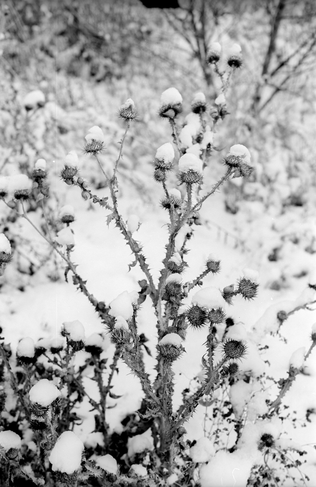

I bracketed the roll at EI 4, 8, and 16, then developed with the instructions for EI 10 (closest to 8 available) in the Adotech IV documentation. Namely, 22 degrees C, 30 seconds of gentle agitation up front, then the remaining 10 minutes giving 1/2 of a rotation to the tank every minute. 30 seconds of Kodak indicator stop bath, 45 seconds of TF-5, 5 minute wash.
Came out looking pretty bulletproof, I could tell straight off it was overdeveloped. When calibrating dev times for a film, I always shoot control frames at Zone I, Zone VI, Zone VII, and Zone VIII so I can see if I'm landing closest to N, N+1, or N+2, as well as evaluating film speed. These control frames showed that the development was higher contrast than N+2 by a bit, and even EI 16 was slower than I needed to be rating the film. But highlight separation is wretchedly bad, it looks like an orthochromatic film with open shadows and blank everything else. Chalk it up to way too much contrast.
I'm going to reduce development significantly for the next roll, probably 10 minutes at 20°C instead of 22°C. That matches their recommendation for EI 6. Probably bracket at 14, 16, 18 (half stops in either direction from 16) as well just to be safe, but I think I'm almost there.

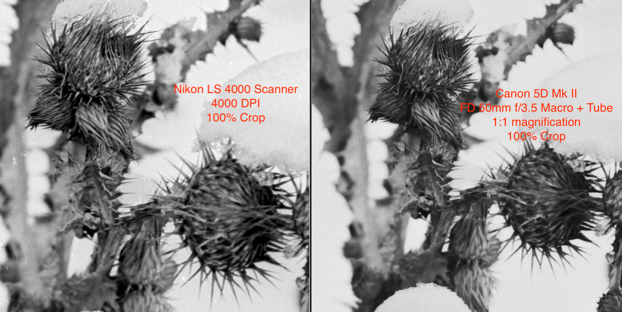

That said, the resolution of this film is pretty astonishing. It's defeating my Nikon LS 4000 scanner at 4000 DPI resolution (i.e., I believe there's more detail on the film than the scanner can capture). I've never bothered to exceed 2000 DPI with that scanner for any other film, including Delta 100, since it seems to just bloat filesize without increasing actual resolution meaningfully.
So I tried my hand at DSLR scanning with my 5D Mk II and an adapted 50mm f/3.5 Macro lens + tube to get to 1:1 magnification. Shot at f/11. It's not any better than the scanner, though whether that's because I've maxed out my sensor or because I'm not good at DSLR scanning, we'll see. Even in the areas that are extremely dense, there's virtually no grain to be found.
I don't usually scan my negatives anyway, so I think I'll try setting Grade 00, and printing the highest magnification I can get out of my Beseler 45MXT + 50mm EL Nikkor lens. Just an 8x10-sized cropped area of the biggest enlargement size I can produce without projecting onto the wall. Maybe I'll scan that and compare it to the negative scans.
