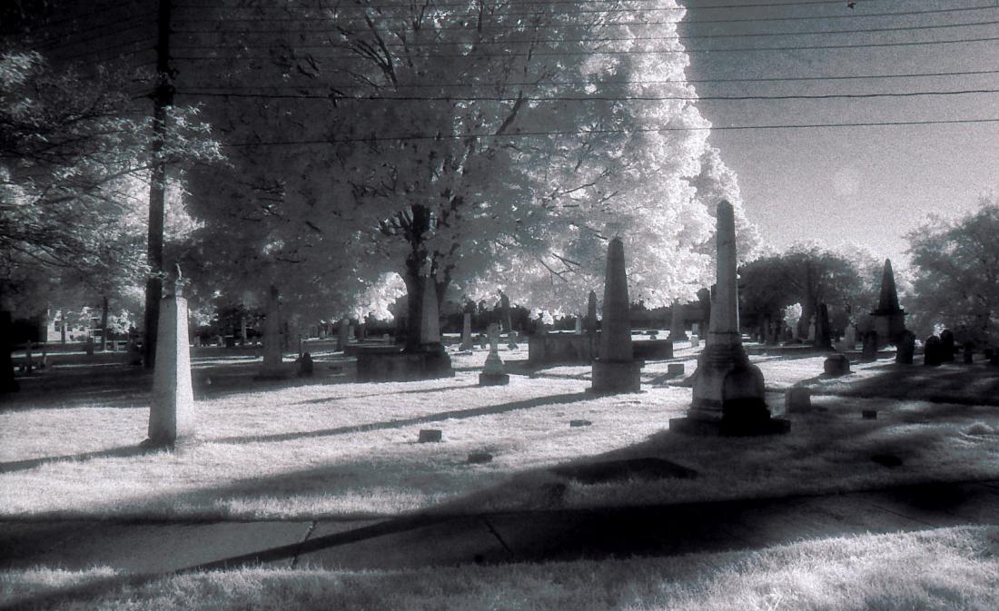

Infrared & gel filters.
I took a tip from a local pro shooter and cut my Ilford gel filter to fit between the film rails of a Nikon FE2.Held the altered filter in place with a wee bit of tape.
No problem metering as the lens is unblocked.This was taken with Kodak HIE,ISO 12,Ilford Infrared gel filter.

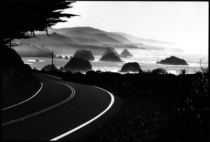

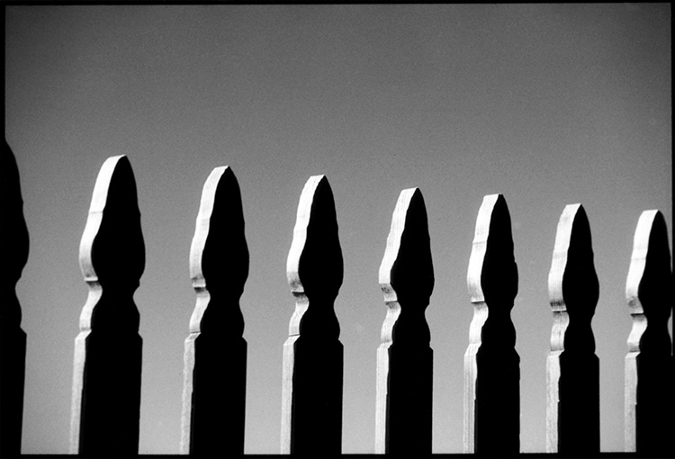

Hi, SFX with Red 25 filter also gives nice effects, without over the top foliage effects. These were all taken with in-camera metering.
Jon

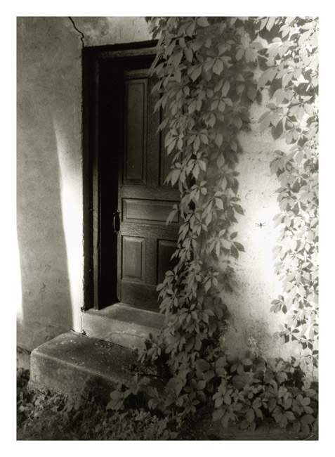

Jon, those are really nice prints. They remind me of some of Gilpin's work along the California coast, especially the last of the three. I've had really good luck with a red filter too. Attached file is 35mm SFX with a red 25 filter, developed in Rodinal, printed on Ilford MGWT using A-130 developer.
