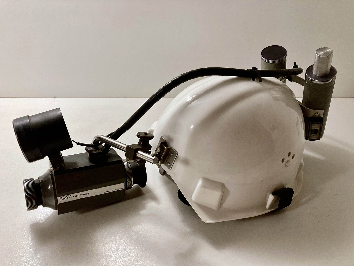

Several people have mentioned IR viewers, but whenever I go look them up, the particular model mentioned is no longer available. Has anyone bought one of these recently that they can recommend?
I got mine used from the AGFA-Gevaert Mortsel factory (end '80s), I think that the best way to find one is on the used market.
Mine is US made, and if I am not mistaking the manufacturer, FJW Industries, is still in business.
The mounting on the construction site helmet is DIY...

I just looked at the IR video from post 18. It helped him to see what he was doing; but it also illustrated exactly how not to handle film.
Sorry this comment is off-topic for the thread.
I agree, this was just me demonstrating the goggles. Handle by the edges or wear cotton gloves 😊
Kodak offered IR viewers in their professional products catalogs back in the day. You have a great setup there!!

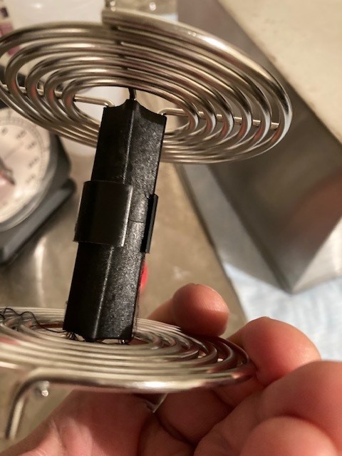

My order with an AP reel and a Jobo reel arrived today.
The AP reel is like magic. The wide flanges make loading 120 film easy. I was able to load a practice roll in the dark the very first time. Much easier to get the film engaged in the reel compared to the Paterson reels, and after that the film loads by cranking the two halves of the reel back and forth just like the Paterson reels.
I found the Jobo reel, on the other hand, much harder to load than the Paterson reel. Its flanges are even smaller and harder to find in the dark and get the film under it. And the Jobo doesn't have the ball bearings the other two reels do that allow the film to advance in only one direction. With the Jobo you need to do that function with your fingers, and I found it unnatural.
I strongly recommend the AP reels to anyone looking for an easy to load reel for 120 film (and 35mm is even easier to load with these reels). Forget Paterson and Jobo and get this reel.
I really like the AP reels as well - Paterson tanks work well with the AP reels. One word of caution about the AP reels - one of mine was a little bent when I got it; the top and bottom parts of the flange on one side were too close together. This caused one roll of film to get a longitudinal scratch from the loading process. I was able to fix the gap by bending the two parts of the flange apart a little so it no longer happens - now it's fine and has done many rolls with no issues.
Thanks for the heads-up. I checked mine and it doesn't seem to have that problem. The proof will be in the pudding this weekend when I develop my first roll of film using this reel.
