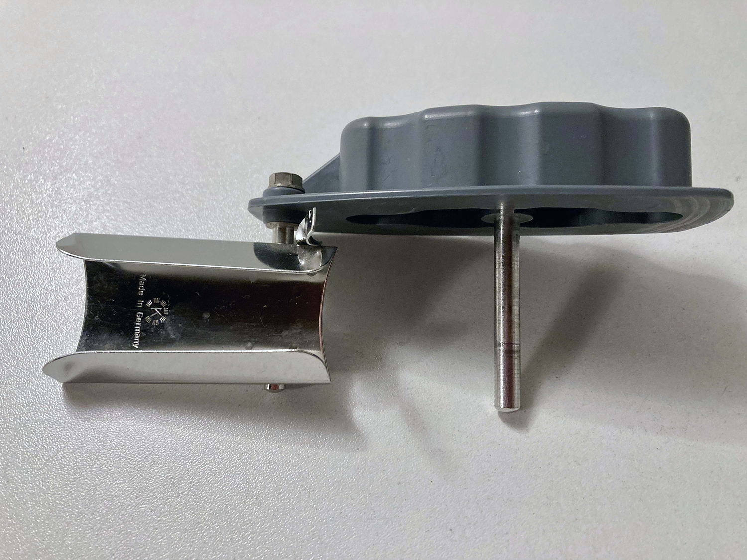

Kindermann has the answer...
BTW, Eugene Smith managed to wind TWO 35mm films backwards on one reel, I have never understood how he did it!
