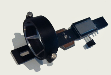

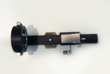

Here is what I had made {phone images}
http://www.jeffreyglasser.com/
It was still on the site. Here it is. The collar is tapered to fit the lens accurately. The parts are in slots so it is adjustable and reduced the cost of fabrication as well as not having to leave a delicate piece of equipment at a grundgy shop.
photo-1-jpg.203870
photo-2-jpg.203871
