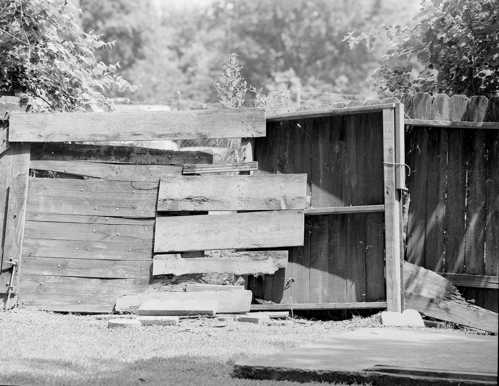

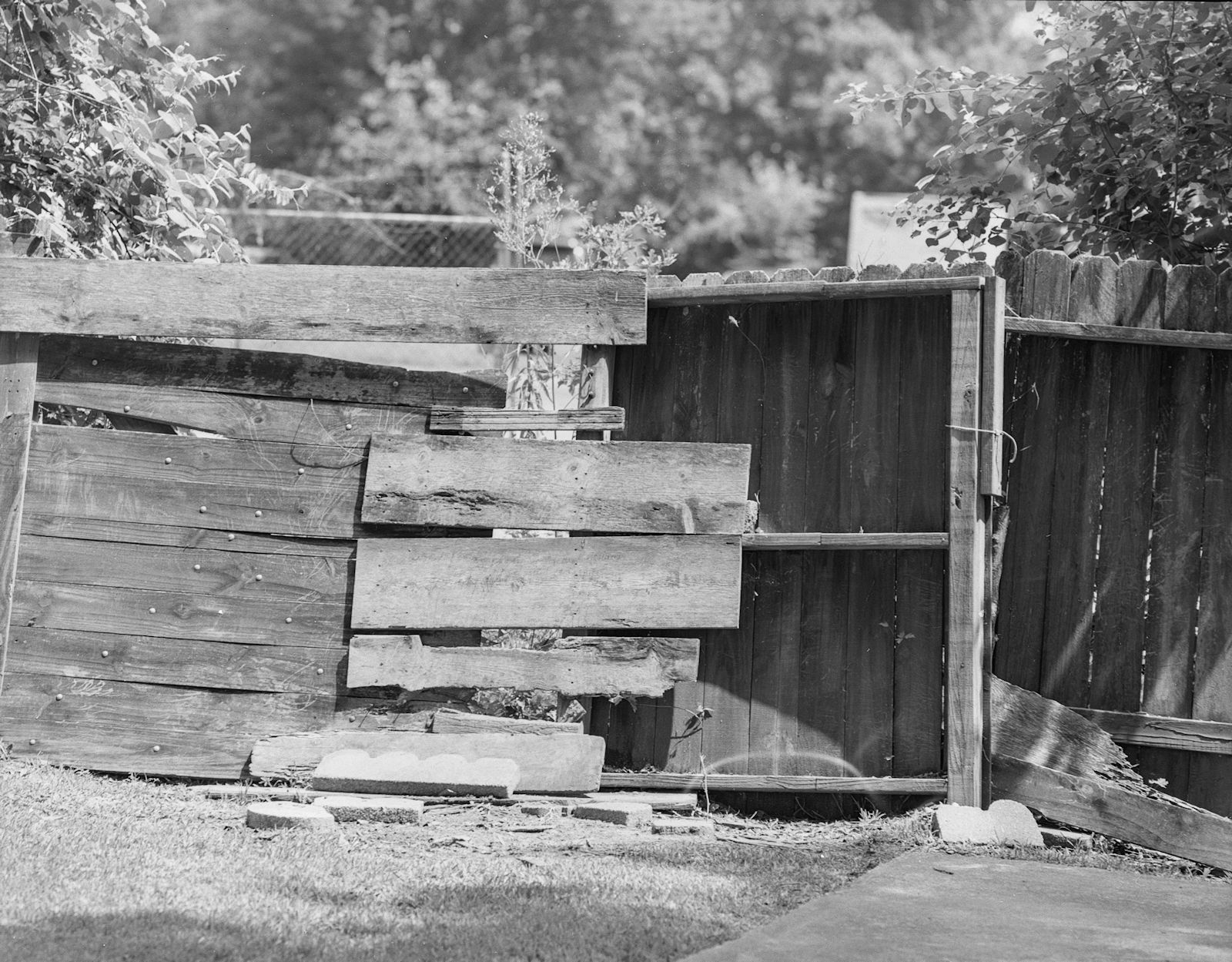

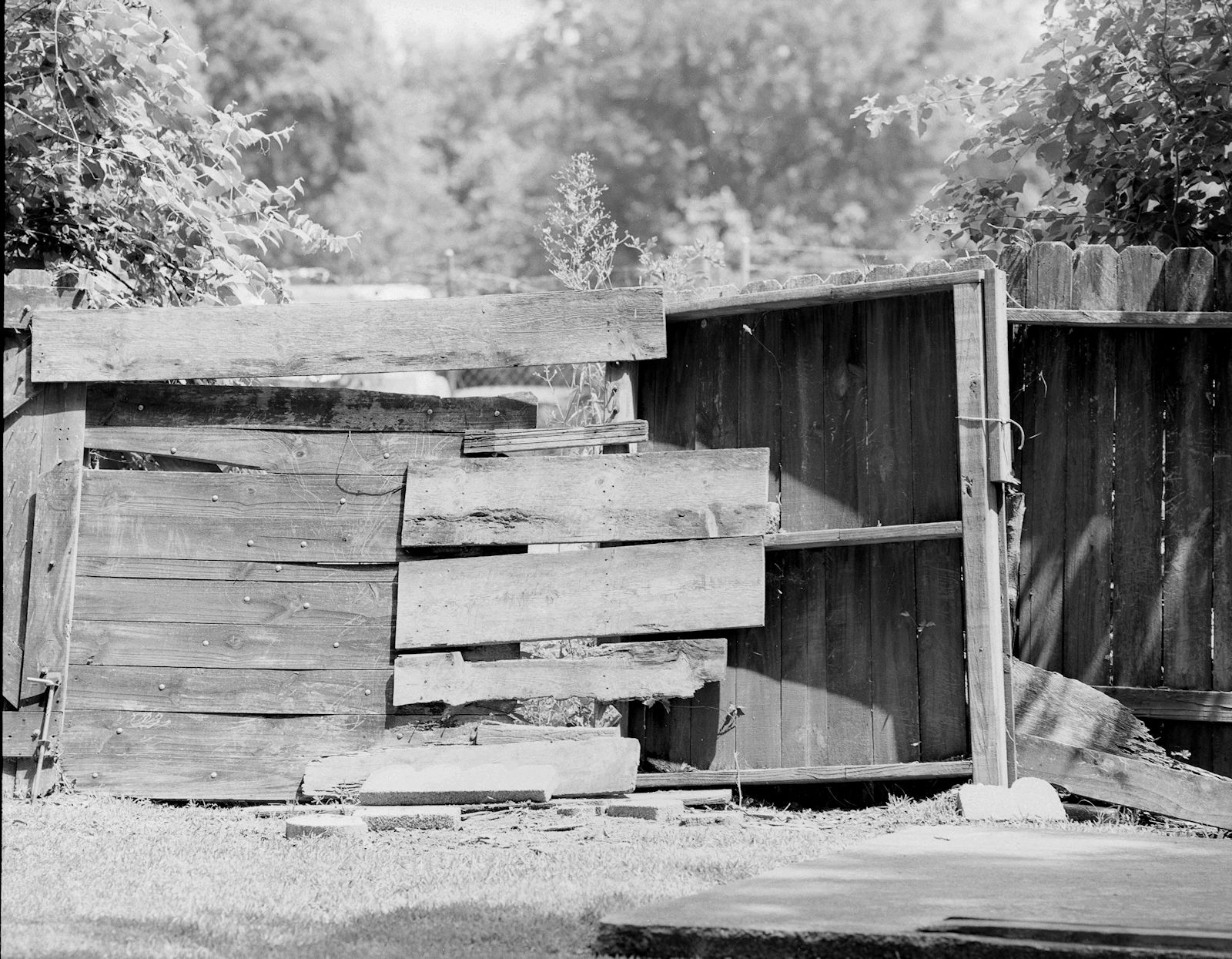

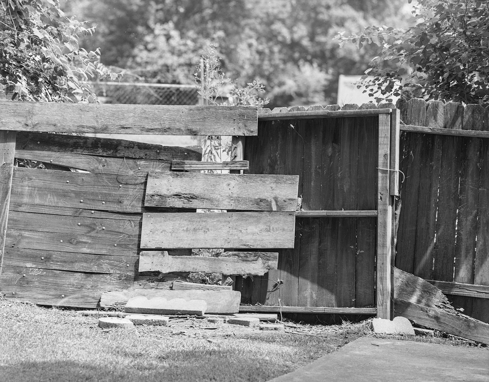

Well, it took longer than I thought, mostly due to issues pertaining to my darkroom situation, but they're worked out now, and although this thread has cooled, I do have some results to offer up to the group. I shot a roll of T-Max 100, developed in D-76, then I shot duplicates of the negatives with my 24.3mp d*****l. I did a minimum of post processing of each shot, just enough to make the photos reasonably presentable.
About my 300mm lens, it's been a while since I've had it out of the bag and I had confused it with my 200mm, which is a late model. The 300mm I have is an earlier model, not sure exactly when it was made. It has a rubberized focusing collar, but the collar's nibs are more finely textured than those on my 200mm. It came with a bayonet-style metal Asahi Pentax front cap.
As for the photos, I shot a group from f/8 to f/16 on one tripod and f/8 to f/11 on the other before I ran out of film. At each aperture setting I took a shot with and without mirror lock up. At f/8 there was a moderate amount of background blur, but it was enough to give the photos a noticeable 3-D effect, which I quite like. I will restrict the photos I show here to the ones I shot at f/8.
The two tripods I used were a set of Bogen 3021 legs with a large, no-name ball head, and a Majestic Model H-120 with a top plate the measures 5-3/4" x 7". It has a crank that operates a very smooth tilt function.
Pentax 67, 300mm f/4 @ f/8, 1/30 second. T-Max 100 developed in D-76. Bogen 3021 legs, no-name ball head.
Ditto above, with MLU engaged.
Pentax 67, 300mm f/4 @ f/8, 1/30 second. T-Max 100 developed in D-76. Majestic H-120 tripod.
Results: I found the images using both the Bogen and the Majestic to be quite acceptable. There was the smallest amount of blur with some twigs in some of the photos, but I can't be certain it wasn't the wind causing the blur, and it wasn't consistent. There was no appreciable difference between the shots with the Bogen and those with the much more massive Majestic.There was also little, if any, difference between shots where the mirror was locked up and where it was free to slap happily away.
The exposures could have been better. I used the Pentax's internal meter. I should have at least double-checked it with one of my hand-held meters.

Thanks for doing that and posting your results. It's interesting that you noticed little difference when using mirror lock up and not using it. Earlier this week I took a series of night shots with a 90mm. I realised that at one of the exposures (4 secs) I had forgotten to lock the mirror up so I retook with the mirror locked up. There is no difference at all between the two 4 second exposures, both are tack sharp.

Hard to discern details over the web, but every one of those shots looks miserably unsharp to me. I'd like to be able to count the legs on a spider on one of those boards, at least where things are in focus. You don't get much depth of field with a 300. Or maybe you just have a scanning issue. Even the older 300's are capable of far better performance than that. But you're going to need much more serious tripod support to do it right.
