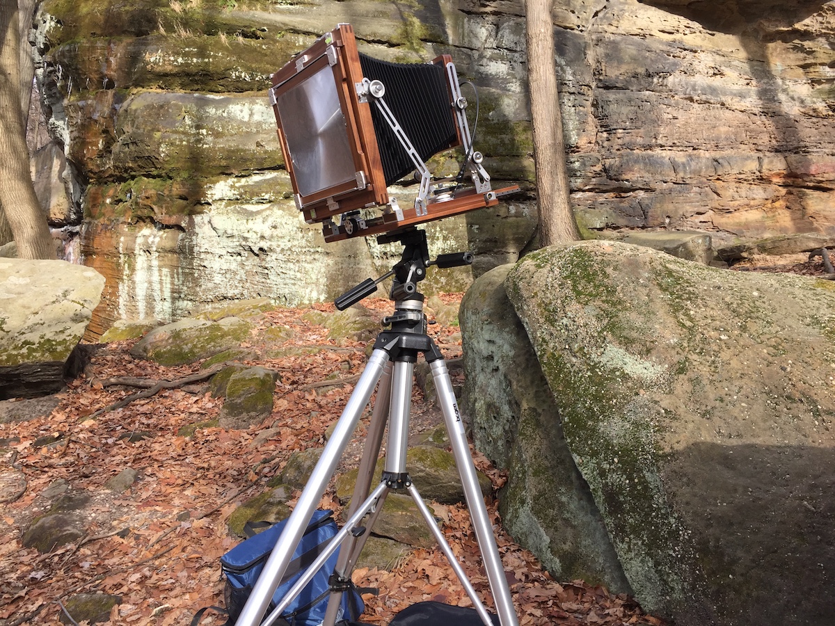

There were and are plates appropriate for larger cameras. Previously Kirk Enterprises offered one 4-inches square, which is affixed to my 8x10 in the image in this post:

The statics and dynamics courses in my college engineering curriculum imparted well more than a basic understanding of those factors. And, one post above yours, there's a link to to a picture of my utterly stable 8x10 Phillips / Gitzo 3-series / Burzynski ball head combination.
