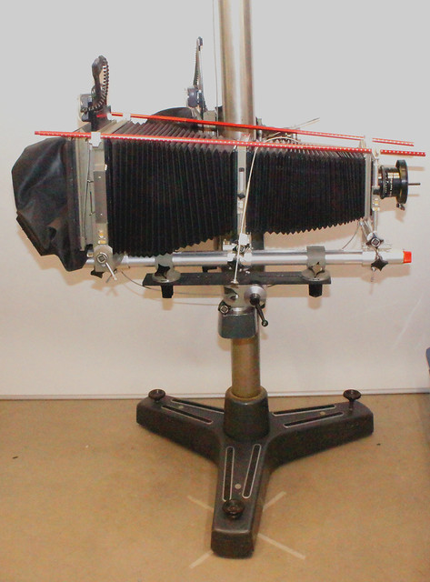

That leaves out almost everything, except the cast iron studio stand. Isn’t the Manfrotto aluminum?
I’ve used an old heavy Manfrotto in both studio and field fir a 4x5 monorail. It works quite well but is heavy. My biggest complaint now is the weight. My biggest complaint in the past was cleaning the dust, dirt, and mud from all of the crevices.
Before you said both field and studio I was going to suggest the Linhof R Stativ. It’s amazingly stable and has no trouble supporting my Linhof Color 8x10 which is a beast. But it isn’t much for the field- bulky and heavy.
