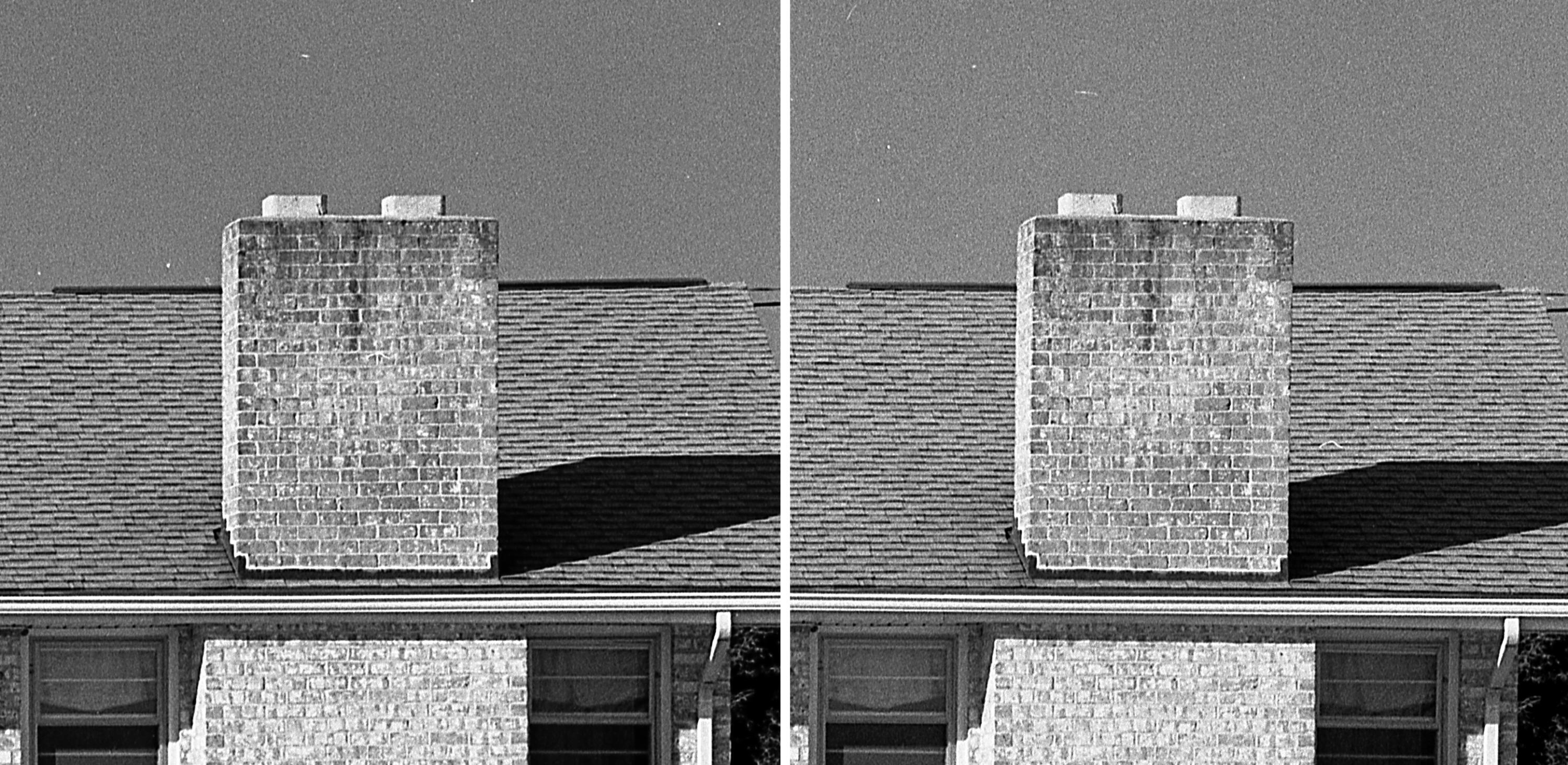

Here are films scans. Again, not much difference IMO as far as grain. Most think HP5 is grainier, as I always have. The Tri-x is on the left, HP5 on the right. They are 3200dpi scans of the chimney from frame #11. Scanned on an Epson V600.
I couldn't see any difference worth talking about. Heck, they look like the same negative, scanned with different dust.
My gut reaction was that things look rather muddy here too. If the negs are underexposed or underdeveloped, might that not influence our reading of the similarities and differences between the two films? Or do folks feel that these contact sheets are pretty much perfect?

Those contact sheets are dark and muddy looking. They really don't tell us anything. Enlarge some of the photos with the correct print exposure and contrast to make each individually look its best. I like both films, but they're not the same.
After looking at the scans I´m even more surprised. When the new 400TX was released some 10 years ago many people claimed that the grain was much finer than before. At this resolution, I had expected it to be visibly finer than HP5+ but now I cannot make out any difference.
Blind wet print test @ 16x20... might be different.
eg as scanning may be masking differences.
I agree. However when I look at the negs through a loupe HP5 still looks a little grainier. It may be a different story with optical printing since scanners pick up grain like crazy. I might wet print that same section of chimney on 8x10 paper an scan the prints. That would be a better test.
Great!
I think there is some contrast enhancement in the scan, which could obscure some of the subtler differences.
Otherwise, I still see a fraction more contrast in the left scan.
Gran is impossible to call, especially as the films were't developed exactly the same.

Brian, how about exposing at box speed so that the test is actually meaningful? Not using box speed is muddying the waters with muddy scans.

This is exactly what I was trying to show. They are more similar than I ever thought. This was a surprise to me. I kind of regret posting this now. I'm sorry to those whose time I wasted, but maybe some APUGers out there will find this of benefit when debating over film similarities and differences.
Don't be. I found your test useful. I have debated moving from TriX to HP5, and recently bought my first 100 ft. of HP5. Your test reinforces the need for me to learn how to use the tool of HP5 with a scanner. Thanks!
