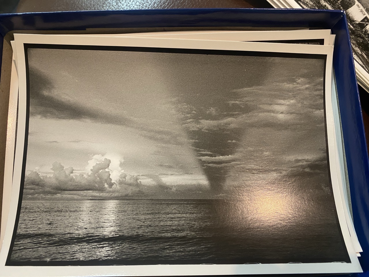

Bought xtol and developed one roll from that beach vacation in 1+2 dilution for 15mins. 5sec agitation every 30sec.
  • Much easier to print negatives
  • No. 3 filter on fomabrom in Neutol gave me results I like.
  • MUCH less noticeable grain in the sky.
Definitely a different overall look and feel to the prints.
Pic of print to follow after work.

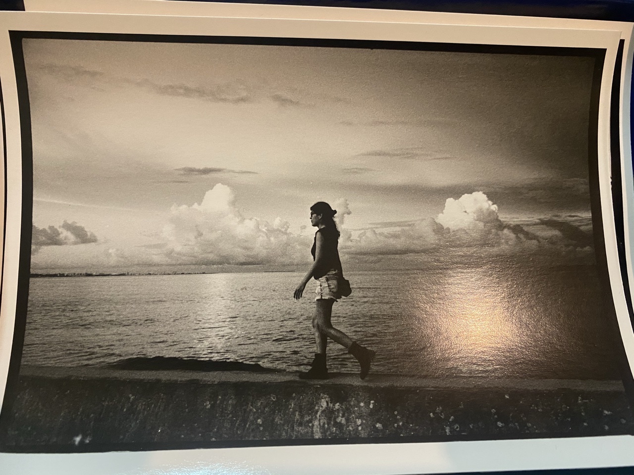

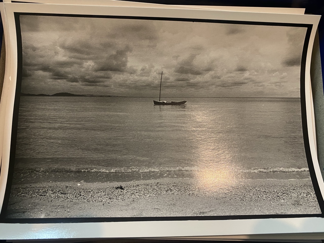

Bad result. Tri-X 2 stops under in rodinal 1+50. Grey part of the sky is horribly grainy.
OK result also in rodinal. Same roll as above. Sky still acceptable. It seems to be only certain tones of grey that really exaggerate grain.
Good result. Tri-X 2 stops under developed in xtol 1+2.
@ericdan What do you mean by "2 stops under" ?
I cannot spot any difference between the prints, looks pretty same to me..
We see this the same way. Different scenes make it a bit harde to compare, but overall look does appear quite close, and certainly as presented there are no dramatic differences.
I think some of the subconscious reactions to Rodinal come from reading comments on its performance before giving it a chance. Placebo approach would have likely taken Rodinal feelings in a different or at least more balanced direction.
I mean the film is underexposed two stops. Sorry about that. The grain is really visible in the grey part of the sky on the first print above.
I guess it’s not as obvious on these digital photos of the prints. Holding them in your hands you can really tell the difference. I’ve used rodinal like this for at least a hundred rolls. I usually don’t mind the grain. It’s just in open skies with little detail that you really see it. I guess this also shows that you can get decent prints even two stops underexposed and developed in rodinal.
So you pushed Tri-X to 1600 with Rodinal? Isn't that a winner combo for maximizing the grain?
