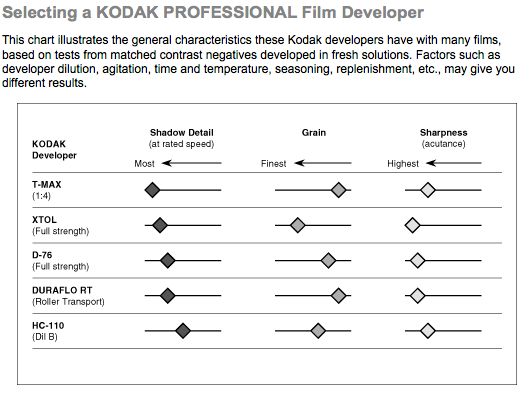

Rodinal isn't as sharp as D-76, let alone Xtol etc. It produces more visible granularity, which people mistake for making things apparently sharper, but it's really just adding fine detail destroying noise. I wouldn't go round adding silver solvents/ other developers to Rodinal, all you're going to end up with is a half-assed version of something better designed to deliver fine grain. Xtol, D-76, D-23, Perceptol are all capable of doing the job just fine - as is adjusting your exposure and development regime. 5x7 is not a significant enlargement & you should be able to get Rodinal to look more than OK at that size. Essentially your exposure needs to go up a bit & your processing time needs to go down (potentially quite a bit). Dilute Perceptol (1+2 or 1+3) delivers a pretty good balance of granularity and sharpness if you want to go down that route.

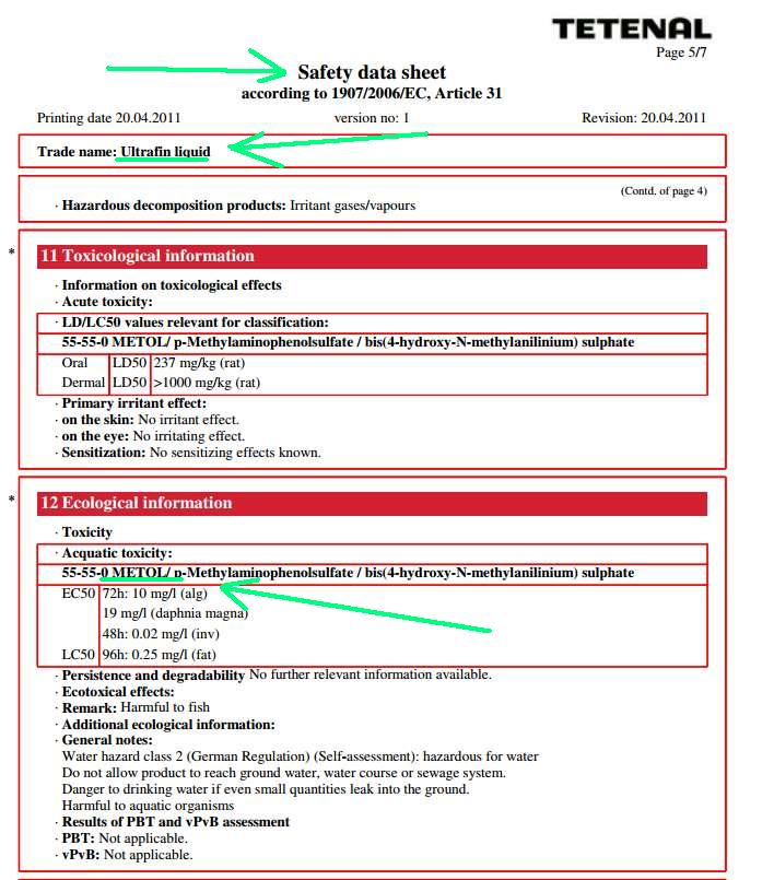

The MSDS you are showing are misleading (so are Tetenal names at times) Ultrafin Liquid is not TT Ultrafin Plus (TT Ultrafin Plus was discontinued a couple of years ago and replaced by TT Ultrafin T-Plus. It was a fairly standard Dimezone-S/ Hydroquinone dev.)
Exactly, it's not difficult to find out what the current T-grain aimed developer from Tetenal is - and what its composition is. I also would not be surprised if Tetenal's work manufacturing for Ilford & Kodak had given them insight into the best current thinking on optimal developer composition. As for the claims upthread, Ultrafin Liquid actually suggests 3 active developer ingredients - Metol, HQ and Phenidone A.

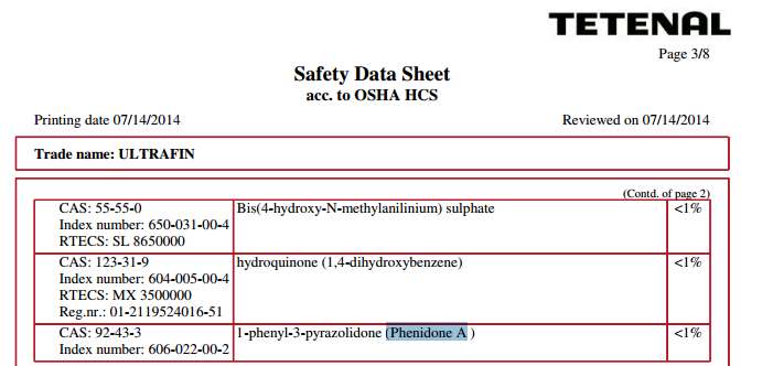

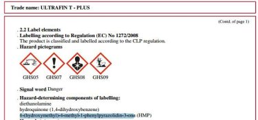

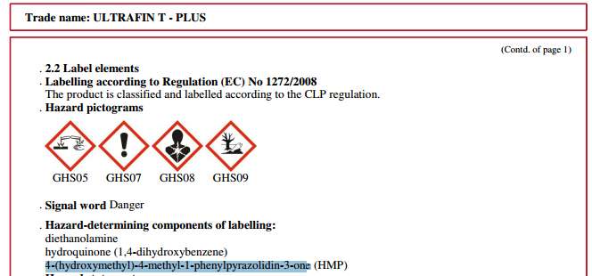

Yes, you ar right, the Ultrafin T-Plus uses Dimezone
While the Tetenal Ultrafin Film Developer uses Phenidone A

I cannot find Metol in the 2 of the 3 current MSDS Ultrafin sheets... https://www.freestylephoto.biz/msds/134-Tetenal
Metol is CAS: 55-55-0. It's still in the Ultrafin MSDS, not Plus or T-Plus. The now withdrawn Ultrafin Plus looks like a T-Max style non/ low aqueous content developer, for those that care.
