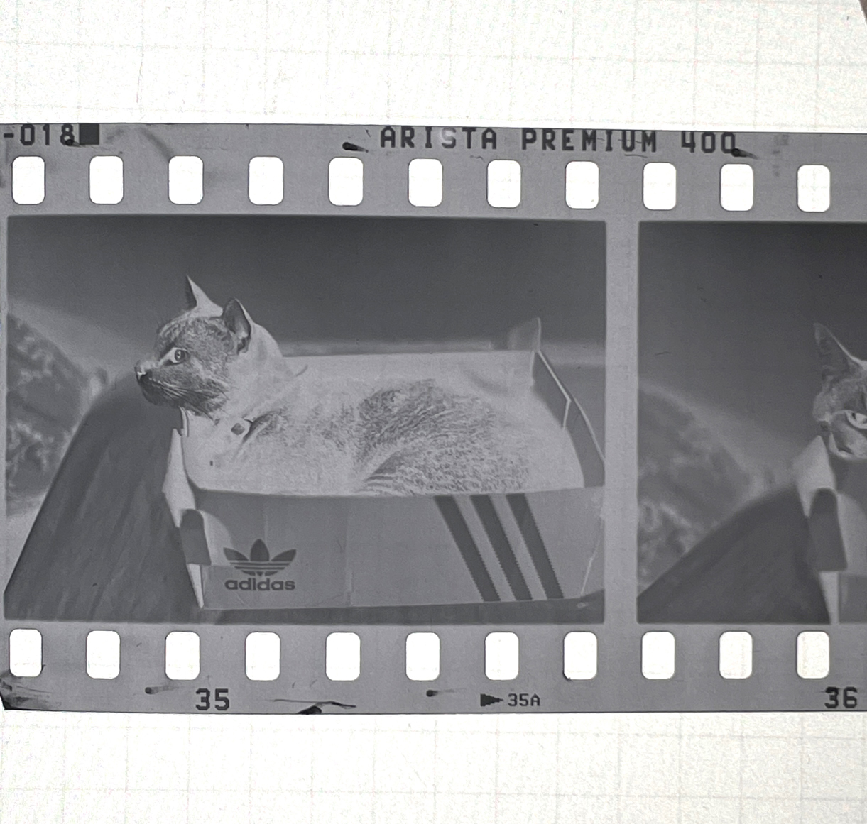

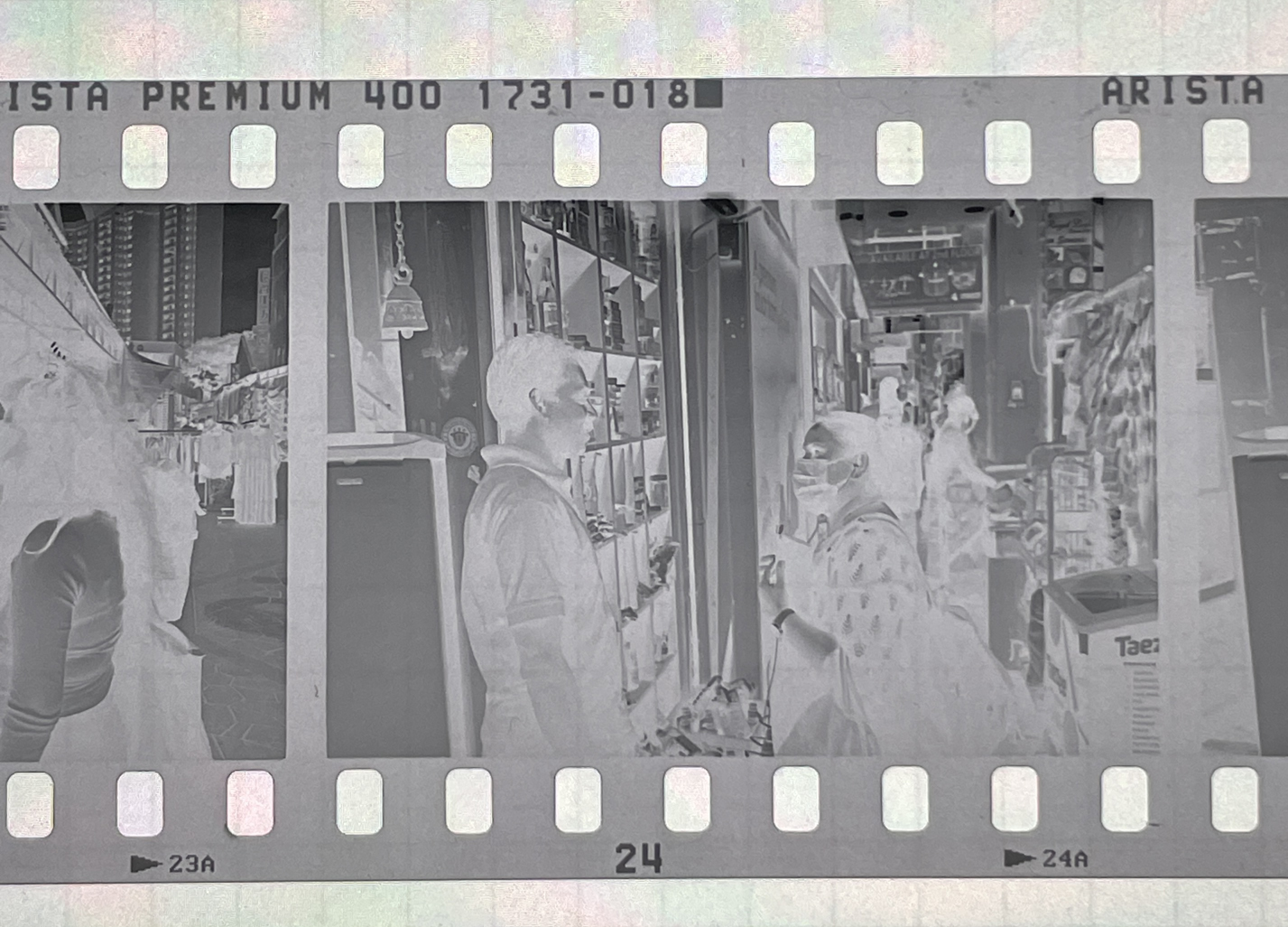

Last night (we are in different time zone btw) while I was reading all the above posts, I was trying out my first stand development.
Film: old ARISTA Premium 400 (long expired but cold-stored in fridge so still good). Shot at ASA1600.
R09 (1:100) I made 505ml but poured in only about 400ml (think this is a mistake.)
Normal agitation for first 4 min then sit for 50 min. (I just use this as a starting point and see how the result is like... )
I used ice cubes to try and maintain the temperature to be around 20 degree C. (probably around 20-22 during the whole duration.)
Result: I don't know how to describe, so link two scans here for comment. (feel really bad about all the dust spots on the neg. I definitely need to work on that department.)
I kinda like the grains and the contrast but shadow details could be better. (I think maybe 50 min is too short? or 4ml of R09 is too little? )
Anyway, it is a fun experiment for me. Seeing that I could shoot a picture of my beloved cat in so dim lighting at ASA1600 and his eye appears so clearly in the final image is just sooo good. I aim to get better result the next time. Wish me luck.

Even at the higher dilutions, R09 is still showing strong grain and less detail in the highlights and shadow. I like it as a developer because it does bring out the grain. Currently, like many of us, I'm waiting on Adox Rodinal to come back in stock and have the opportunity to compare it to R09. Thanks for the examples and keep experimenting!
Those look like under-exposed negatives - which of course they are, if you metered at 1600.
The stand approach has held the highlights back a bit, which in this case is good, but the level of fog is rather high.
It won't do you any good to extend the time. Whether or not you are using a reduced agitation scheme, lengthening the time does very little to increase detail in the shadows.
