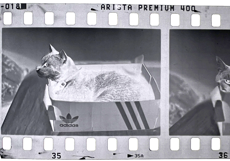

Last night (we are in different time zone btw) while I was reading all the above posts, I was trying out my first stand development.
Film: old ARISTA Premium 400 (long expired but cold-stored in fridge so still good). Shot at ASA1600.
R09 (1:100) I made 505ml but poured in only about 400ml (think this is a mistake.)
Normal agitation for first 4 min then sit for 50 min. (I just use this as a starting point and see how the result is like... )
I used ice cubes to try and maintain the temperature to be around 20 degree C. (probably around 20-22 during the whole duration.)
Result: I don't know how to describe, so link two scans here for comment. (feel really bad about all the dust spots on the neg. I definitely need to work on that department.)
I kinda like the grains and the contrast but shadow details could be better. (I think maybe 50 min is too short? or 4ml of R09 is too little? )
Anyway, it is a fun experiment for me. Seeing that I could shoot a picture of my beloved cat in so dim lighting at ASA1600 and his eye appears so clearly in the final image is just sooo good. I aim to get better result the next time. Wish me luck.
So if I have understood what you have said correctly, yossi, this is effectively Foma 400 expired film. shot at 1600 in low light and stand developed except that you used normal agitation for the first 4 mins but he rest was no agitation at all for the next 50 mins.
Frankly these 2 shots look great, especially the one of the cat. The only parts with hardly any detail are the farthest ear and no detail at all is the part of the collar underneath cat's chin which in that area of the cat and the shadow formed by the box's side is to be expected
I wonder what we'd have said if you had put this picture in the gallery and it had not been part of a thread where we expect there to be "problems"
By the way I agree with Matt that extending the time is unlikely to improve matters especially as with so little developer I strongly suspect the developer is exhausted by 60 mins
Depending on what time, and money you have and your desire to experiment then by all means try developing the same or similar scenes as you did with stand to see how much of an improvement you can make.
For what it is worth my opinion is that there will be none other than the convenience of doing it that way in terms of keeping the temperature at 20C for a short period
You have done a great job here in my opinion

My expectation is, if the 50 minute stand development was at a fairly high temperature, the developer would exhaust more quickly in the midtone and highlight areas, which would make the shadow areas lose detail, These pictures don't seem like Foma 400 at 1600 stand developed in 1:100 rodinal. I'd expect much thinner negatives. How did you meter? What camera did you use?

Thank you for your encouragement. What you said are correct except the film ARISTA Premium 400 is not the same as Foma 400, but said to be the same as old Kodak Tri-X. (This roll had been expired since 2013 but stored in the fridge all along). The current ARISTA 400 is known to be Fomapan 400 tho.
It all started by a question I had about development temperature here but along the way, so many useful info./advices from all the experts here surfaced and that make my little experiment more intriguing. I would probably give it another shot and see if I get better result. Thanks all for the help. This is a great community!
Hello Don,
You are right. The ARISTA Preium 400 film is NOT Foma 400 but said to be the same as Kodak Tri-X. (If this is to be believed: ARISTA Premium 400 is Tri-X )
Throughout that 50+ mins, the temperature was around 20+ or 22C max.
I shot this roll with a Leica M6 classic, using its built-in meter. I tested its accuracy before. It tallies with my Sekonic light meter.

I like the tones in the cat shot. You obviously had better light for it than on the shot above it. Not sure how I feel about the grain, but a scanned neg on a laptop screen is going to give only a vague idea of what a print might look like. So often, the grain just sorta disappears.
Yes I felt the same. OK it is Tri-X apparently and not Foma but at 2 stops under I thought that Rodinal stand did not do a bad job at all
