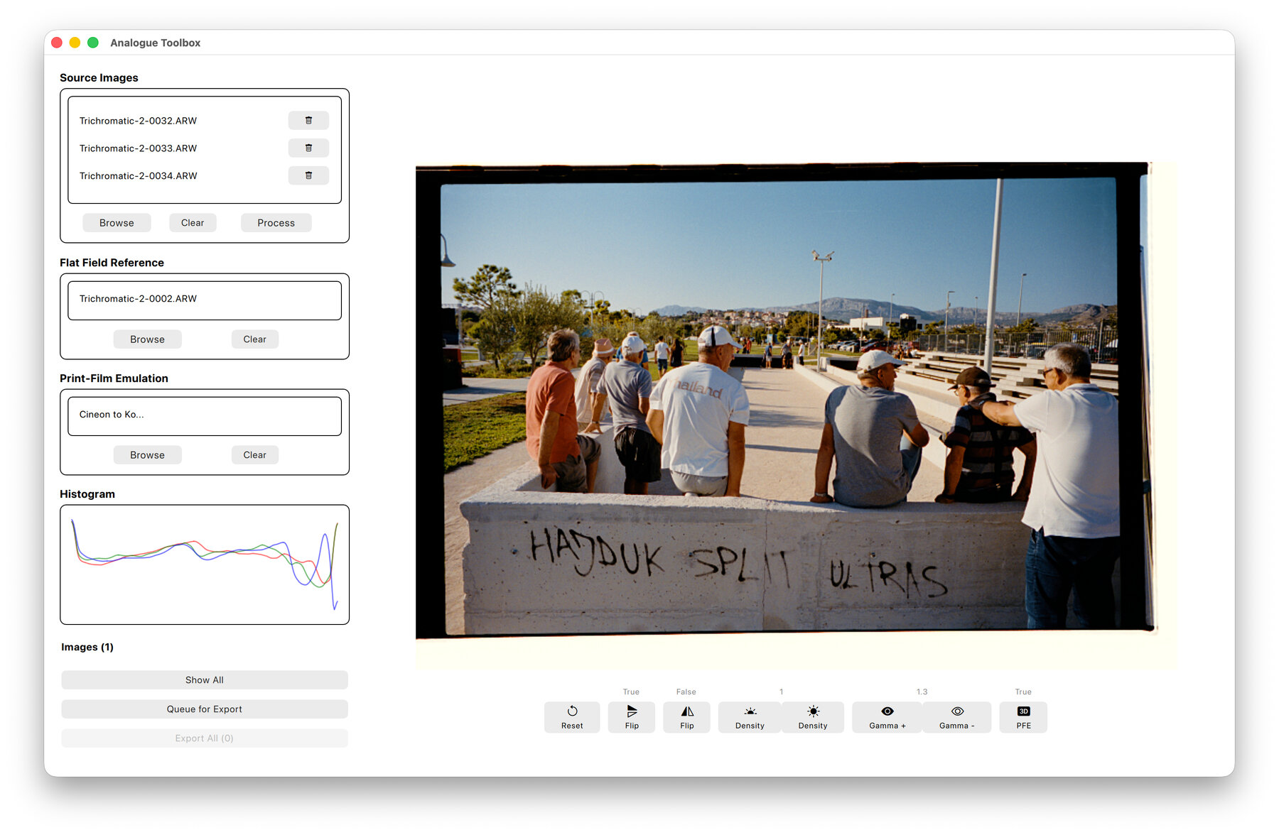

As I have been narrowband composite scanning my color negatives for the last 3 years I now have an application under work that solely focusses on discrete narrowband R,G,B composite scanning. Supports flat-field correction, custom print-film emulation, is fully color managed and supports batch processing. If anyone is interested in testing please let me know. MacOS and Windows versions are available...
As I have been narrowband composite scanning my color negatives for the last 3 years I now have an application under work that solely focusses on discrete narrowband R,G,B composite scanning. Supports flat-field correction, custom print-film emulation, is fully color managed and supports batch processing. If anyone is interested in testing please let me know. MacOS and Windows versions are available...View attachment 421203

As long as RAW conversion and the following selective extract and merge is done properly the resulting composite should already look similar to Log in Rec.709 (sRGB) by default. Only then saturation is implicitly increased alongside contrast through Print Film Emulation and custom S-curves if desired.
So 3-shot discrete narrowband capturing should not end up in fighting against saturation. Actually the opposite would be more to be expected.

@Fish soup : If I got your linked article correctly then he is referring to narrowband but single,"white appearing spectrum" capture with all 3 LED channels on at the same time. I find this approach rather troublesome in regards to getting color right. I have indeed seen wonky oversaturated colors like described with that approach in the past. Discrete, sequential captures under red, green and blue light to me have the better prospect for color predictability. In this case we are treating our camera more like a monochrome densitometer. Similar to how Frontier and ArriScan work. Less variables in the equation benefit color fidelity and consistency.
I've processed discrete R,G,B triplets from many community members throughout the last years with solid results. Not a single time I experienced over-saturation in the resulting composite. Regardless of what camera was used for digitization (and there were many).

As the RAW triplet is now persistently shared I've allowed myself a try:
  1. Composite and conversion via my free "Analogue Toolbox" software specialized for 3-shot narrowband captures of color negatives. Settings: Stock default conversion with consumer PFE selected.
  2. Final touch of slight contrast curve and conversion from (larger) DCI-P3 to sRGB color space for web presentation.
