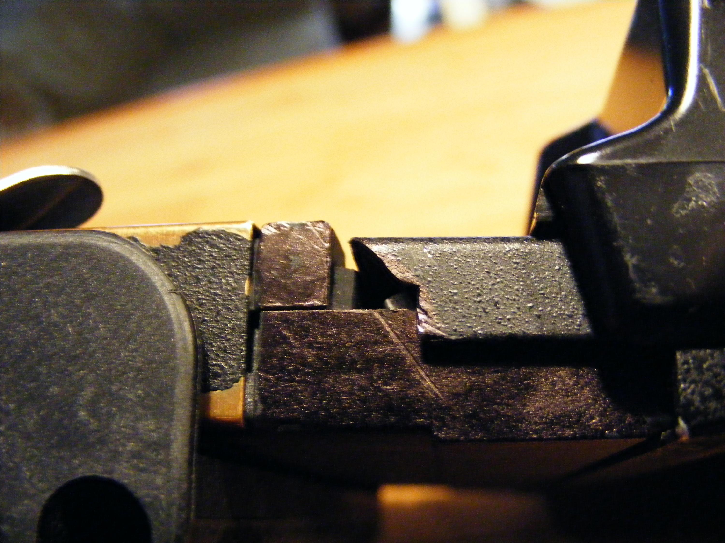

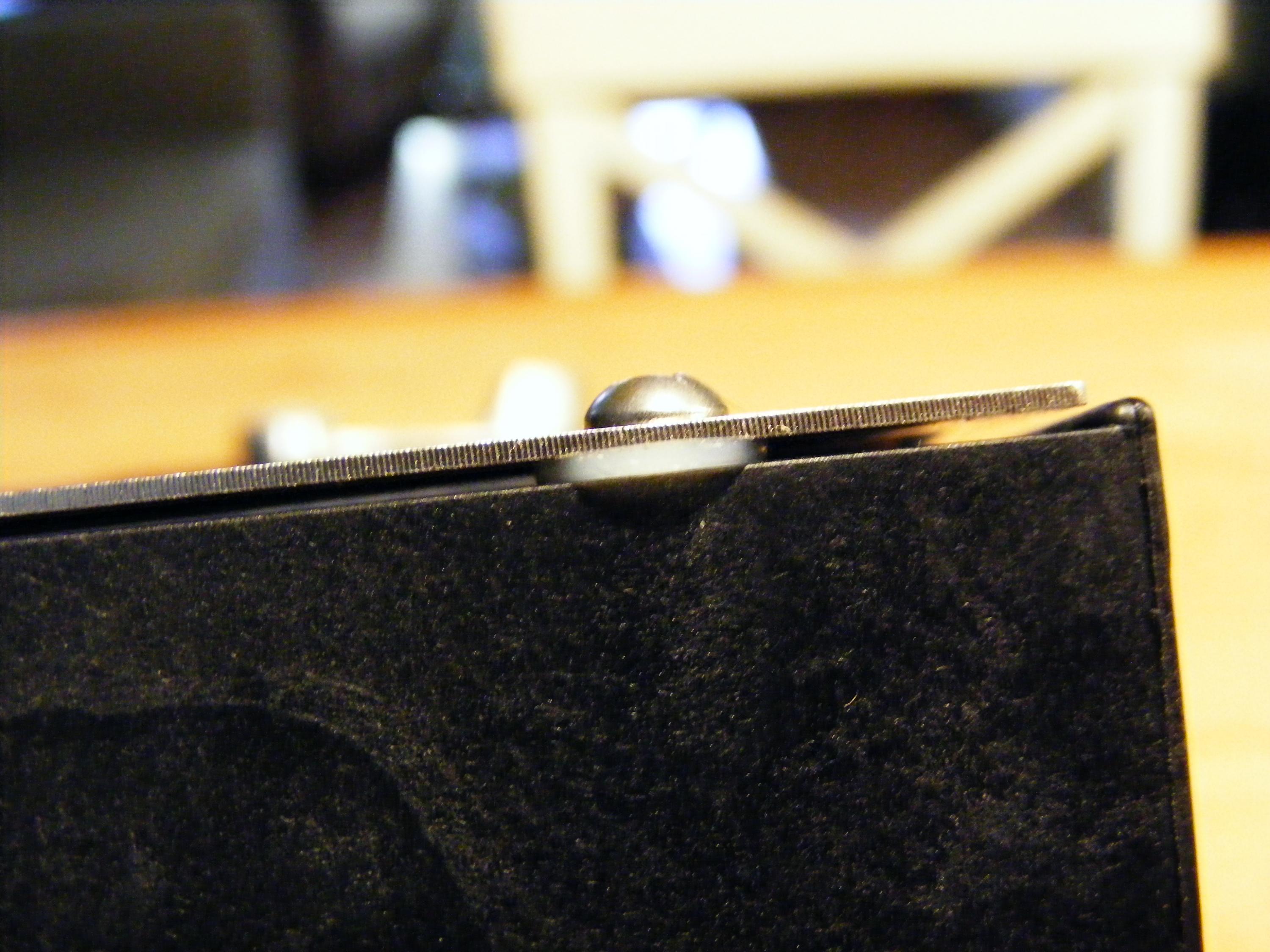

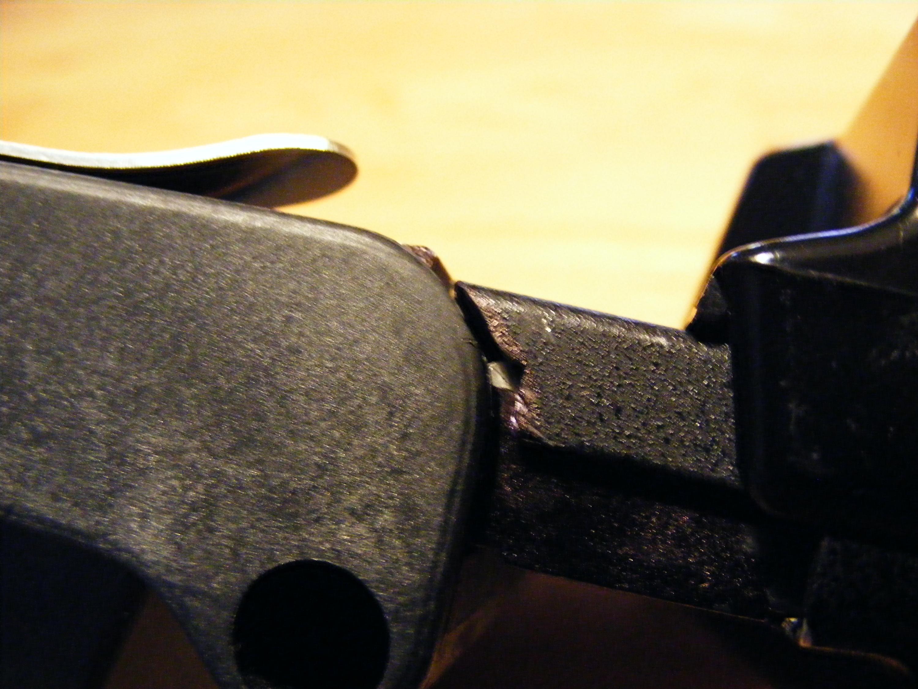

545 back on my new travelwide
I did some minor trimming on my 545 back and added some shims to the travelwide.
The first two images show the area where a small corner was trimmed off the sheet metal cover on the back of the holder, the last shows one of the three shims needed to space the spring out enough for the back to slide in.
I am using a Wollensak 90mm 6.8 wide angle in Rapax shutter for now, I have a Meyer Weitwinkle and an Angulon in reserve but both need CLA's and the Rapax is working. Haven't settled on a rangefinder yet, the Federal Ideal I have is calibrated in feet so I may have to add markings to the helical. Hopefully health issues will resolve themselves enough for me to get out before the snow flies.

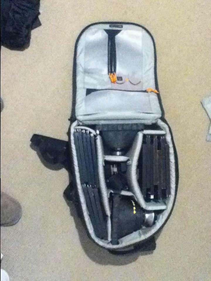

Plus my Kirk SS1 strap, Digisix, and Blik (but didn't use it). 21mm Voigtlander viewfinder on 65mm, included sportsfinder on 90mm (I hope that's around the right way), Orange filter on 90mm (except for colour), centre filter on 65mm.
Firstly, they don't fit too well in my Lowepro 350AW:
attachment.php
I either need to take less holders, or buy a different bag or something. Maybe one of those hipster-satchel shoulderbag things.
Secondly, I burned through all of this in about an hour an a half (on a 2 hour boatride).
Mostly B+W on the 90mm and colour on the 65mm, sunny-16 minus 1.6 stops for filters and I was at 1/30s f/16 most of the time.
Not exactly the speed I go through 35mm on my EOS 3 or Bessas, but 30 shots in 90 mins is faster than I normally do MF.
There is absolutely no way I'd have taken any other LF camera (that I own, maybe those with presscams might disagree) on a moving boat and handheld.
So comparing these to MF, I'd probably take these on any future landscapish expeditions too, but I'll have to crack open my RVP quickloads to keep the weight and volume down.
Now all I gotta do is process all the damn things...
