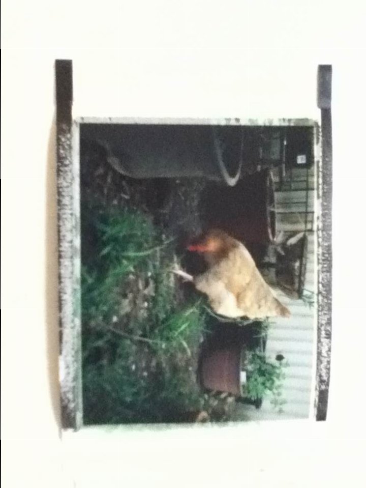

That said, it still works fine, here's a Fujiroid of my chicken, guessed scale focus around 1.5m, 1/30s, f/8:
attachment.php

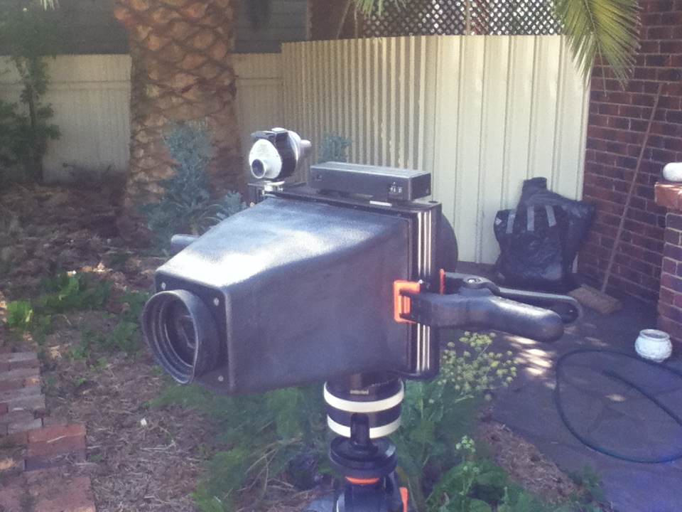

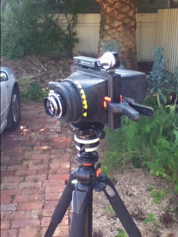

Calibrating the scale for my 105mm f/3.5 Xenar, using my Toyo viewfinder hood (seriously, everyone should get one of these or you really can't see the focussing screen):
attachment.php
attachment.php
(sorry for the crappy ipood pics).
The scale at 105mm is necessarily different to the injection-moulded 90mm scale, hence the yellow stickers. There's a fair bit of leeway on the focussing screen, maybe 10cm where I can't tell exactly where focus is. It's also calibrated to the numbers on my Blik, which may or may not have any correlation to a tape measure.
Also, I put markings on my ground-plastic to show an FP100/3000 framesize, and on my zoomfinder it's almost exactly a 35mm frame.
Once I figure out how to get the last few shots of FP100 out of my polaroid back, and swap it with however many shots of FP3000B are in my M645AF polaroid back, I'm taking this thing to a poetry gig tonight to see how well it works as a point'n'shoot Fujiroid camera.

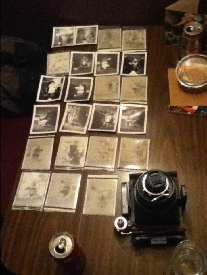

Things learned tonight:
a) Yes, you can get rather good shots with a wide-open 105mm f/3.5 Xenar on FP3000B at 1/25s in a dimly lit pub.
b) Travelwide makes a really good point'n'shoot with said Xenar.
c) Damn, expired FP3000B goes ultra-low contrast, but the blacks in the next pack (from 2013-09) were a lot better.
d) I'm going to be even more upset when I'm out of FP3000B, only 4 packs left.
e) you get really really weird looks when you spread them all out to dry on the table in the pub...
attachment.php
Now all I gotta do is figure out how to get enlargable negs out of them. I left my favourite shot of Brian the bartender up on the wall of the Coffee Pot (if any Adelaideans want to go see my handiwork or get cheap beers), but I'd like to enlarge it if I can...
