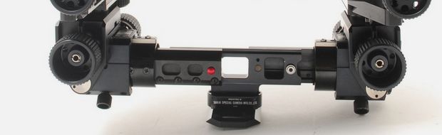

I don't have the VX125, but I have its baby brother, the VX23D. It is a beautiful piece of engineering. Its starts as a kind of Sinar clone system--cylindrical rail, ungeared carriers that slide and clamp on the rail, then geared fine focus on each carrier. Then they modified that to make a collapsible rail that is very light and exapnds from something like 5 inches to almost 12 inches (rail expands, add 1 inch endcaps, slide the carriers to the end and use the fine focus to move the carrier as far apart as possible.) You can add larger rails to get much more distance, but that gets you most of what you might need.

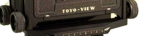

If one side of the standard has the double knob, then the rise is geared. If both sides have a single knob, it doesn't have geared rise:

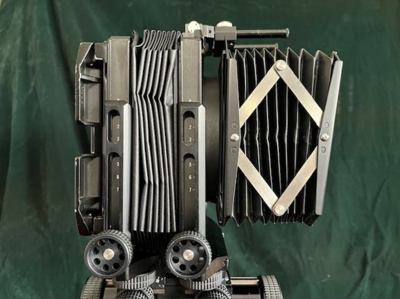

The collapsible rail should be easy to check out. It should open wide like this:

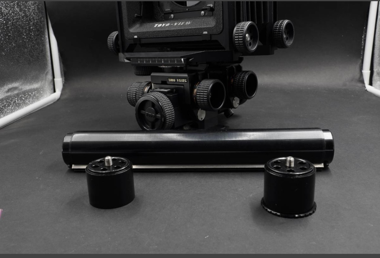

One other thing to note--there are inch long rail extensions for each end. They look like this when removed:
I think they only came with the collapsible rail. The chart above says max extension is 327mm, but that seems high. I thought it was closer to 280mm with these two little extensions. (you could get larger extensions as well.) Anyway, with the collapsible rail, if it doesn't have those extensions, you'll effectively lose 50mm max, and they seem to be unobtanium by themselves (there are three VX125 s on eBay at the moment--one doesn't have a collapsible rail, one has it with extensions, and one has it without extensions.)
