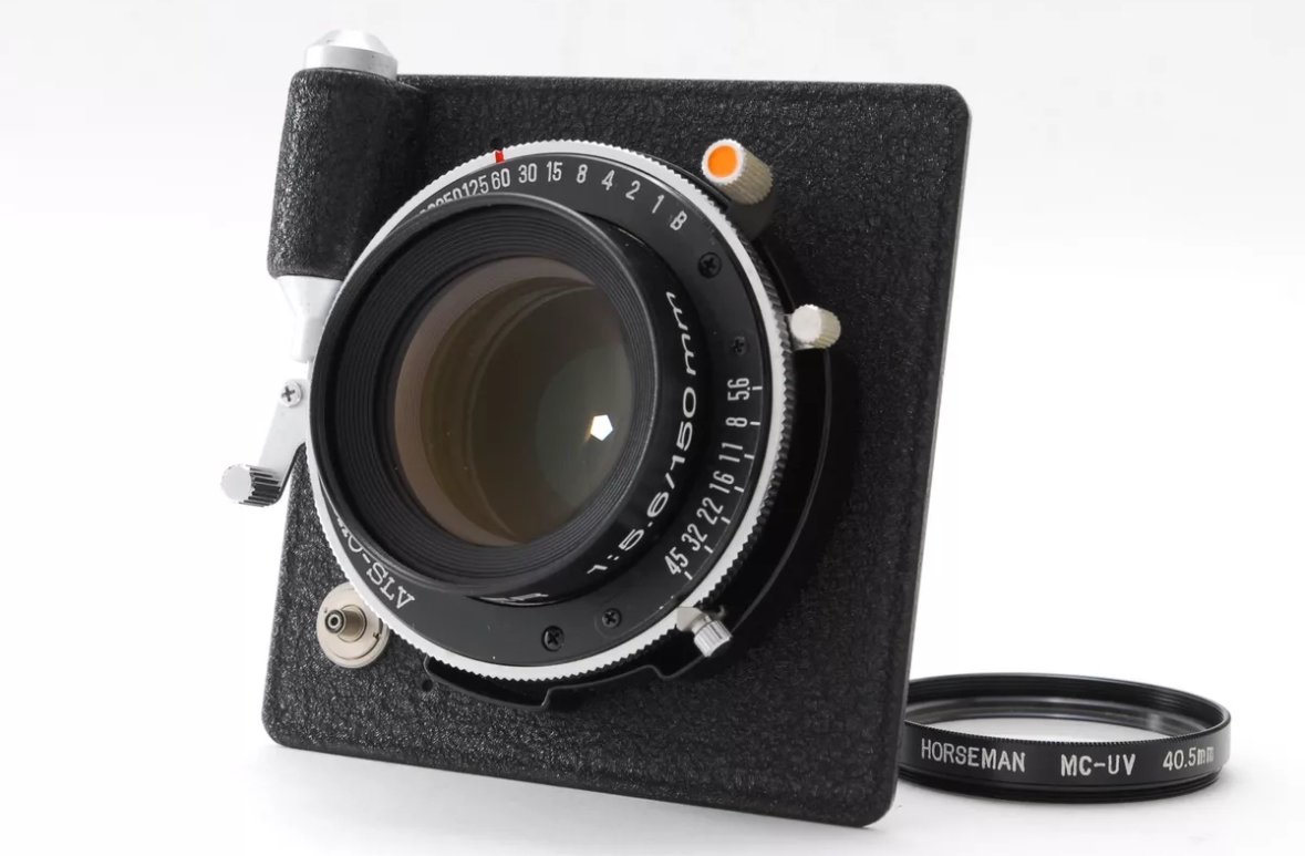

With regards to the 150mm f5.6, I’ve seen a couple different version of this lens with one looking like it’s for a 4x5 specifically. Of course that one is larger, so does that mean there’s more latitude with movements when using it on a VH (6x9)? Here are the two lenses I’m referring to.

IMG7142 is the re-designed 105mm f5.6 that replaced the original 105mm f5.6 and the 105mm f3.5. This new lens uses a 43mm filter instead of a dual thread of 52mm and 62mm. It was set-up for the Horseman ER camera that had built in electric release. It should take a standard 3mm cable release. At least my other ER lenses do. The other one was for the 45 series of Horseman cameras 4x5 IIRC.
Those on the images are 150s.

My bad. 741 is the 150 for the 4x5 Horseman cameras, like the FA and it is a plasmat (IIRC) type lens and will work on a vh. The other one is a 150 for the ER camera, a 4/3 tessar type. Both of my ER lenses no longer have the image circle on the trim ring. If you are trying to stay compact both the 65mm and 150mm tessar type use 40.5mm filters.

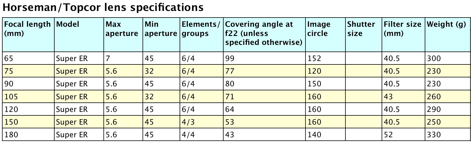

Hi I’ve attached some specs that I gleaned from various sources. Be aware of changes that occurred over time;
* older lenses have writing inside the barrel (around the front element), whereas newer lenses have the writing on the outside)
* the name changed from Topcor, or super Topcor, and then to horseman super er.
* the older lenses/lensboards have a non-standard cable release socket, whereas the horseman super ers have a standard socket (at the top of a pellet-shaped solenoid).
* earlier lenses can be single-coated, whereas the super er variants are multi coated.
* coverage is generally limited to the horseman cameras, with its movements. So, not many will cover 4x5. However, if you can find an empty lens board (rare?) you can use other lenses. I use a Caltar 210mm f6.3 lens (which covers 4x5) with no problems.
Hope this helps. And enjoy using your Horseman, Andrew

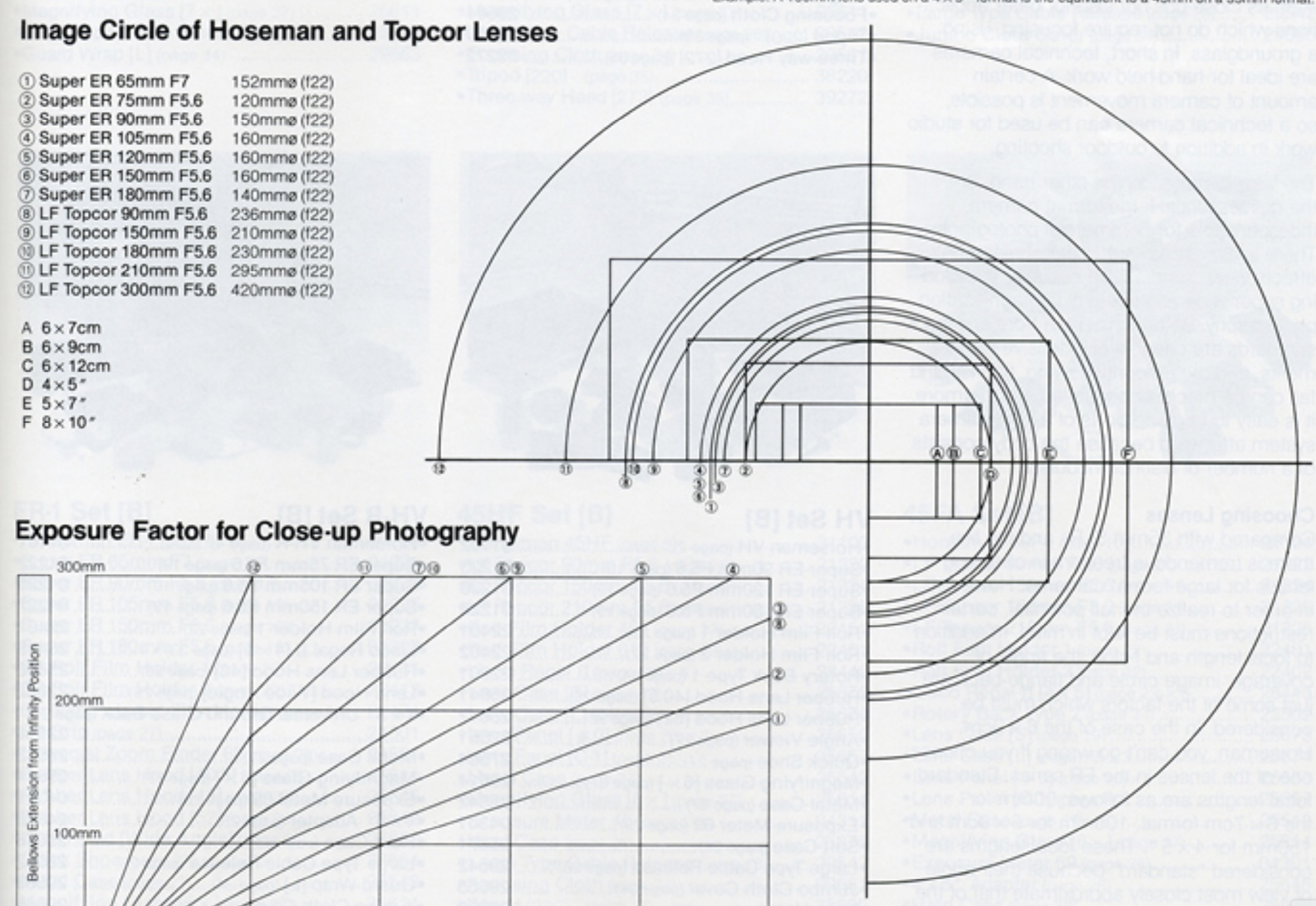

There is no one answer to the question. For example front rise and down tilt on the Horseman could exceed the coverage of many lenses. (See page 43.)
So, if one only looks at front rise and shift, the VH has 30mm shift from center each way and 28mm rise.
One can do some complex math, or just look at these circles to estimate. (page 39 of the 1988 Horseman catalog available on the internet).
Thanks for this - useful!
