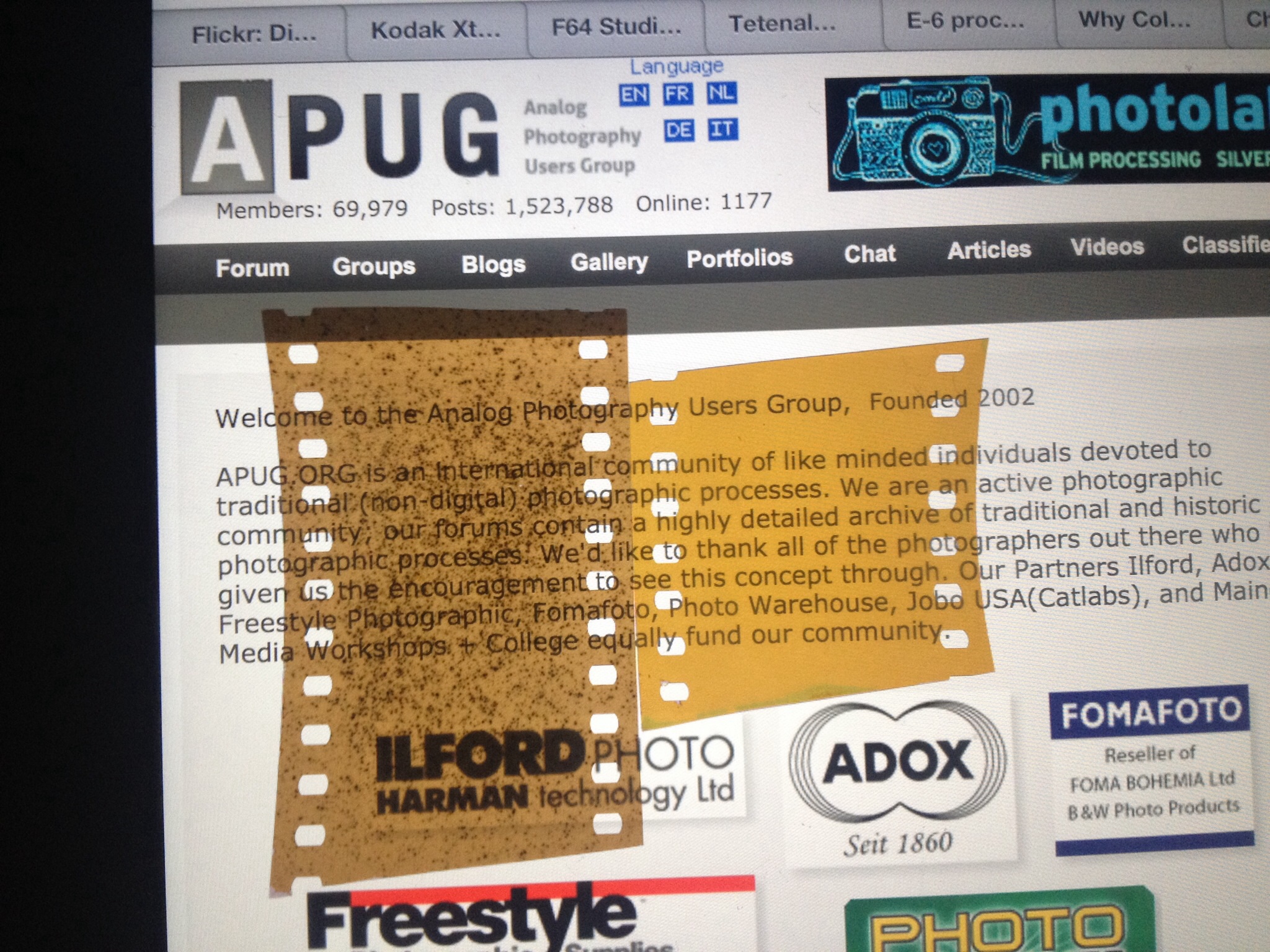

First photo : fuji f250d in BW developer Fomadon W27 near a only fixer patch
Second : right side just fixerr , left side is a piece of film that I hold in multivitamin and Ibuprofen . Don't laugh please. Some silver spot formed
Third : unexposed film full processed in fomadon lqr and fomadon W27

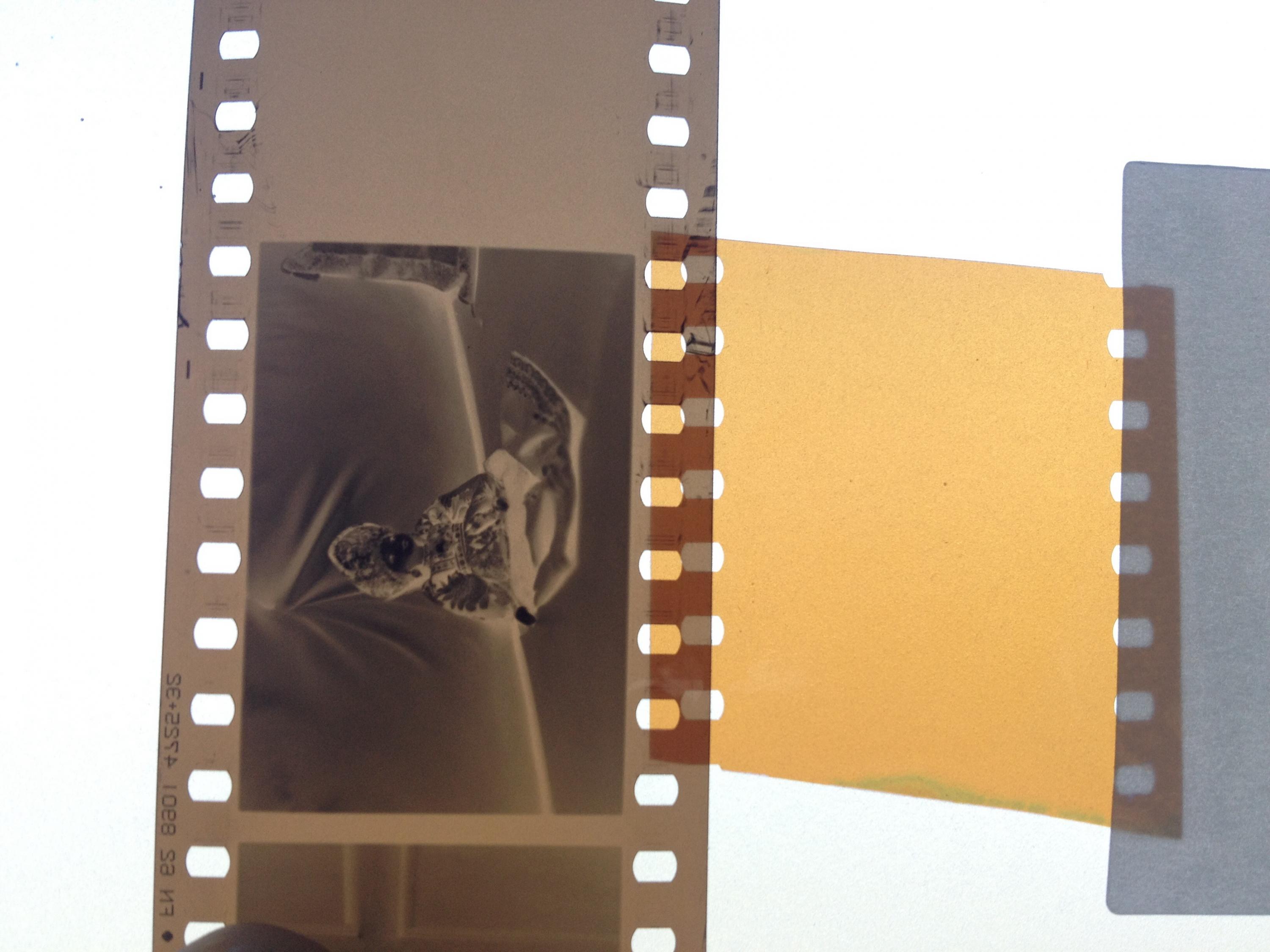

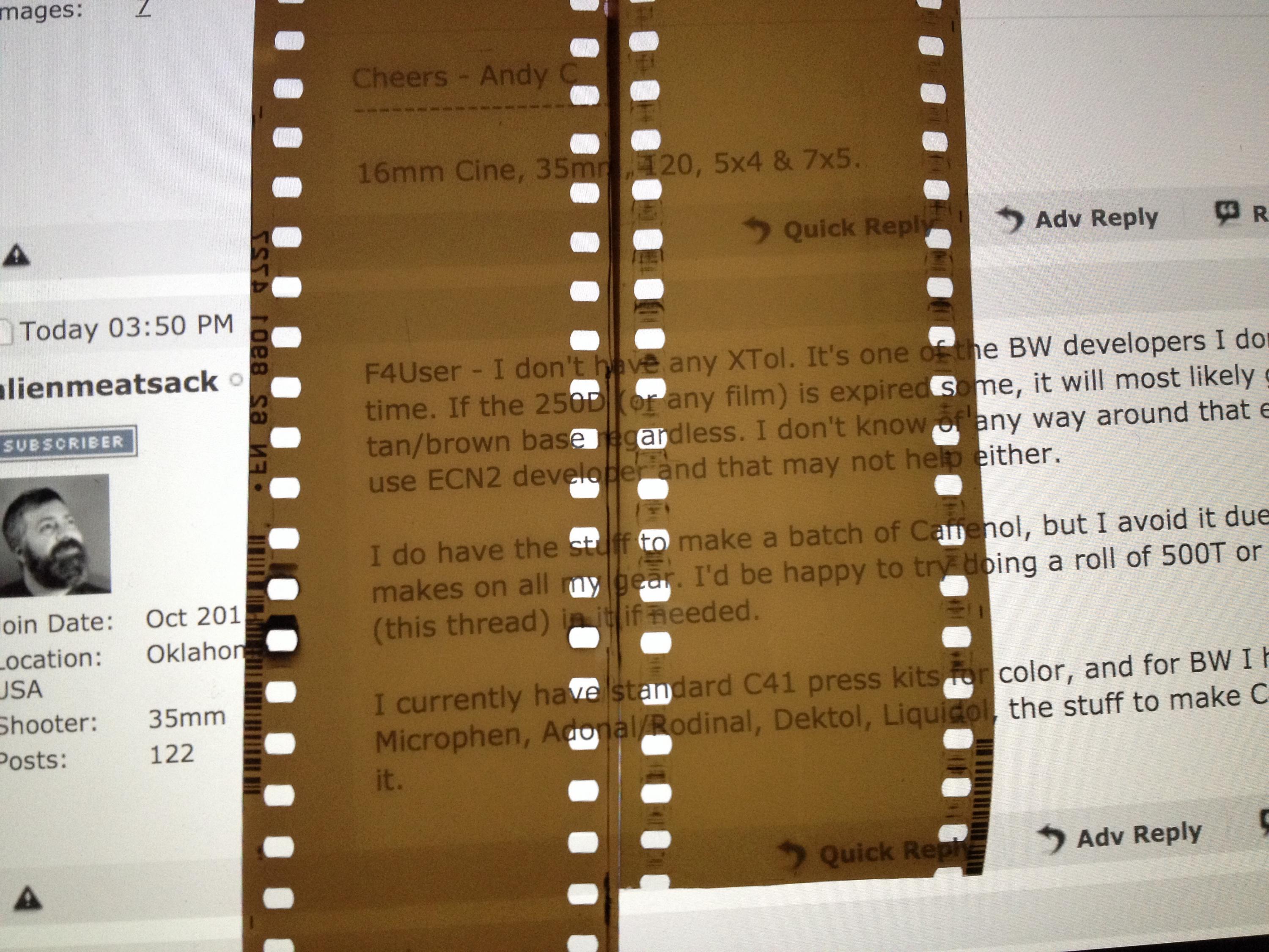

I want remove the film's yellow filter and dye mask and keep only silver image.
F4user - I like the spots on the middle shot left piece of film. Very "lomo" and a look I'd replicate myself for some films occasionally. What did you do to get that to happen?
It looks like the film has a very similar brown/yellow base tone to the Kodak 250D I have. I have no idea how to get rid of that or reduce it's effect in any kind of developer or chemicals, color or B/W. But if there's a way to reduce it's effect even a little, it means less work for the scanner to penetrate the film, thus less grain.
Perhaps if you reduce the temperature of your developer and do more of a semi-stand development, that might reduce some of the base fogging? I've already read that Adonal/Rodinal are good at dealing with fog and that you can add a little Borax into the developer to reduce the fog a bit more. I've not tried this. I wonder if the borax would also work in C41 developer to help cut the base's coloring back a bit...
There's also Edwal Orthazite anti-fog for BW developing which might help. I believe you have to compensate when shooting or when developing for the speed difference it makes. I've not used it so I can't speak from experience.
