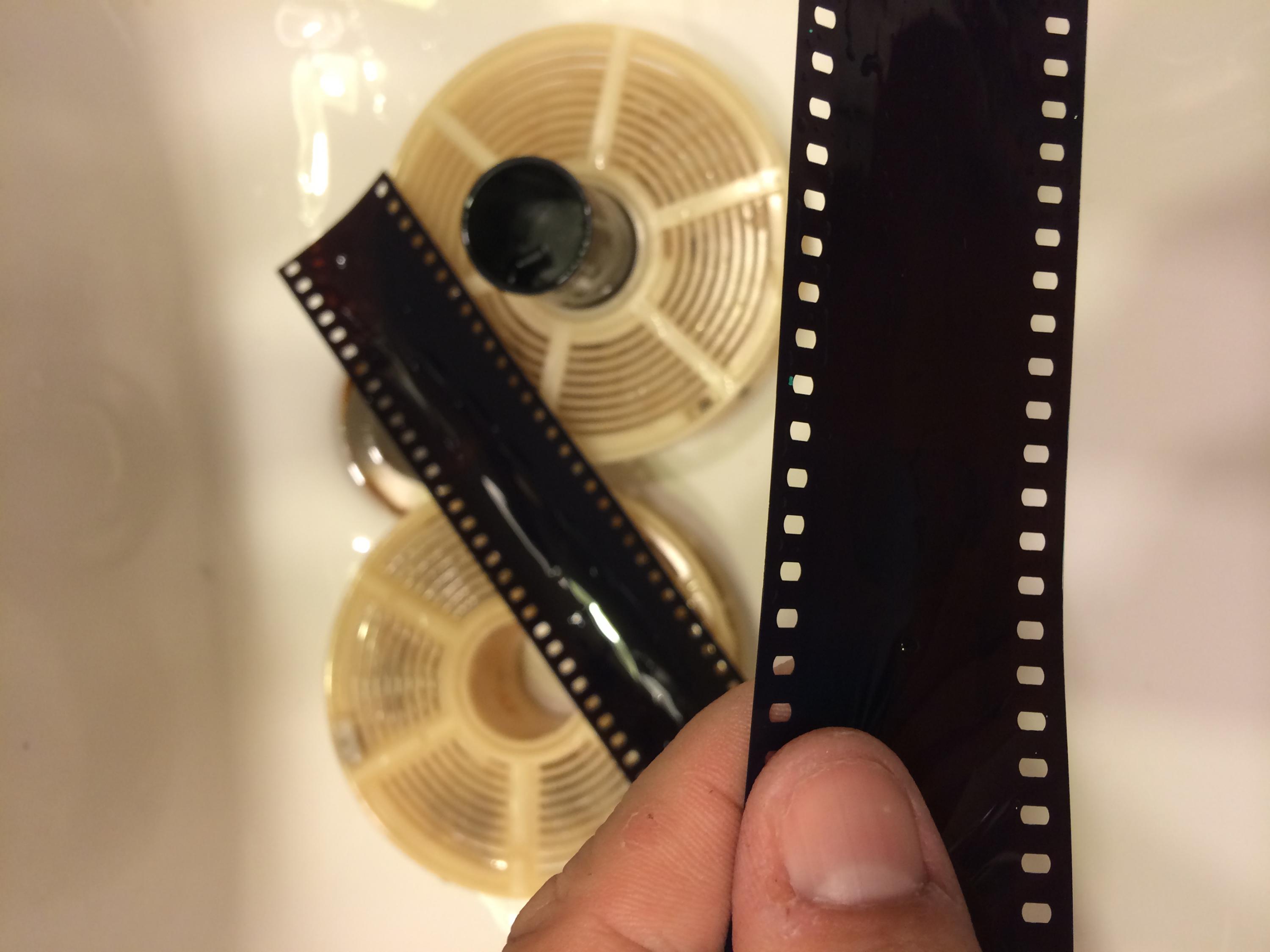

My negs are currently pretty much indistinguishable from the raw film, except I can barely discern images. Posted here, the negs would look completely black. I'll try removing much more remjet later today. I think the film needs a longer hot alkaline soak, and some elbow grease.
Dec 2, 2011
693
Memphis, TN

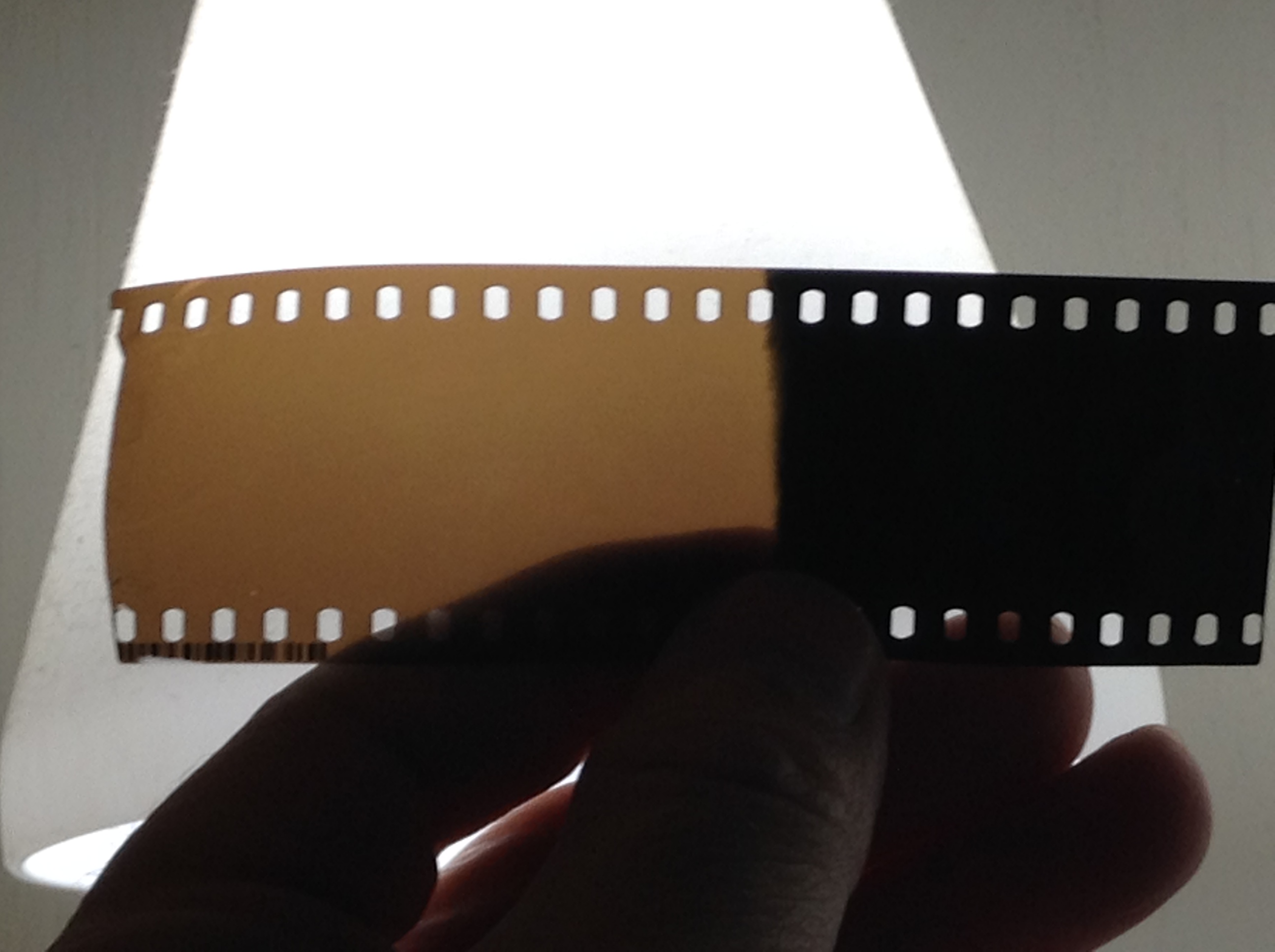

Update:
Here's a quick bathroom shot of the Vision 500T negs, just so you can see how impenetrable they are. Just above the sink are four incandescent bulbs. I just soaked the negs again in warm baking soda water, about 1 TBSP for a two-reel tank, then tried to remove the remjet after heavily shaking for about a minute. The rinse is clear and the remaining remjet doesn't budge. The remjet side is bluish-black, and the emulsion side is a light pea green. I've stabilized them now and hung them up to dry to see if there's any change in scanning ability.
I'm motivated to clip a few inches each off the other two cans I have (different emulsions), just to try to remove the remjet from them to see if they're equally stubborn.

Terry, those are indeed quite dark. The remjet should be obvious if it is still on there, it's a little more flat/chalky feeling then the exposed base is.
You might have to cut off a short strip, kept in the dark, developed in BW and then fixed to get a clear base w no image, then do the remjet removal to see if any comes off. If it does and you end up with a short clear strip with only the Kodak encoding on the edges, then you know that something went wrong in your "black" strip you did before. If not, then it's possible the film is fogged... It's also possible that the film is just bad on the outer frames and if you remove say 3-5', the rest is ok.
I've used a few different cinema films and I've never had any that the remjet didn't come off easily. Usually if your rinse after the baking soda + 100f water goes dark grey/black and then clears up only leaving film base tint rinsing out, then what you have in your hand is just the film.
I've not cracked open my 500T roll yet to test it, I've only done the 250D which has been good thus far. I may try opening the 500T and cutting off a leader pece and trying the above test on it to see what I get so we can help nail down the issue.

Okay, I hate to say it, because it defies logic, but I'm starting to think the film I have is fogged, or at least the end pieces that I've tested. And I really hate to post this here, because I don't want to malign mweintraub's cinema film sale, but others have been posting their results here and the cinema film processing thread elsewhere seems to have ground to a halt. But anyway...
This afternoon, after reading alienmeatsack's replies, I loaded unexposed lengths of EXR100T and Vision 200T into a Paterson tank, and soaked them in a borax solution to dissolve as much remjet as I could. The water was charcoal-grey. I then developed them for five minutes. I had the dregs of some DD-X to use up, so I added a bit of HC-110 concentrate to it, just to ensure I'd have plenty of developing action. After fixing, I wiped the film with a wet sponge and got off more remjet. However, even after all this, the film was still rather charcoal-grey (not absolute black like my previous attempts), so I did one more borax bath just for good measure. At the end of it all, the 200T was just as opaque as ever, and I could actually see my fingers through the EXR100T, even though it was still mostly dark. I know developing happened, because I could see faint surge marks around the sprocket holes if I held the film up to a bright light.
I'm at a loss as to what to do next, short of asking to send the film back. It seems highly unlikely that all three of my rolls would be fogged, but I can't think of a single thing I could be doing wrong in processing this.

It sounds to me like you got fucked up film. Maybe exposed before putting back into the can. That's a risk we take buying this stuff. I am fully ready for any of the 3 reels I am buying to be bad. That's part of the risk of buying this stuff. I hope mine is good, but am ready for it to be bad.

FWIW, I did a strip test with my Vision2 500T purchased from here and got pretty much normal results. I just clipped a chunk of leader that had partly been exposed and partly not, did a quick run through some Dektol at 1+3 for 3 or so minutes and fixed it. The base is a bit tan/brown but that is partly due to the BW method I used to develop it and partly due to age and partly from not rinsing like normal but it seems to otherwise work ok.
It is entirely possible you did get a bad one that had been exposed when puting back into the can or similar. That sadly is part of the downfalls of film like this. And like (there was a url link here which no longer exists) said is one of the risks of buying this stuff at such a low price. IMHO if you get any other rolls and even 1 is good it's still cheaper then anything I've ever seen for any bulk films. With that said, if you thin it truely is bad, give the OP a shout. He's a really nice guy and I'd bet he will do his best to work out the deal with you.
