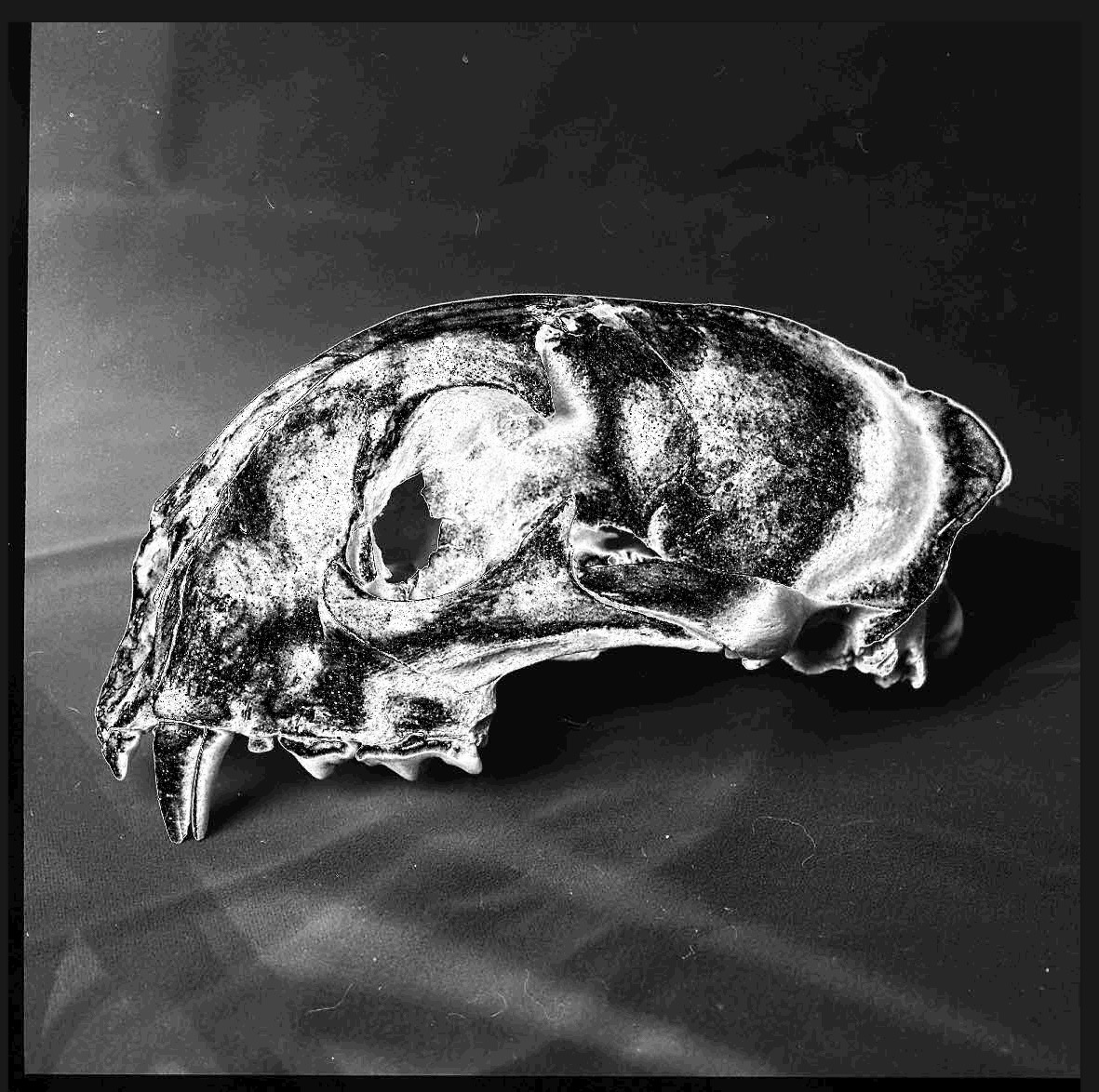

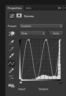

In PhotoShop, you can apply a curves adjustment layer that makes dust stand out quite easily. Then, using the healing brush tool you can clean up dust and retain grain. Less time-consuming than breaking out the spotting ink, brush, water and loupe and a strong light. And you can undo it unlike traditional spotting.
View attachment 238132 View attachment 238133

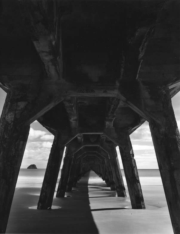

The image below took four hours to spot -- the only time I have gone to such length. But I love the image and the exposed film was damaged by high-humidity static from bouncing around in a film box on my bicycle for several months. The worse was on the sand -- thankfully.
And what a lovely print it has become.
Well worth the time spent spotting I can imagine.
Thx for sharing.
