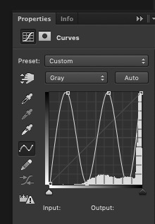

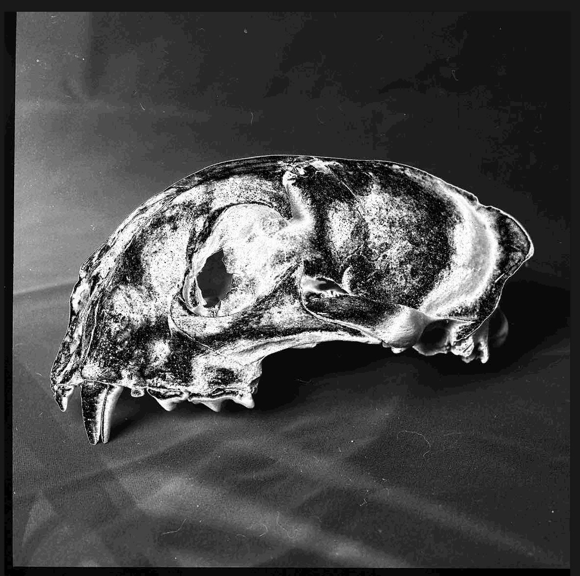

In PhotoShop, you can apply a curves adjustment layer that makes dust stand out quite easily. Then, using the healing brush tool you can clean up dust and retain grain. Less time-consuming than breaking out the spotting ink, brush, water and loupe and a strong light. And you can undo it unlike traditional spotting.

Obviously, PhotoShop has nothing to do with making prints in a darkroom. However, depending on the amount if dust on the negative and the spotting necessary, I would prefer a clean, dry print to a spotty, wet one.
