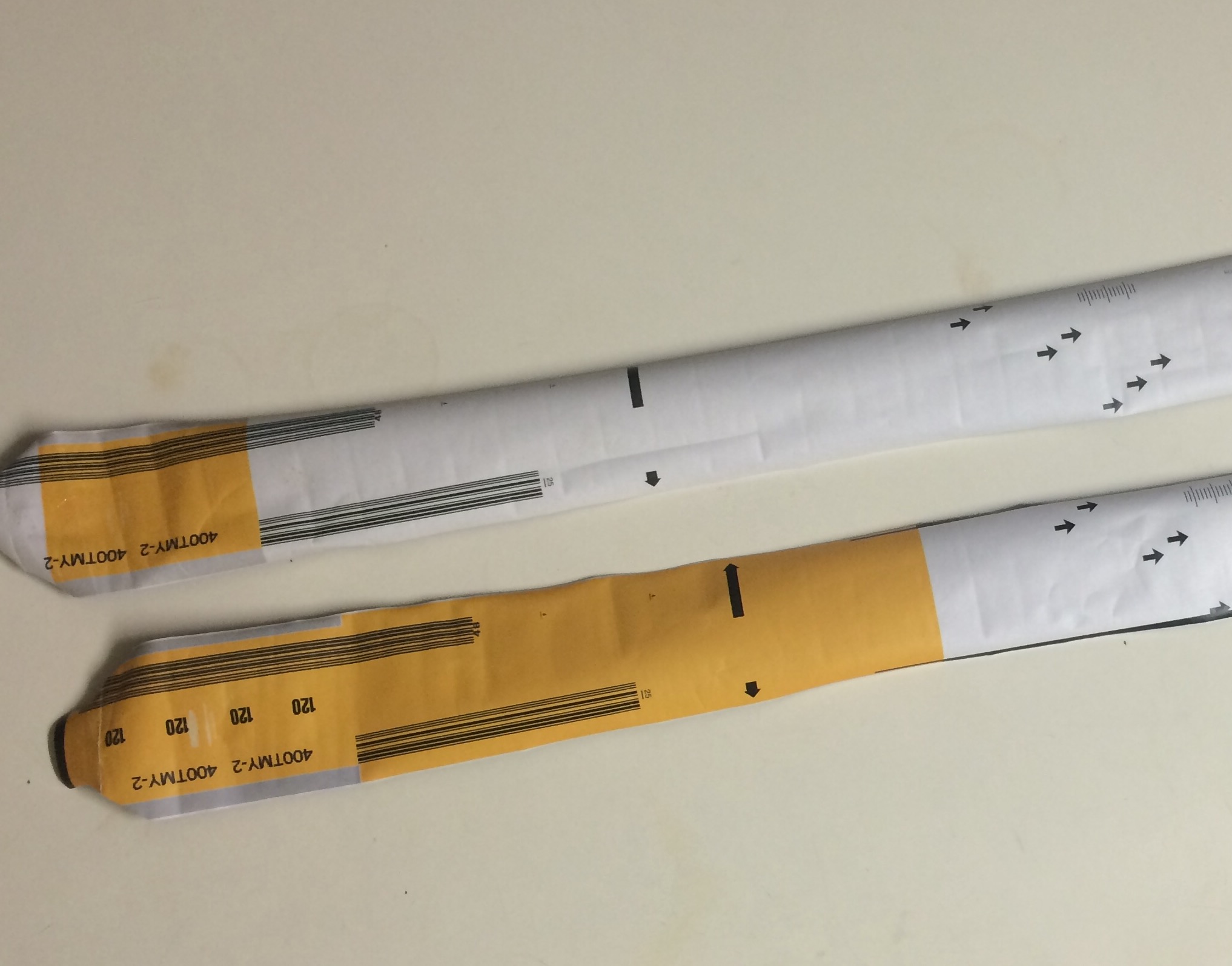

It has a start arrow and some other heiroglyphics, however it goes blank when the film starts. I haven't looked at the whole paper, however another guy told me it is white all the way thru. I'll post a photo when I finish the roll.

Apologies guys, I checked the paper again and there *are* marks there. They are just much fainter and there are less of them. They're hard to see in the faint red light I was looking under.
I was originally assuming the reports of blank paper I heard were accurate, so wasn't looking carefully enough.
Sorry for the confusion.

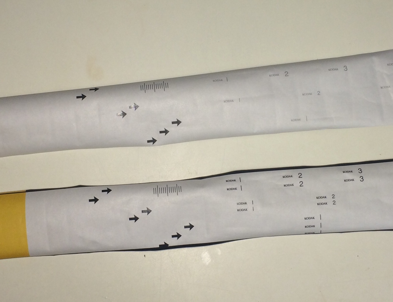

Don't tell my wife - it looks like I may have been right!
New backing paper (top)
Old backing paper (bottom)
Tom,
I can see why you thought there were no numbers. They are much, much lighter and harder to see. I really found it hard to believe that Kodak would do away with the numbers completely, but stranger things have happened in that company. I won't be able to use this film in my Zeiss folders as their red windows aren't the clearest. It will be fine in my Hassy 12 backs along with my Kodak Medalist I/II and Monitor 620. Well, still have to wait and see if there are any problems with this change or not. Darker numbers - lighter numbers? Is it different ink/dye or just lighter???? Good to know Kodak at least is concerned.
A definite improvement which should get rid of the problem.
I note that there are fewer numbers - where the old paper had stacks of 3 of each, the newer paper has a single number.
I wonder how many people will be inconvenienced by that.
It will probably make it harder to re-purpose 120 for other sizes like 616, etc.
I was noticing the same thing but haven't finished doing my homework. The standard shows a total of 7 tracks of numbers, but does not indicate which track serves which format... or at least I haven't spent enough time reading it to find that information.
EDIT: Ahhh, "4.2.2 Orientation of Exposure Numbers — The orientation of the exposure
numbers shall be at the option of the manufacturer." But still not seeing identification of which track is which format. Maybe a bit more time spent with the diagram will help... but no time fo rhtat at the moment.
EDIT2:
Track 1 and 2 = 16 exposure
Track 3 and 4 = 12 exposure
Track 5, 6, 7 = 8 exposure
Less numbers, but same spacing. Stacking numbers might have been for different manufactures cameras and their vertical placement of the red windows.
I'm just hoping that my red-window camera does not use the numbering track that was omitted!
And what's interesting that they didn't remove the "track arrow" for the tracks that were deleted. So one might see a track arrow but never see any numbers. Ouch, what a surprise that might be!
I use a Kodak Duo645. But also in the process of adapting Kodak B-3 from 122 to 120.
I find it hard to believe Kodak would do away with it's own vertical number alignment meant for their older cameras. That means your Kodak duo645(Kodak Duo Six-20) should be fine. I would think the Kodak No.3A(B-3) should be fine also, but figuring frame length might be a little harder. I'm just worried about the visibility of the numbers in dim light. Probably going to have to start pocketing a penlight just to advance the film when light fades.
