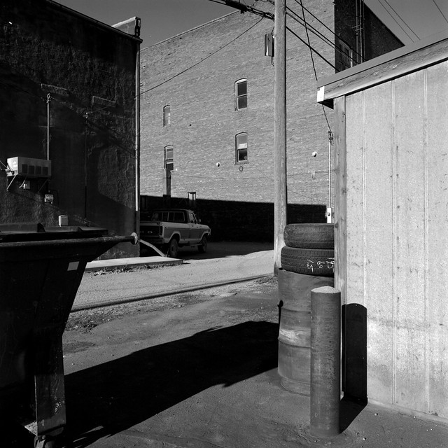

It looks like your negative is underexposed, for my taste. I don't like featureless areas of black.
Why not shoot another test roll and vary the ISO per frame from 200 to 800 (+/-1 stop) on a lot of scenes. Make your steps in 1/3 or 1/2 stop increments. Then try printing/scanning the series. You will quickly know which speed gives you the shadow detail you prefer. I usually use an incident meter for these types of tests, and then record how the camera meter (or my handheld spot) differs. You can learn a lot with a single roll of film. If your development is significantly off your film speed results will be as well.
The way I shoot I consistently find my film needs 1/2 to 1 stop more exposure, such as ISO 64 for FP4+ and ISO 250 for TMY.

Testing doesn't need to be truly formal either, adjust your meter to a different EI for a roll, did the printed result improve? Adjust the other way for a roll, did the printed result improve? Look at the results and refine as you go.

So if I am understanding, I could give more exposure on my negative, develop for a similar contrast (shorter dev time), and extend my print times. By doing this I would get less grain?
No. All other things equal, if you expose your film more, the negative will be denser. Density is built up by silver grains, so that situation would yield more grain.
There is some compromise that has to be made with all kinds of photography, film photography is not exempt. You expose and develop your film to get the kind of tonality you want in your finished results. Then you basically live with the amount of grain you get from that film and developer combination. If you don't have the tonality to present the print in a beautiful way, the finest grain in the world isn't going to make it better (if you like fine grain).
That's just kind of the nature of it. Know this, though, with TMax 100/400 in Xtol, you are getting some of the finest grain achievable. Whatever grain you get is what you have to live with.
If you want to get as little grain as possible, you should expose the film as little as you can, and develop it the very least you can. Questionable tonality may result, because you get little to no latitude with exposure errors, because you're already at the limit. But that's the basic gist of it.
