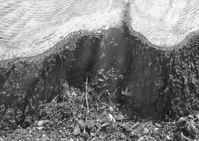

Bromide drag in stand development is dependent on the image. This is 120 Acros 100 in R09 1+100 stand development for 1 hour.
Shadow areas adjacent to highlights, oriented with some respect to gravity, were effected in this instance.
