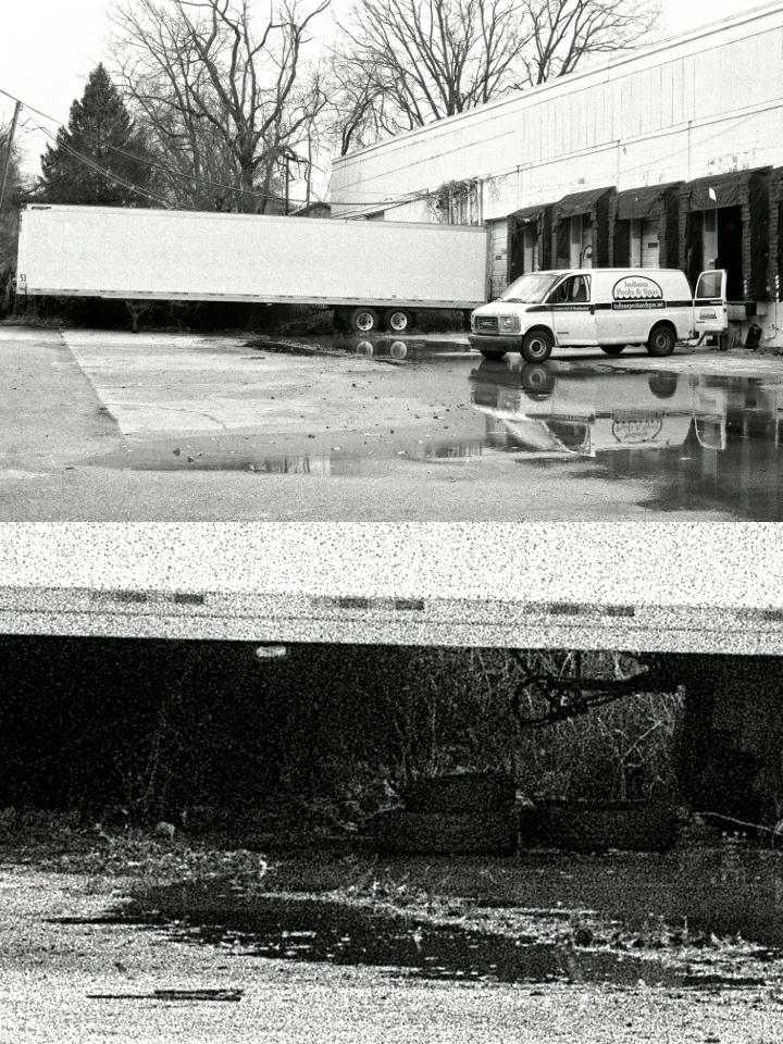

Coincidently, I just processed a roll of Tmax3200 shot at ISO 1600 with HC110 1:31 for 9.25 minutes at 68 degrees. The grain is prominent, but I wouldn't say not horrible. The question is, would it be better to shoot Tmax400 pushed to 1600?

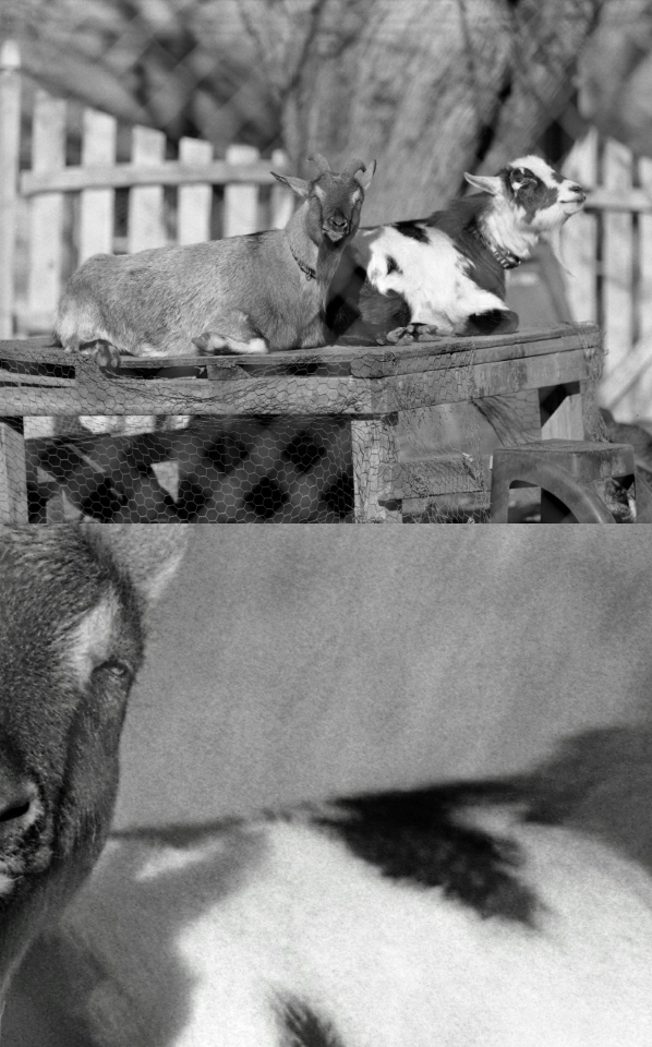

I ended up shooting it at 800 and using HC-110 dilution B, 8.5 minutes @ 68 degrees. It looks pretty good, I wouldn’t say the grain is any more prominent than with Tri-X. I don’t think it’s something I’m going to run out and buy. But if I ever needed anything faster than Tri-X is a viable option. I don’t mess with pushing or pulling and always shot box speed. I also mainly shoot ISO 100 films in daylight. So this really isn’t my thing.
For reference: 120 Delta 3200 w/ yellow filter (so metered @ 1600)
HC-110 1+31 (Dil. B) for 14:30 (I used the published times for Ilfotec HC)
YMMV

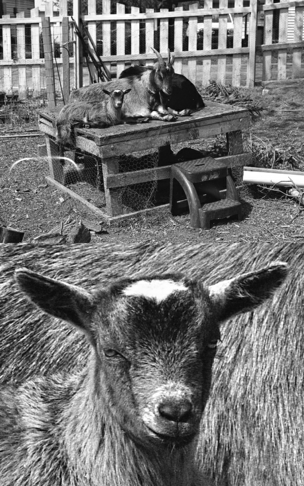

Edit: And just because I'm scanning...
120 Tmax400 @ 400 no filter
Homebrew Rodinal 1+50 14:00
YMMV
